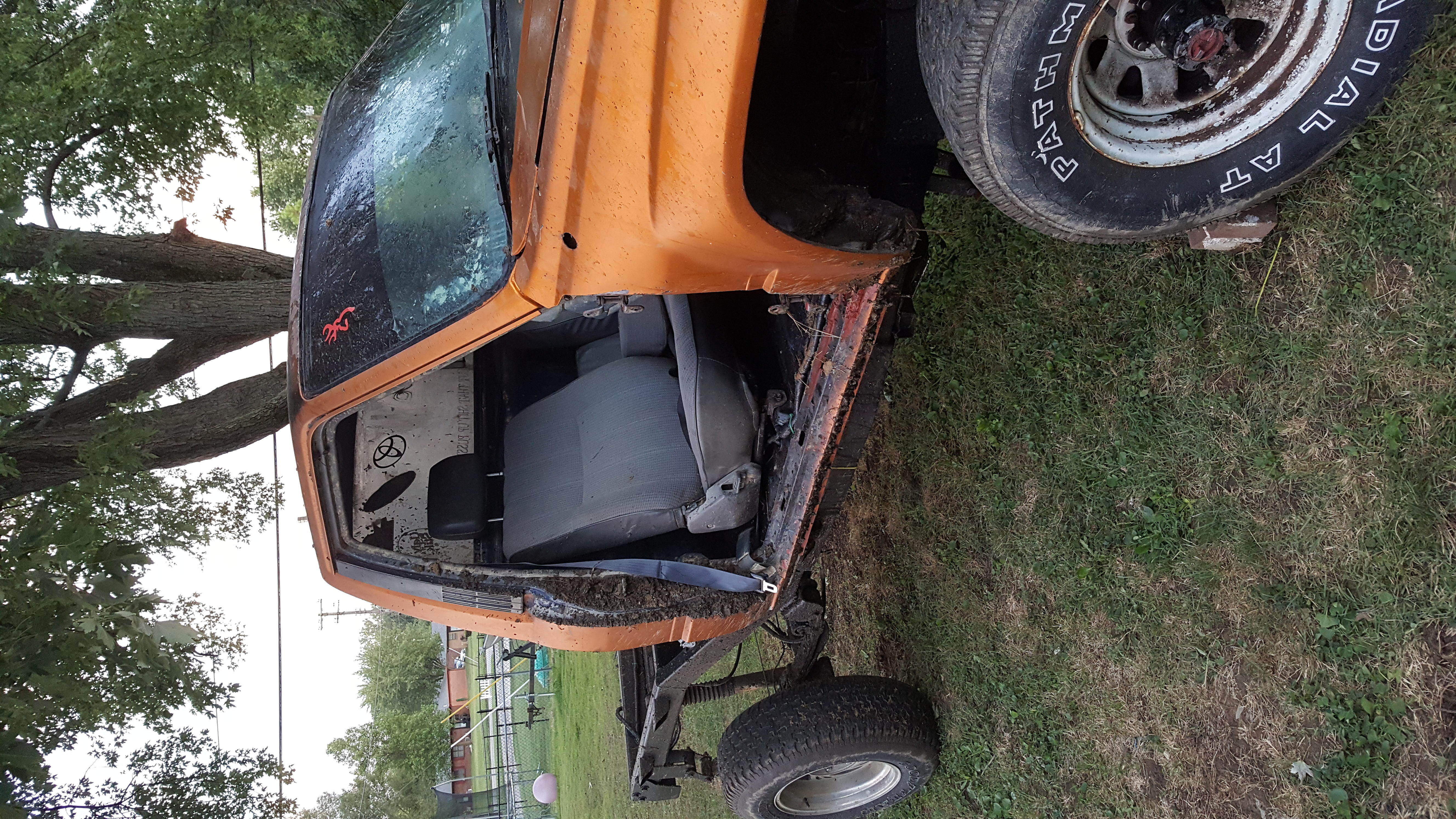

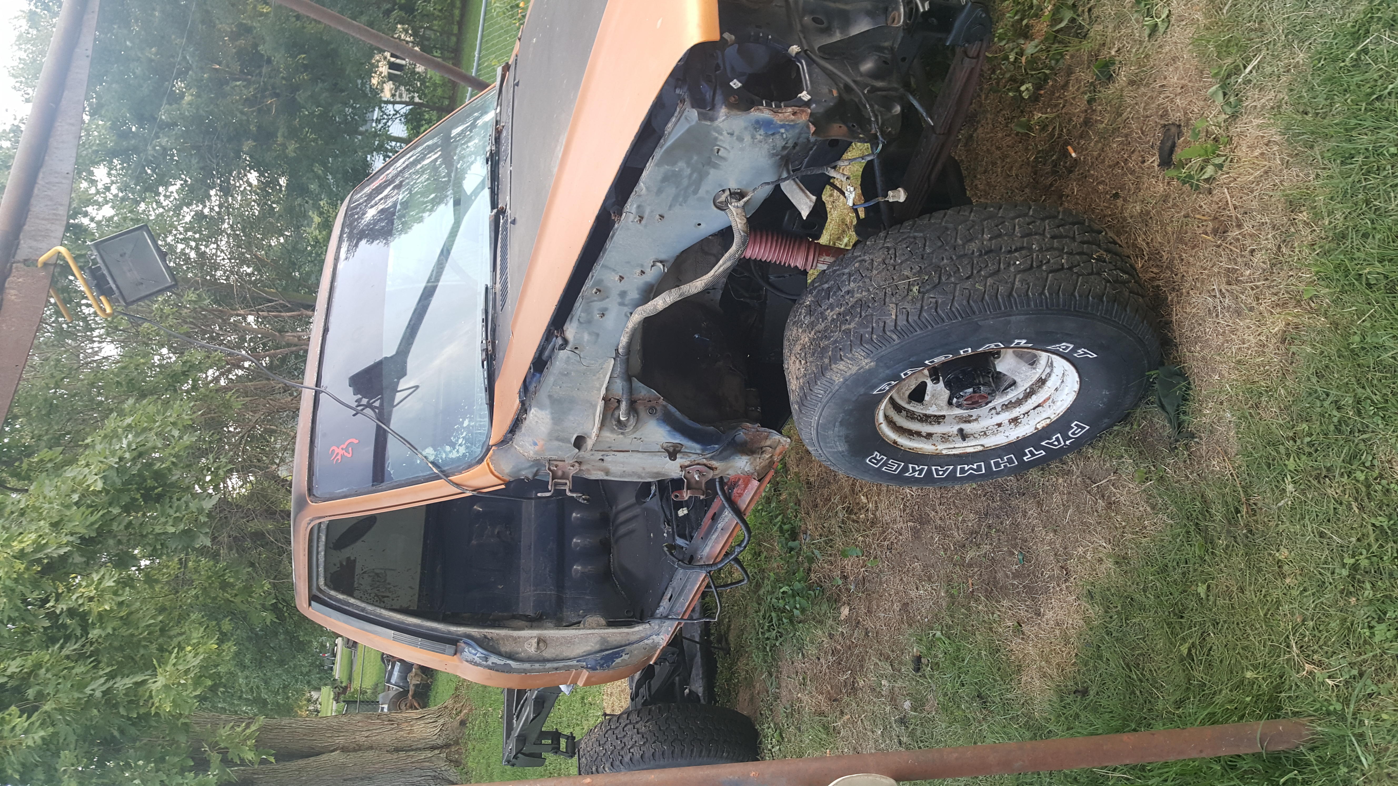

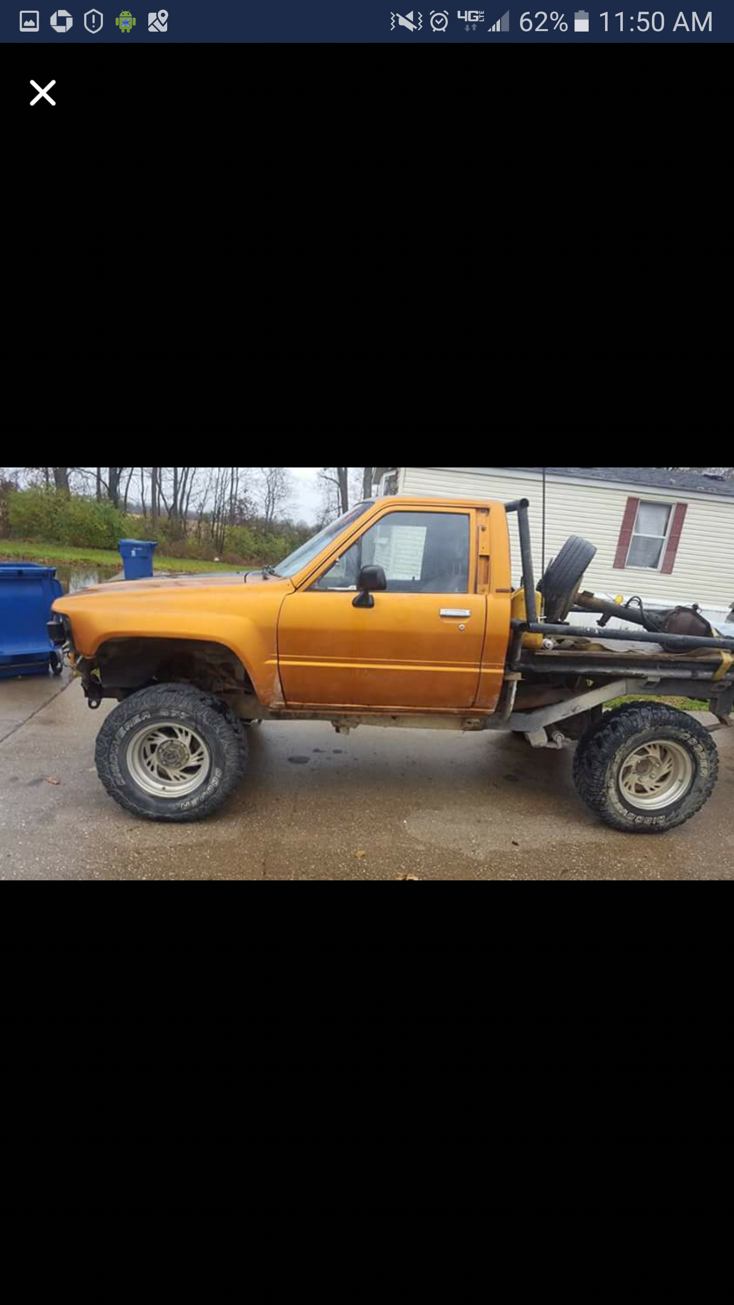

I bought this 87 pickup for $600, and had to go into full stalker mode to find the guy. His phone quit working and he lived a hour and a half away. Nothing a little help from the internet wouldnt fix. I got the truck with the only issue supposidly being was the frame rot. Test drove it for a while, and the accelerator kept getting stuck wide open due to the cable catching. Fixed it with a zip tie, threw the doors on, and i was on my way.

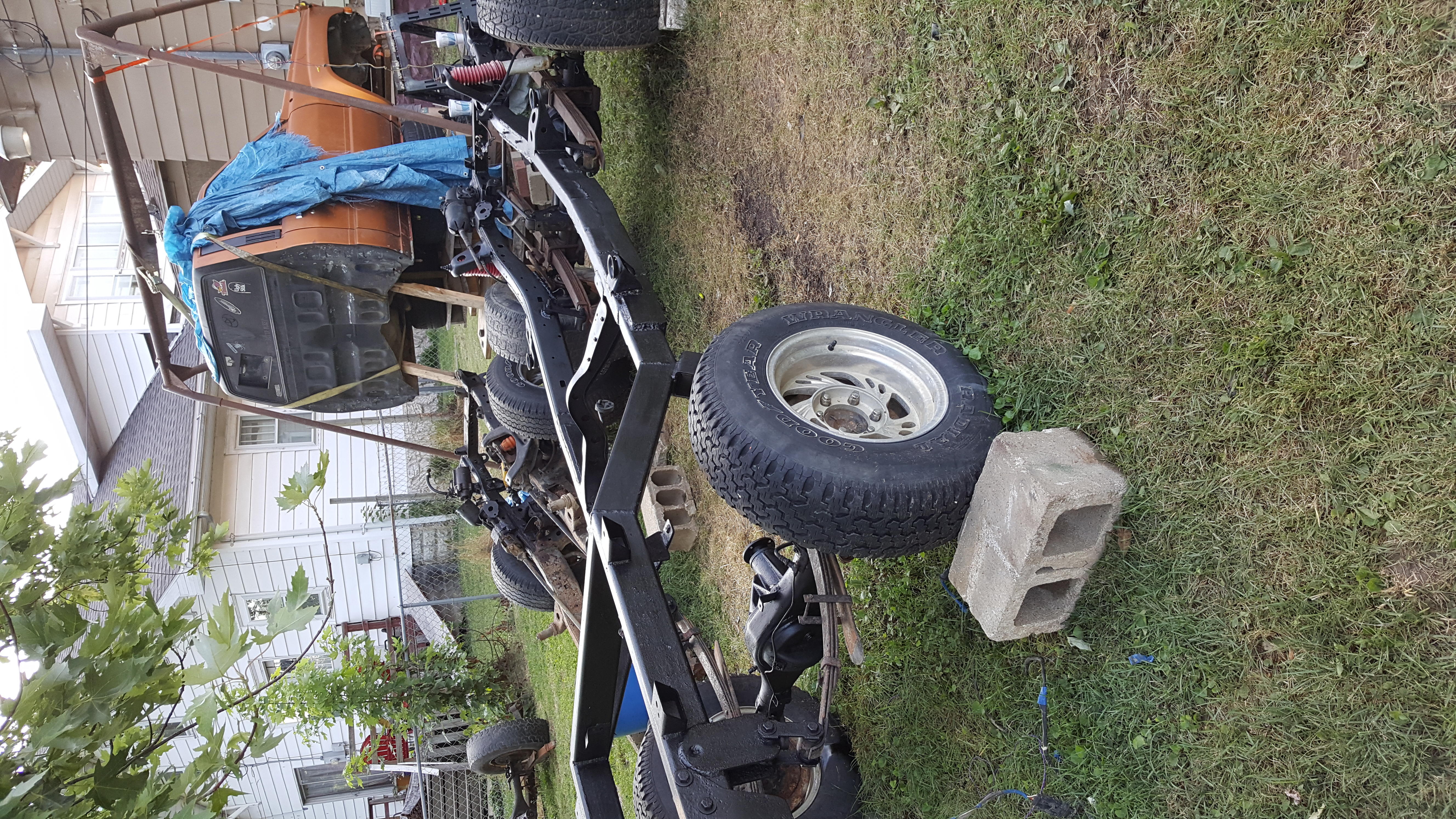

I wish this was better about letting me upload photos. I have to do it one at a time
Attached Thumbnails 87 pickup budget build-20170619_200712.jpg   87 pickup budget build-20170624_211259.jpg   87 pickup budget build-20170624_214842.jpg   87 pickup budget build-20170624_220022.jpg
Old Jul 8, 2017 | 01:20 AM
Jake05241992's Avatar
Joined: Mar 2017
Posts: 19

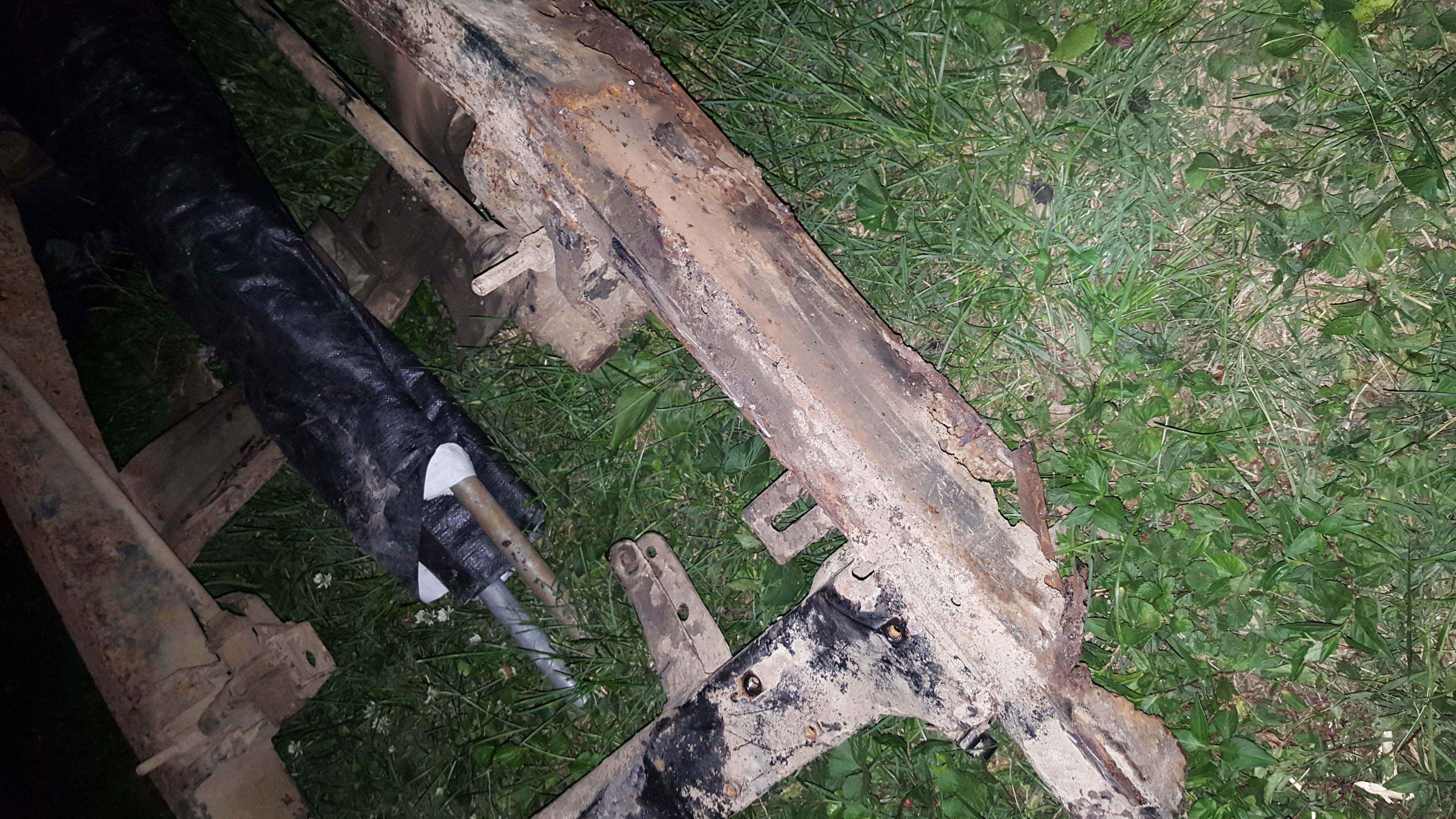

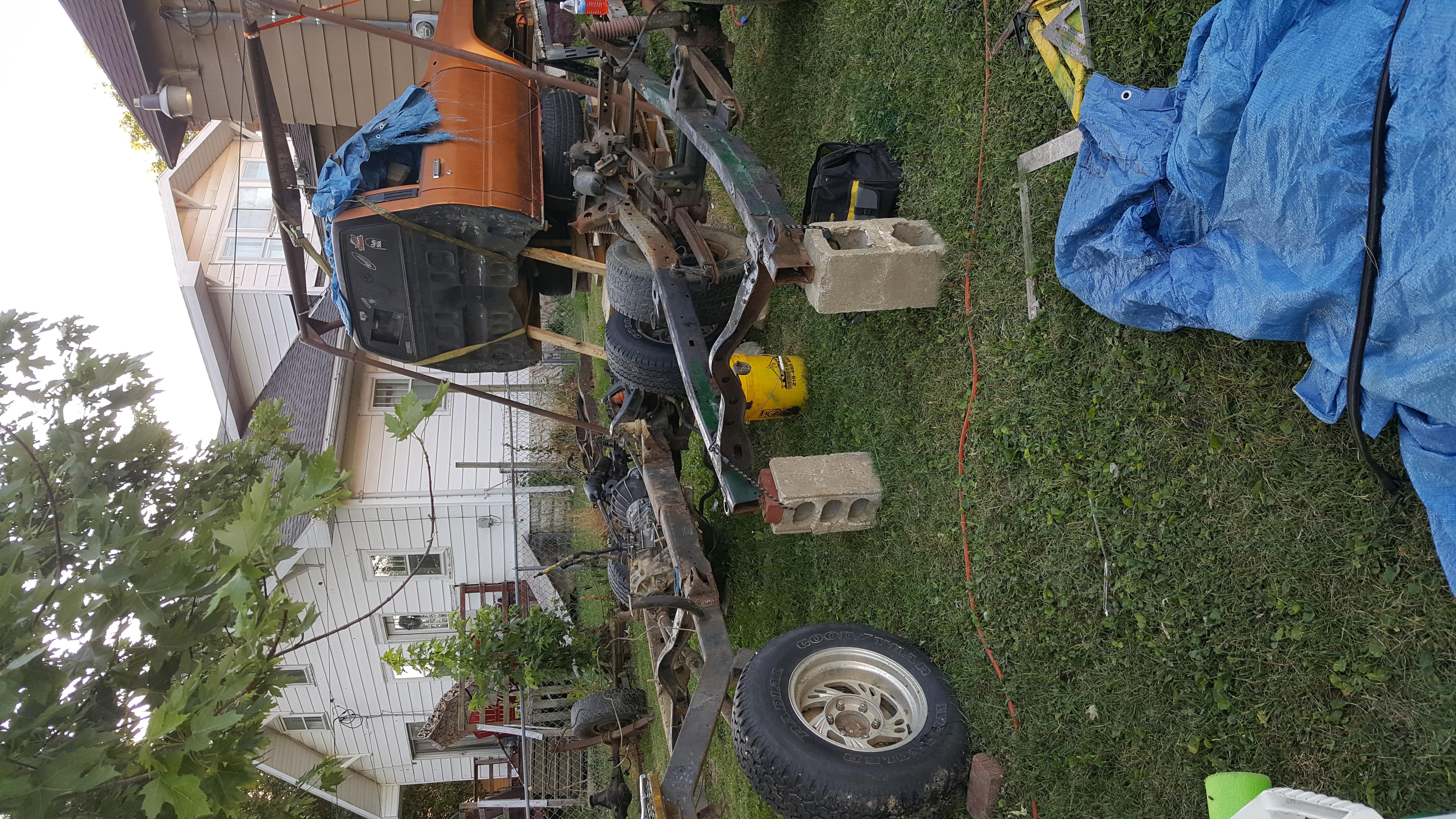

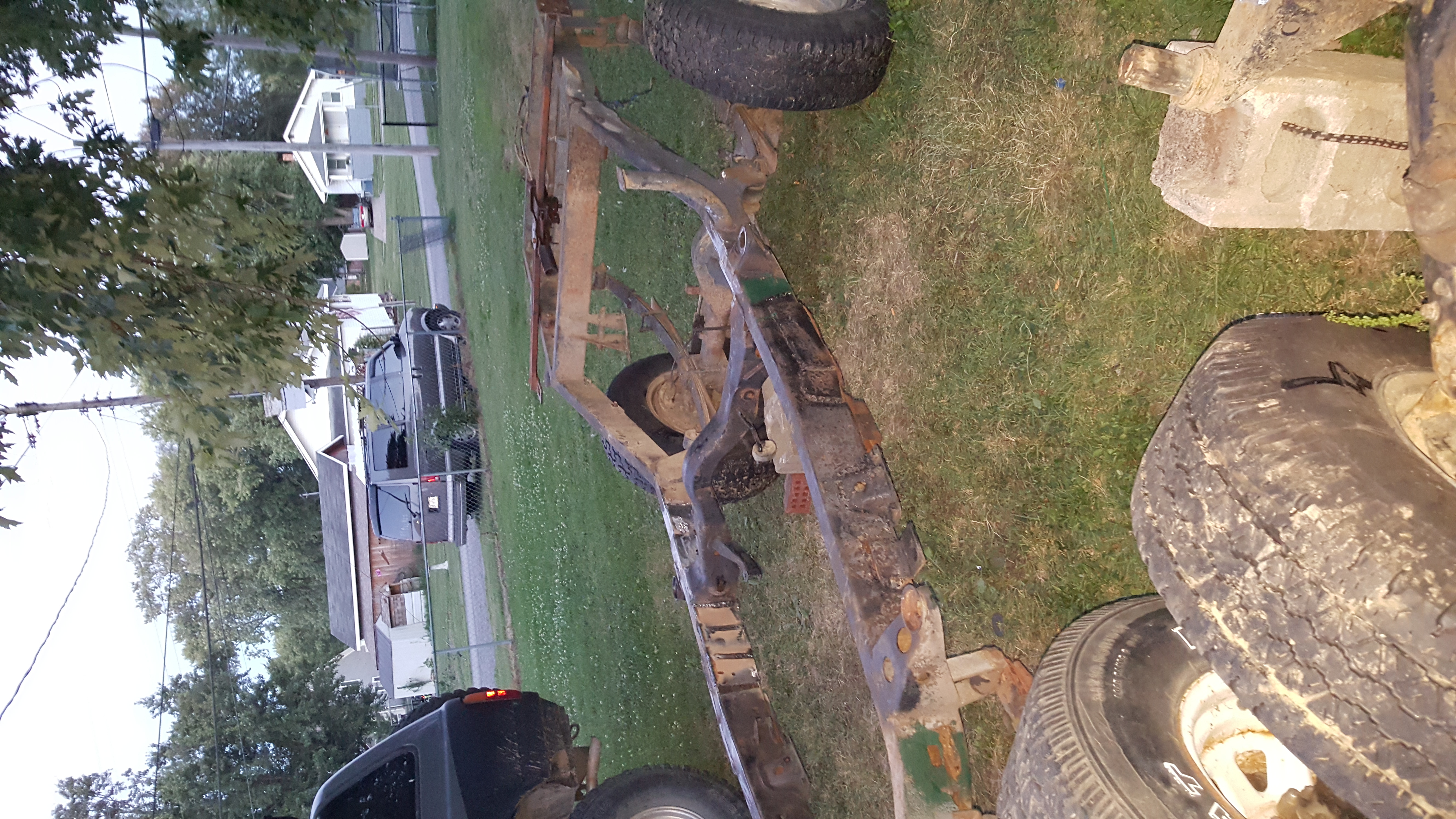

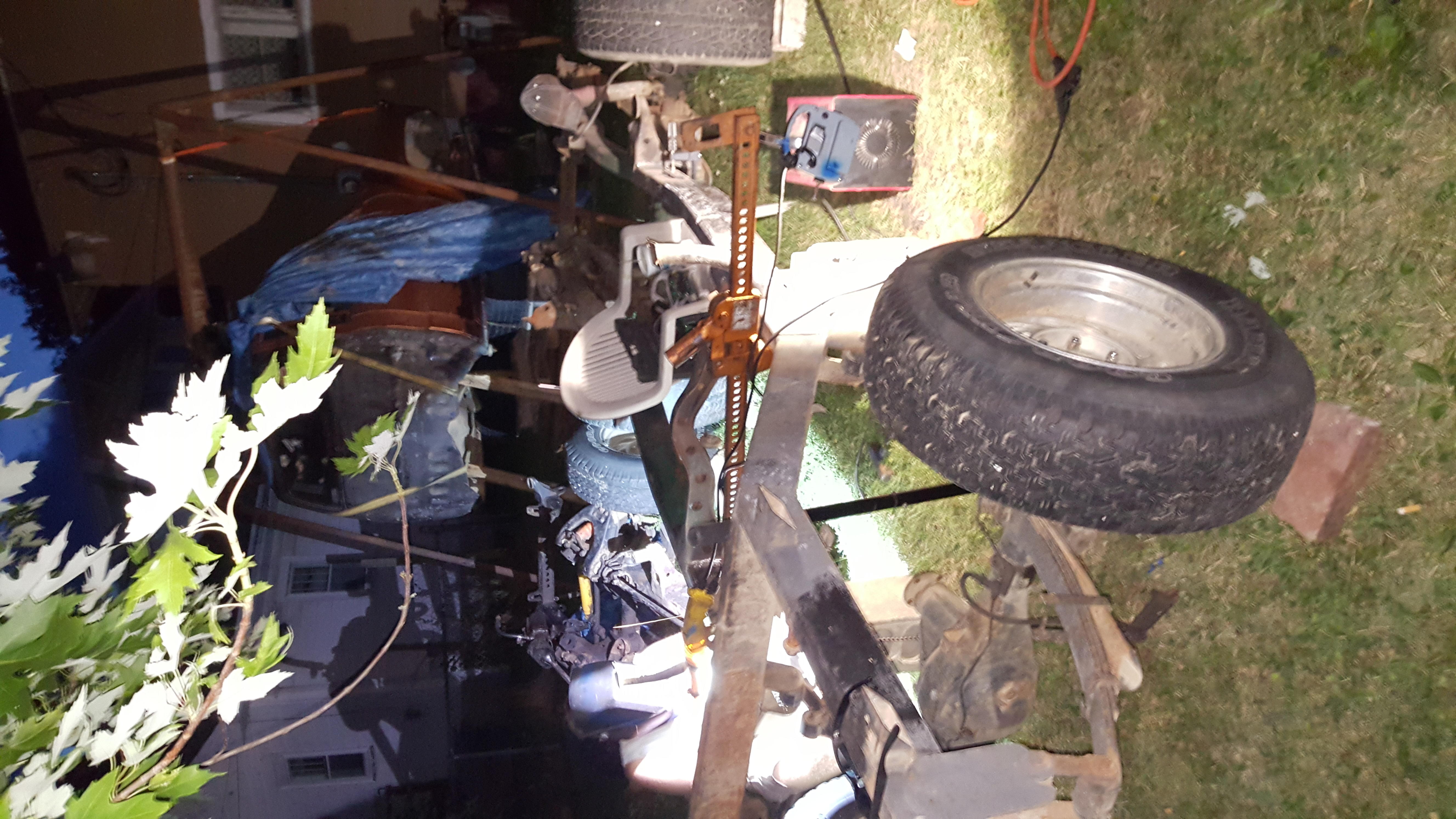

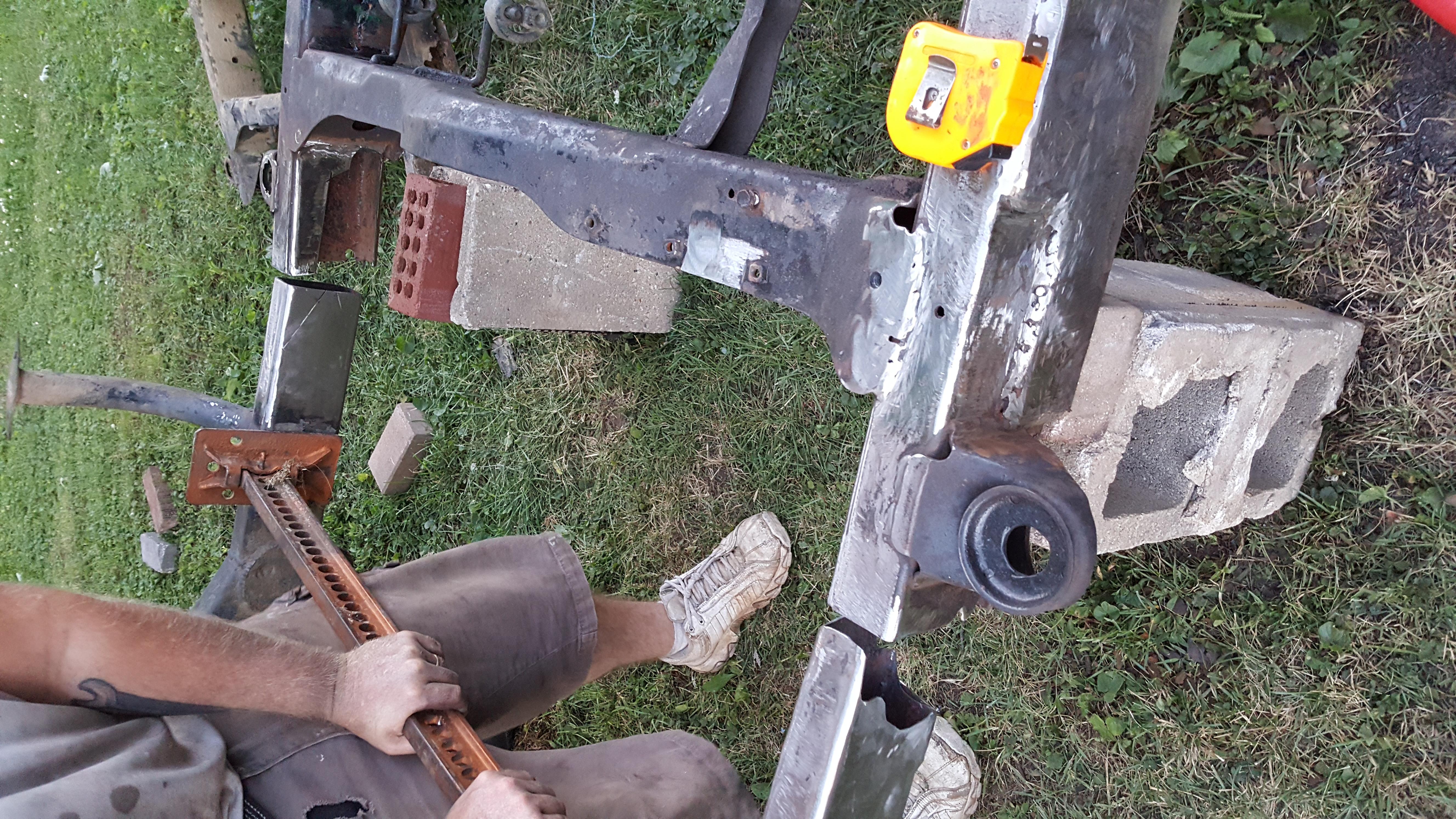

Cleaning the frame up today and buttoning up the rest of it today. Its further along then this. These are just the most recent photos. The one photo is the 87 frame. Not too much to work off of. And ill need all the luck i can get! Haha thanks

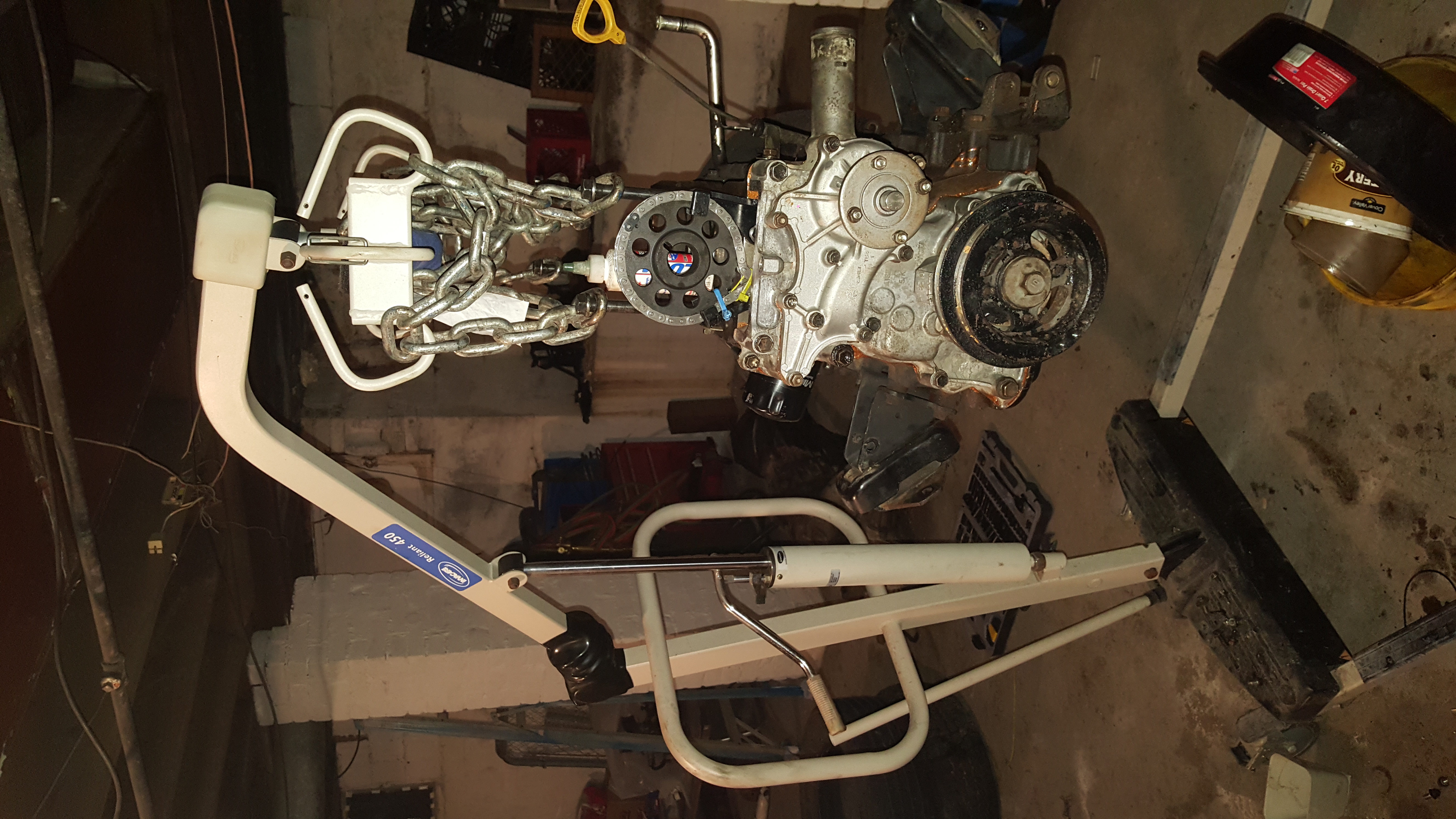

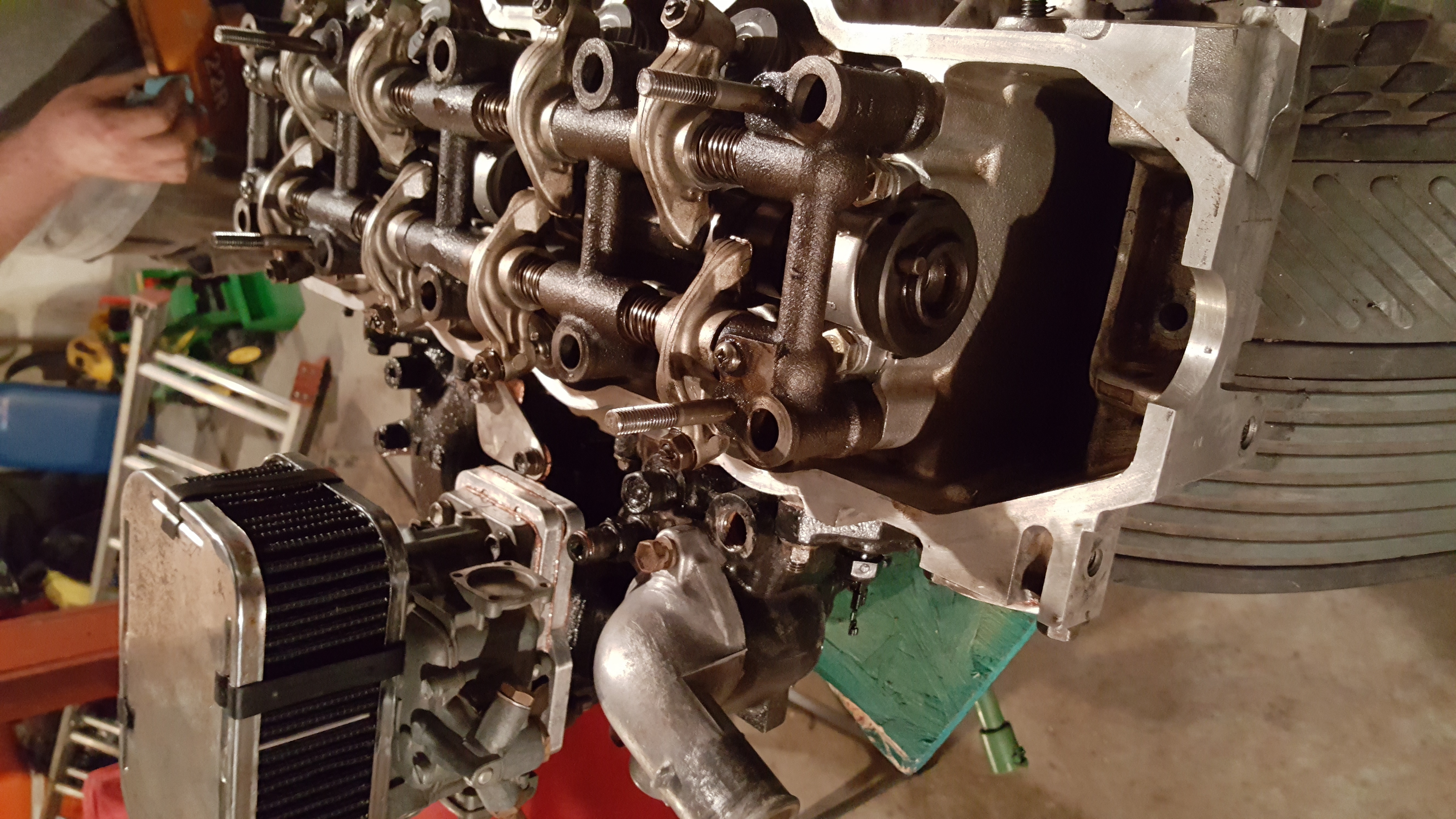

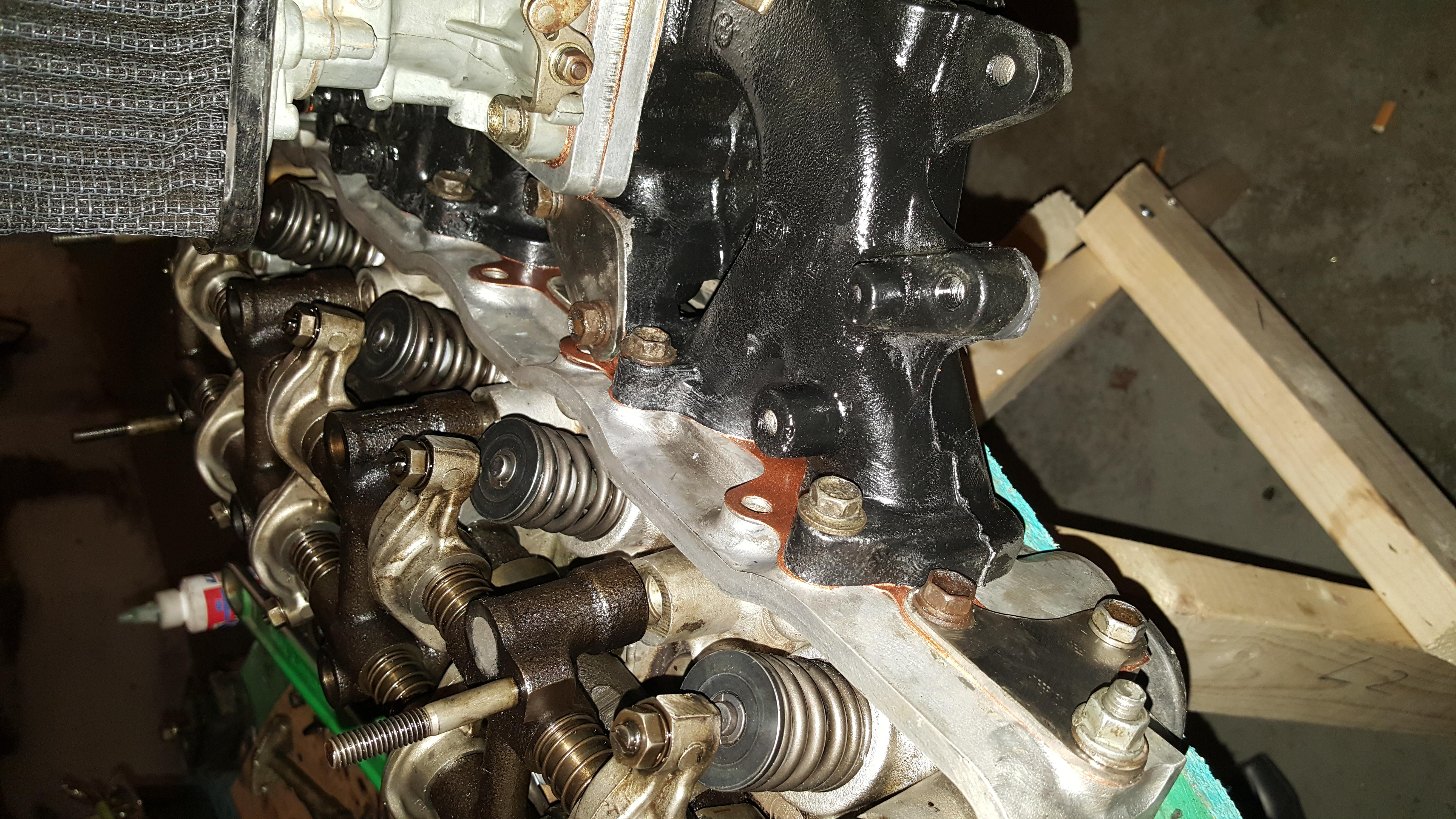

This is the 22r. Built in my basement, so i havent had the courage to assemble it any further. All the little stuff is done. Timing chain, head magnafluxed and plained, valves ground, new seats, and so on.

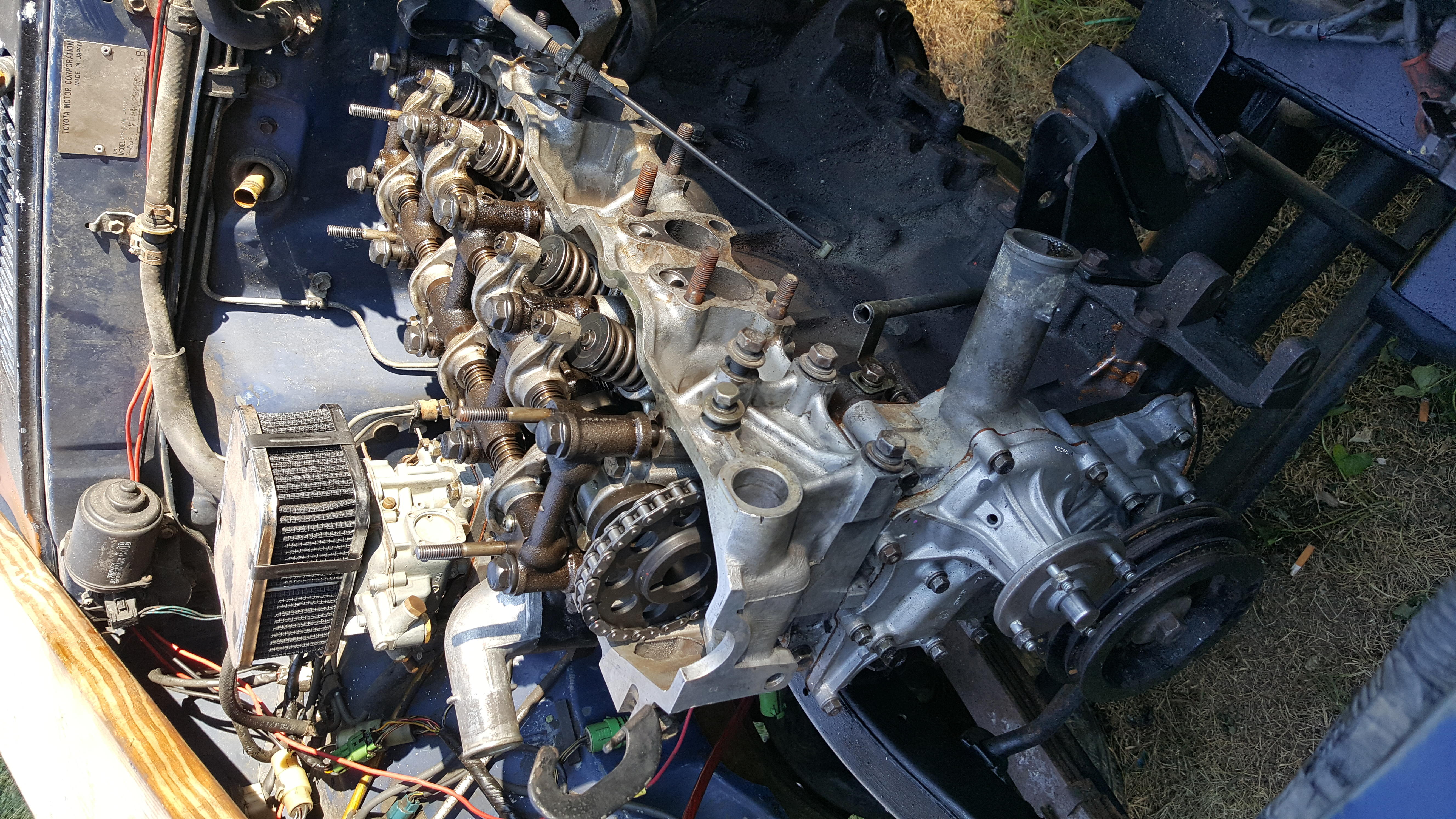

This was the block that messed my day up. Notice the gap in between the head and the timing chain cover. At least i know that not all 22r/22re blocks are the same now.

HOLY COW! You are using a Hoyer Lift to work on the engine! Haha. That is cool. My wife is disabled and we use one for her, and I thought to myself that the Hoyer Lift might work for removing an engine from a car or truck. You've proved it!
I'm enjoying the build.
Old Jul 8, 2017 | 07:35 PM
Joined: Mar 2017
Posts: 19
It works great! Haha. Extreamly stable, easily adjustable legs, lifts plenty high enough, and it moves around my basement easily. I wouldnt use it for anything much larger, but my neighbor gave it to me so i figured it was worth giving it a shot.

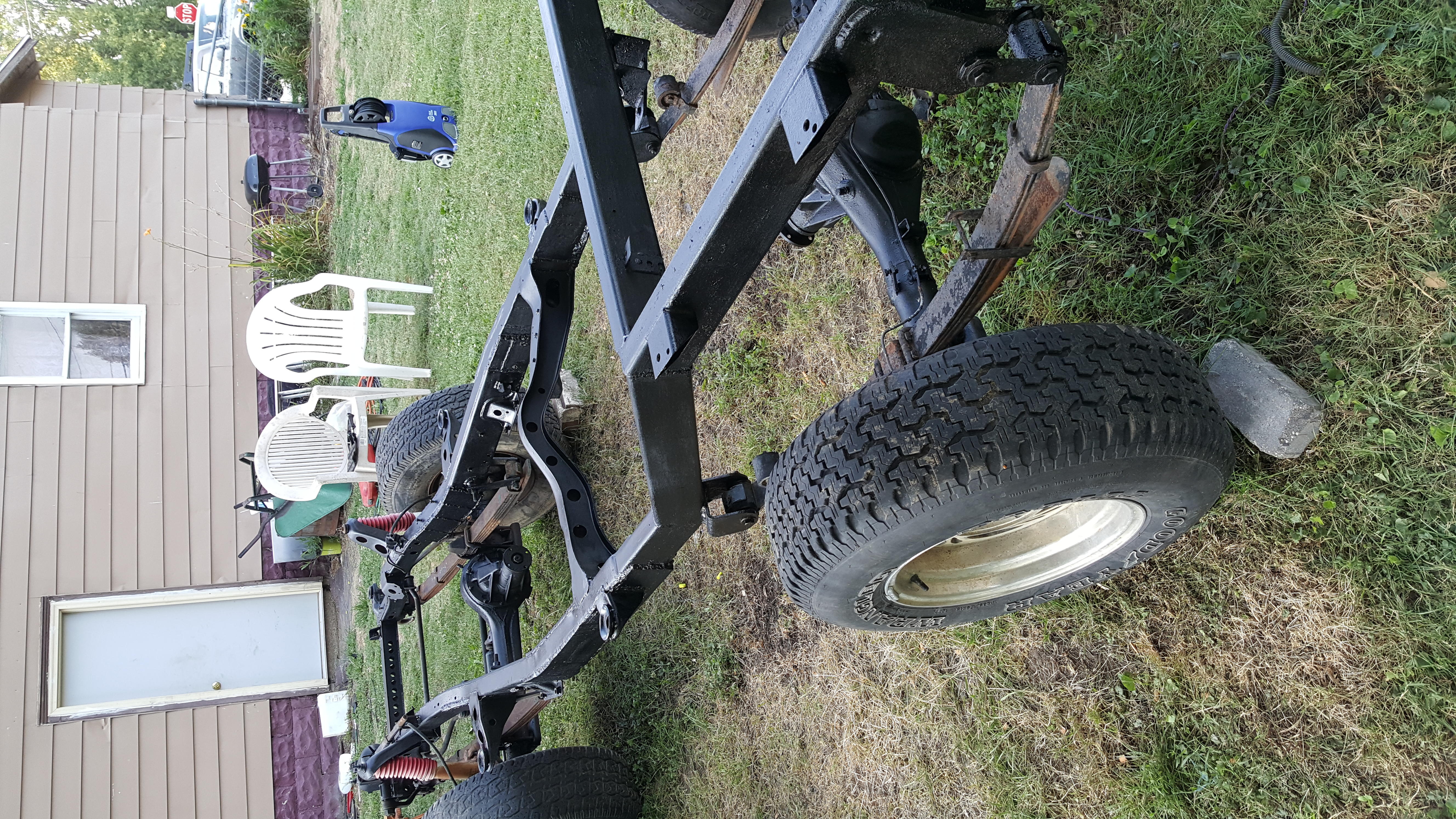

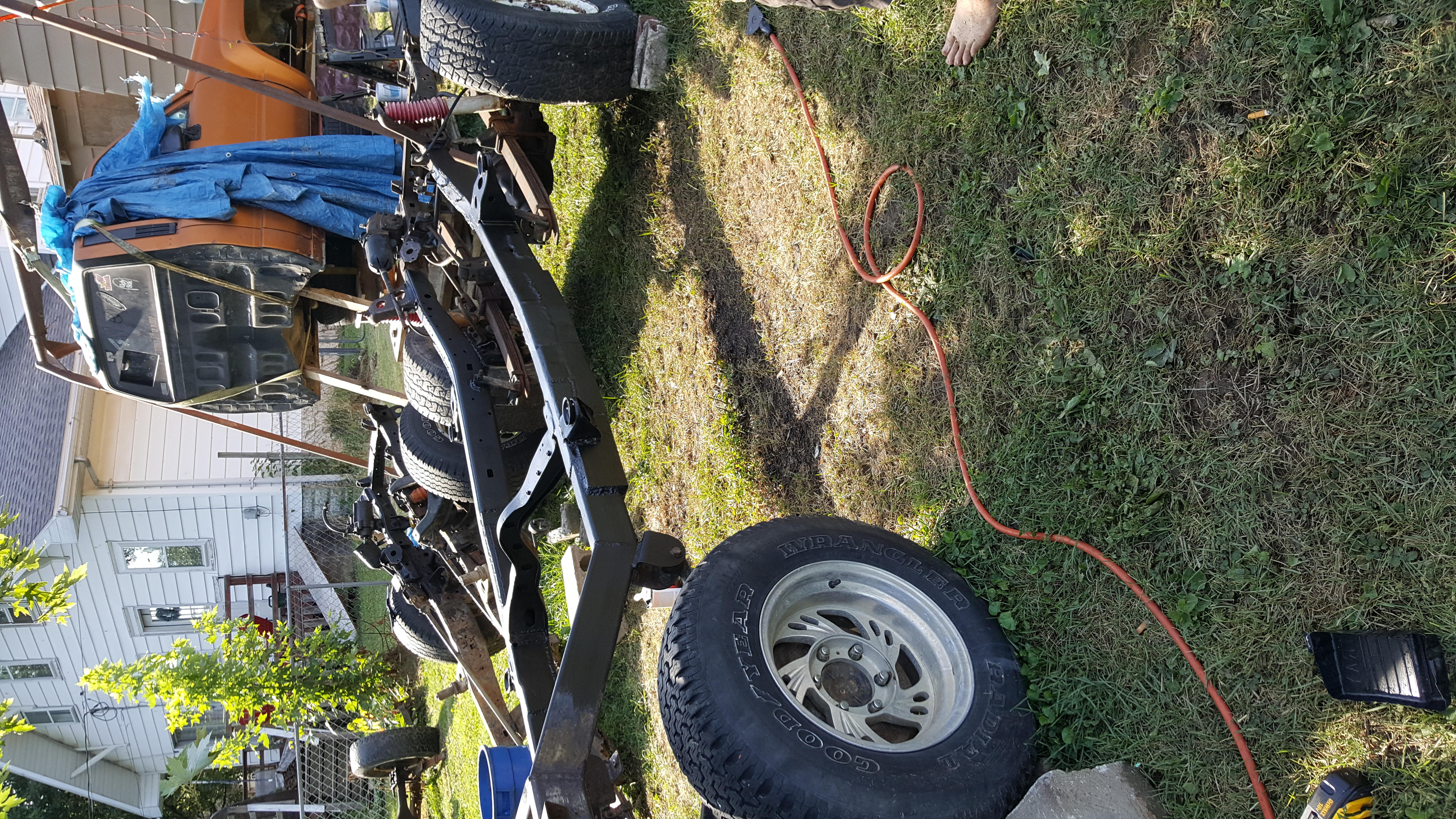

Got the burnt orange basterds frame finished today. Needed a few more patches (bringing the number to around 30), but at the very least it will last a whole hell of a lot longer with about 75% now being american steel.

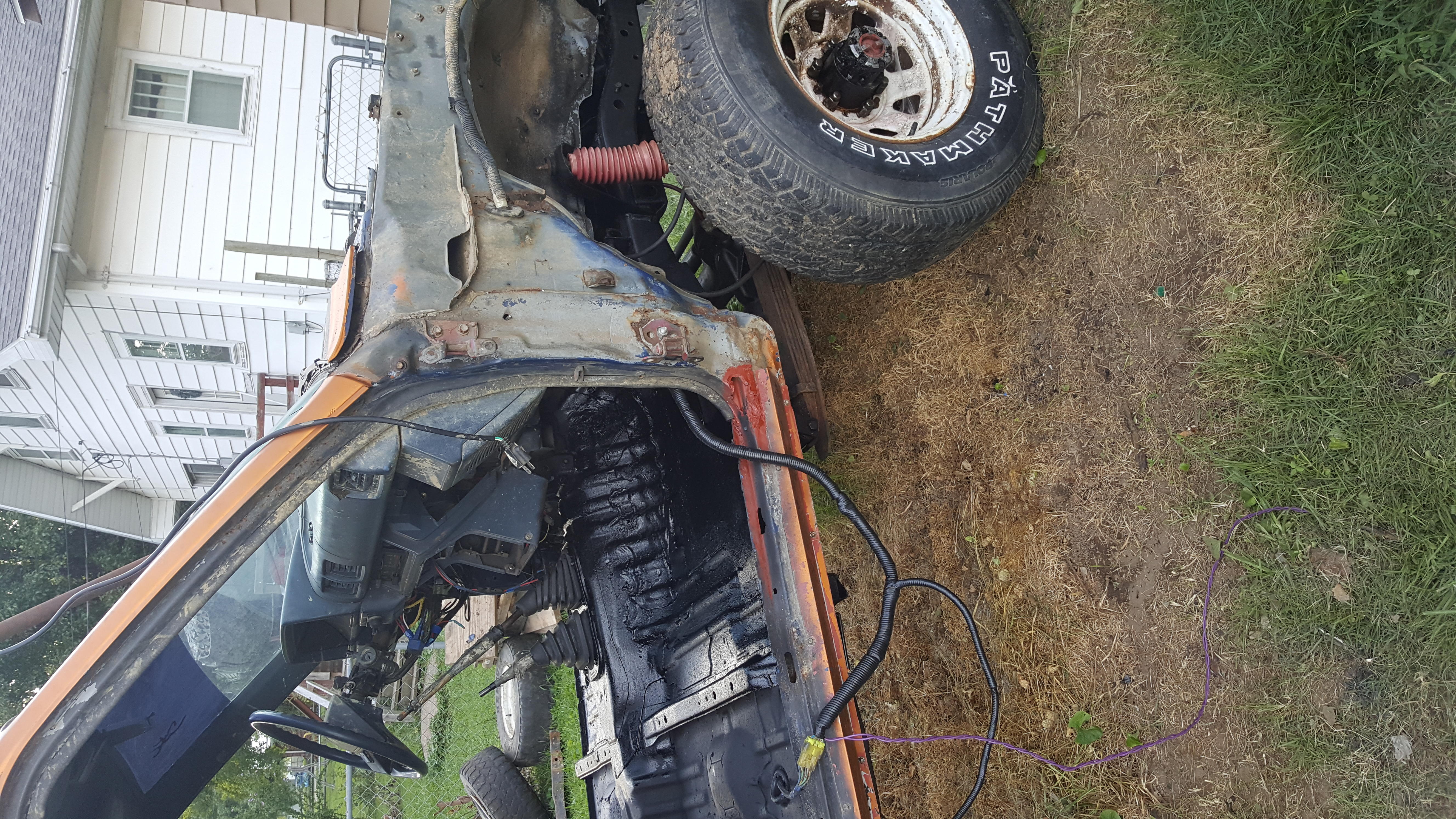

My wife has plans for the weekend with my sister in law, so my brother in law and i will have the next two days to make some real progress. We stripped the cab down to the shell of the body, dash, and the small stuff in the doghouse. I will take photos tomorrow, there is still a lot of work ahead of me.

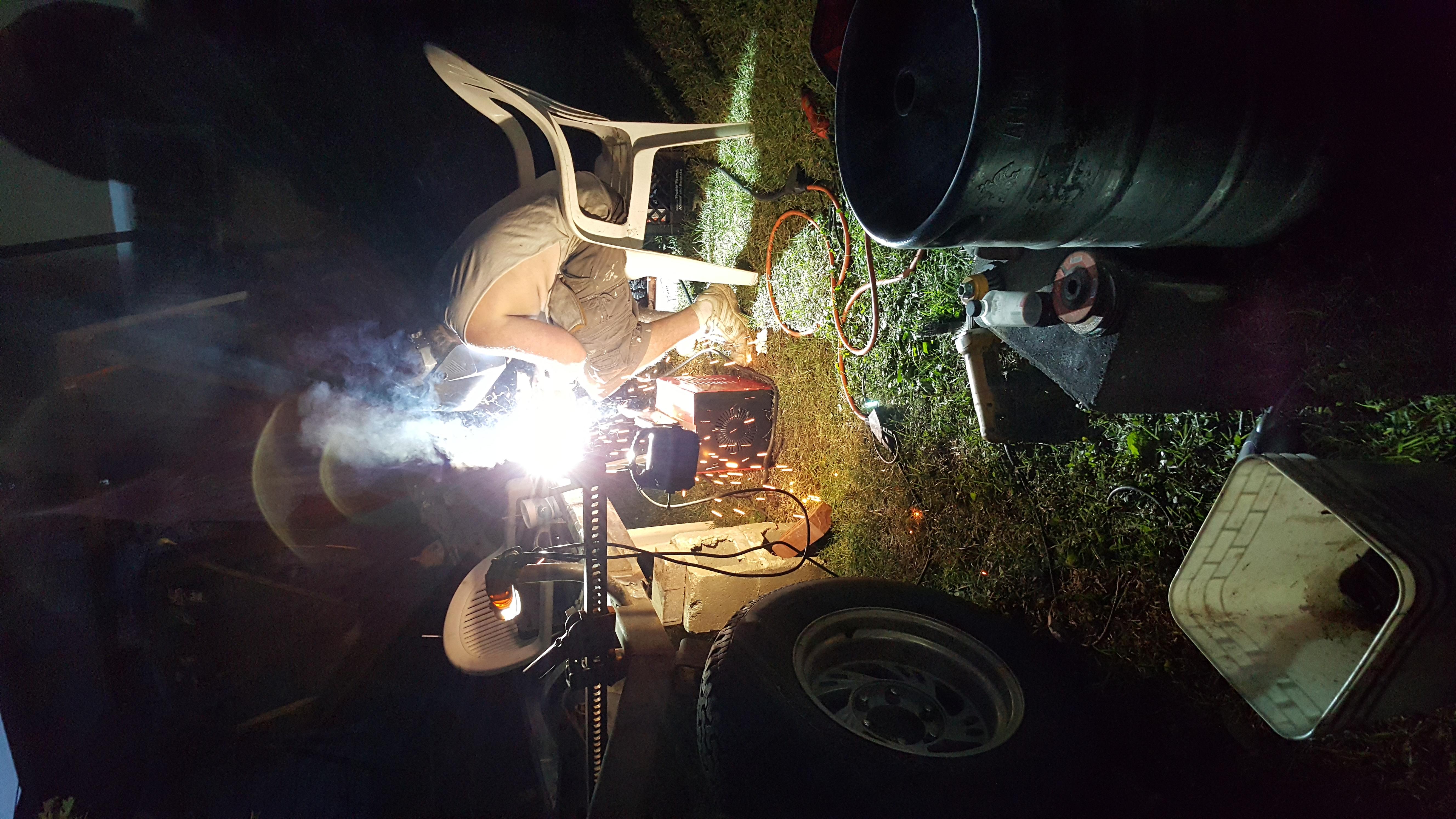

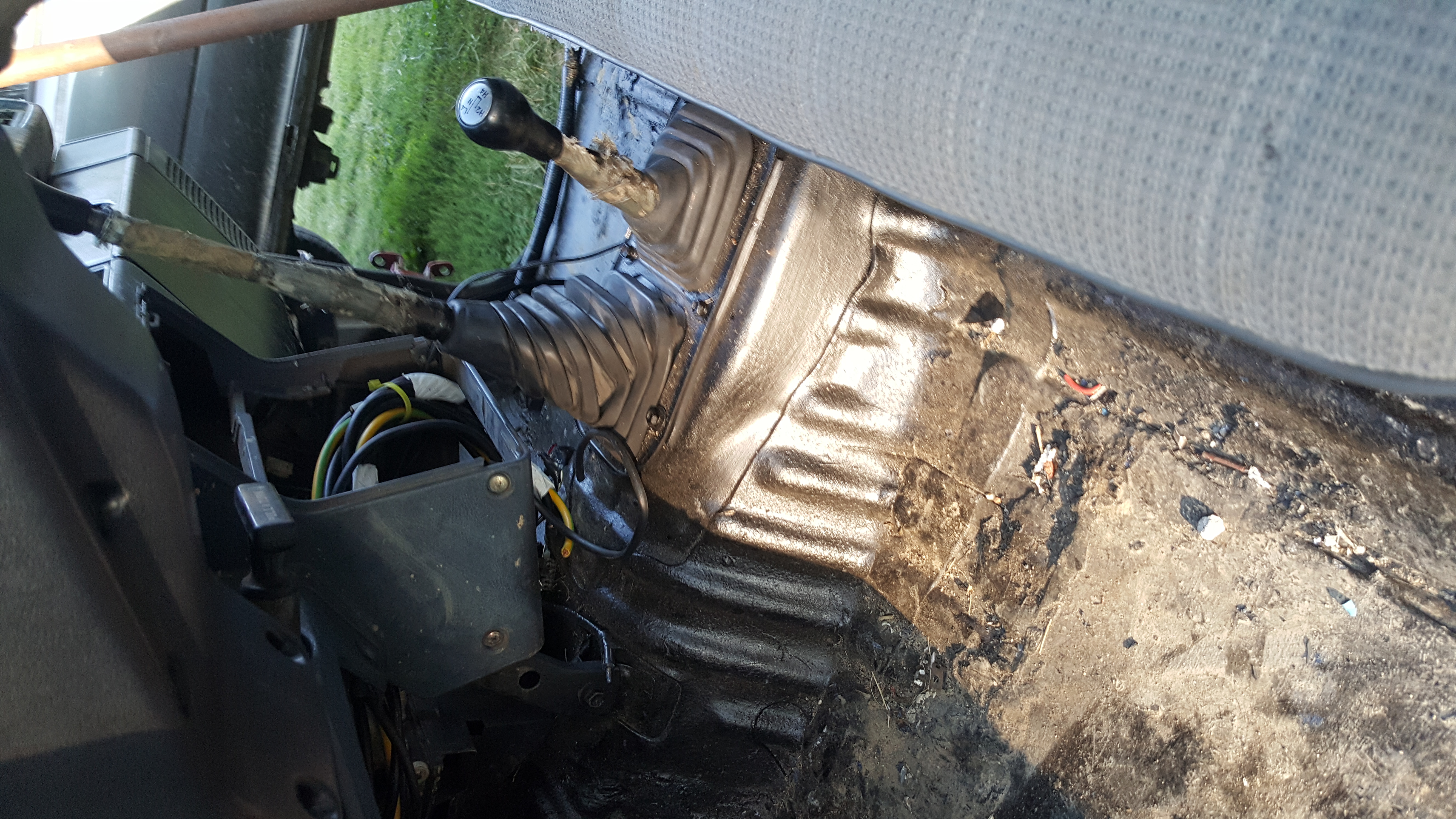

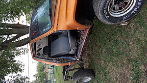

After a long weekend the cab is on loosely, the engine is almost complete and a lot of other things have been knocked out. I got some stainless from work, so now i have stainless floor pans. I got some awesome arc rods that were made for welding stainless to regular steel. Did a thick coating of rustoleum paint that i got for free on the floor of the cab, then a ruberized coat, then coated in truck bed liner.

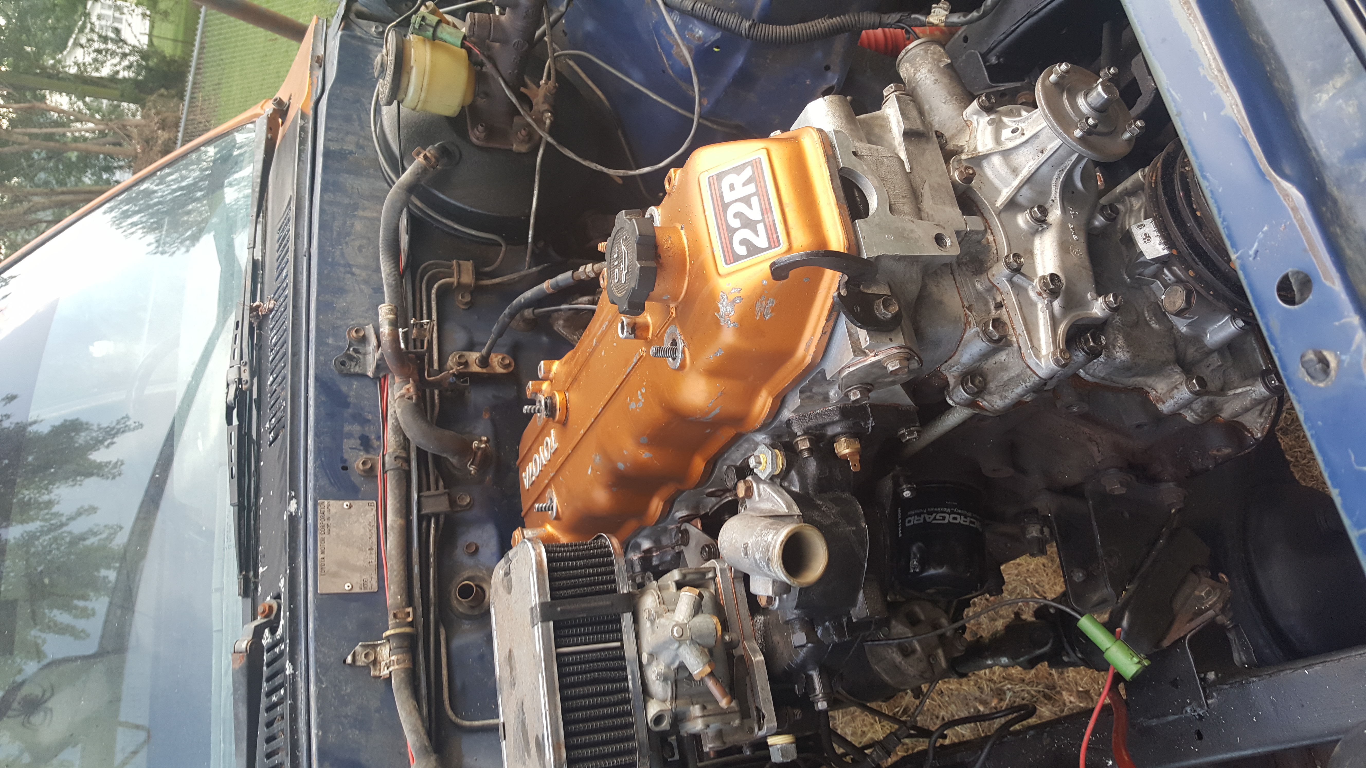

The engine runs like a dream. Still meesing around with the fuel lines trying to figure out what to do. For the moment i am running a electric 4psi fuel pump until i can find the spacer for mu mechanical pump. Fixed the cut and split spots in the electrical harness and covered everything in wire loom. After we bleed the clutch and brakes it should be ready to take out for a spin.

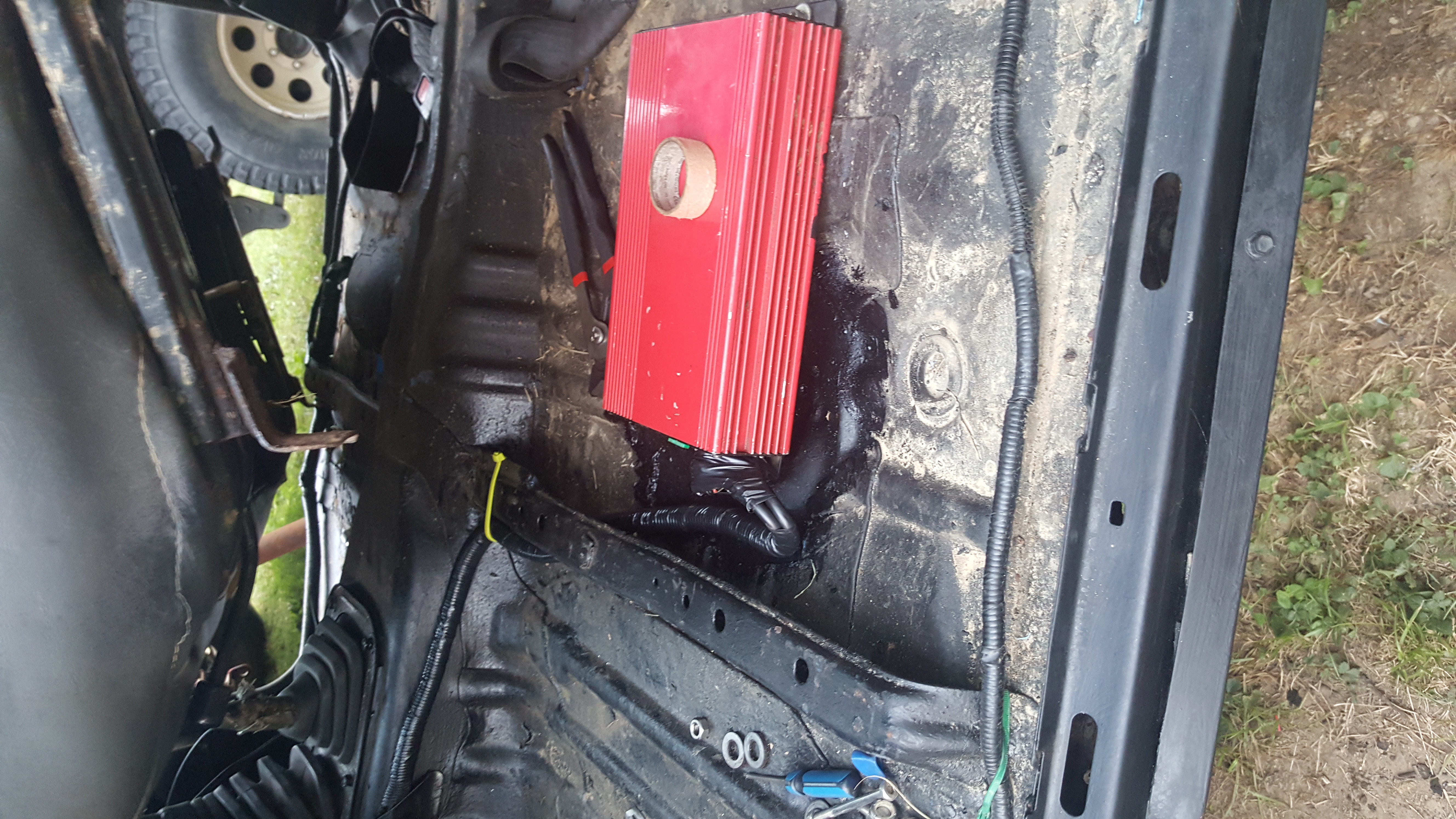

I had some 480volt fine strand wire that i ran since i had it all tore apart. Wired a switch panel that came out of a old ambulance. Wired my inverter up underneath the seat. Threw some led bars under the hood, so ill be able to work on it if i break down.
