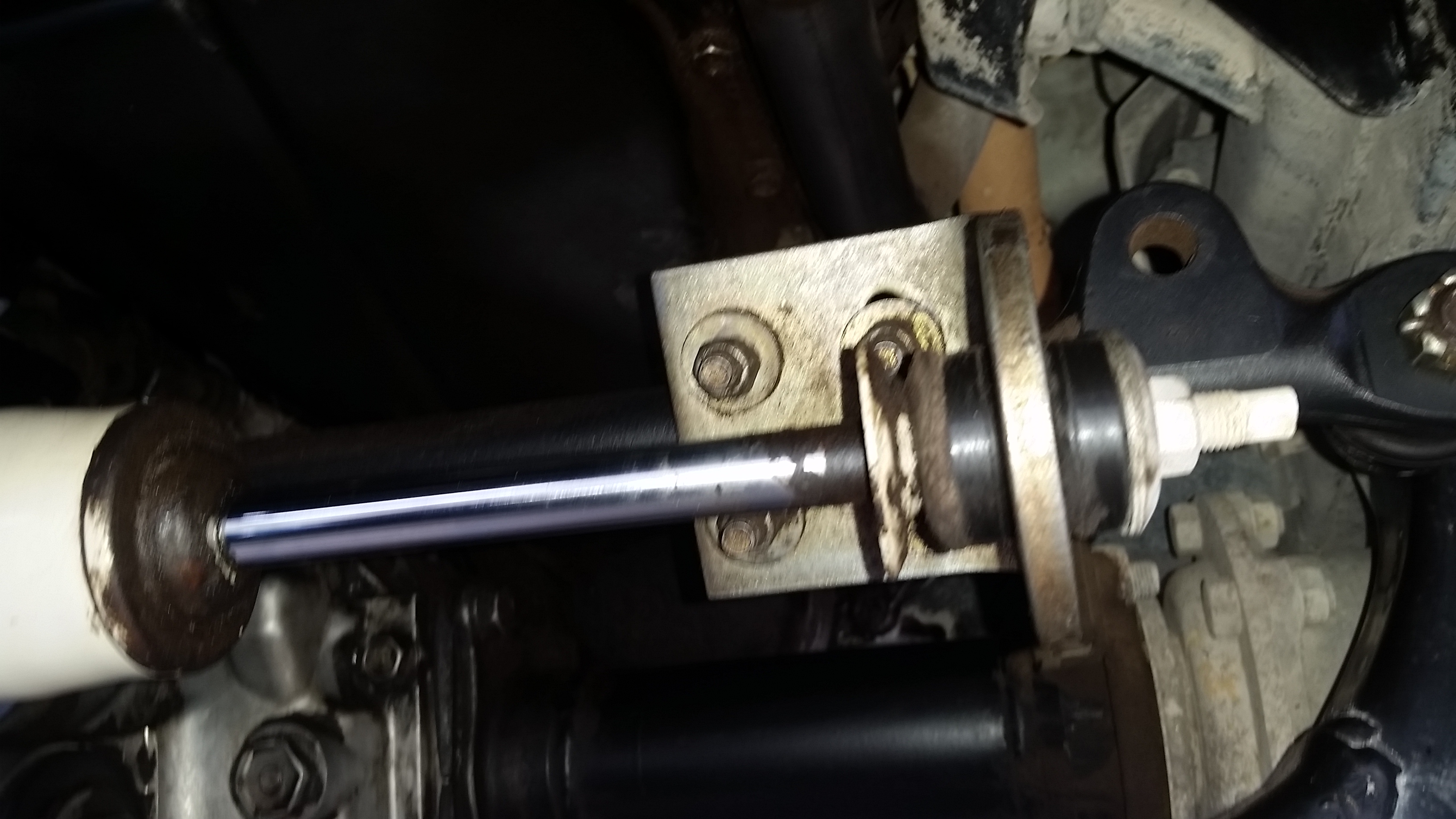

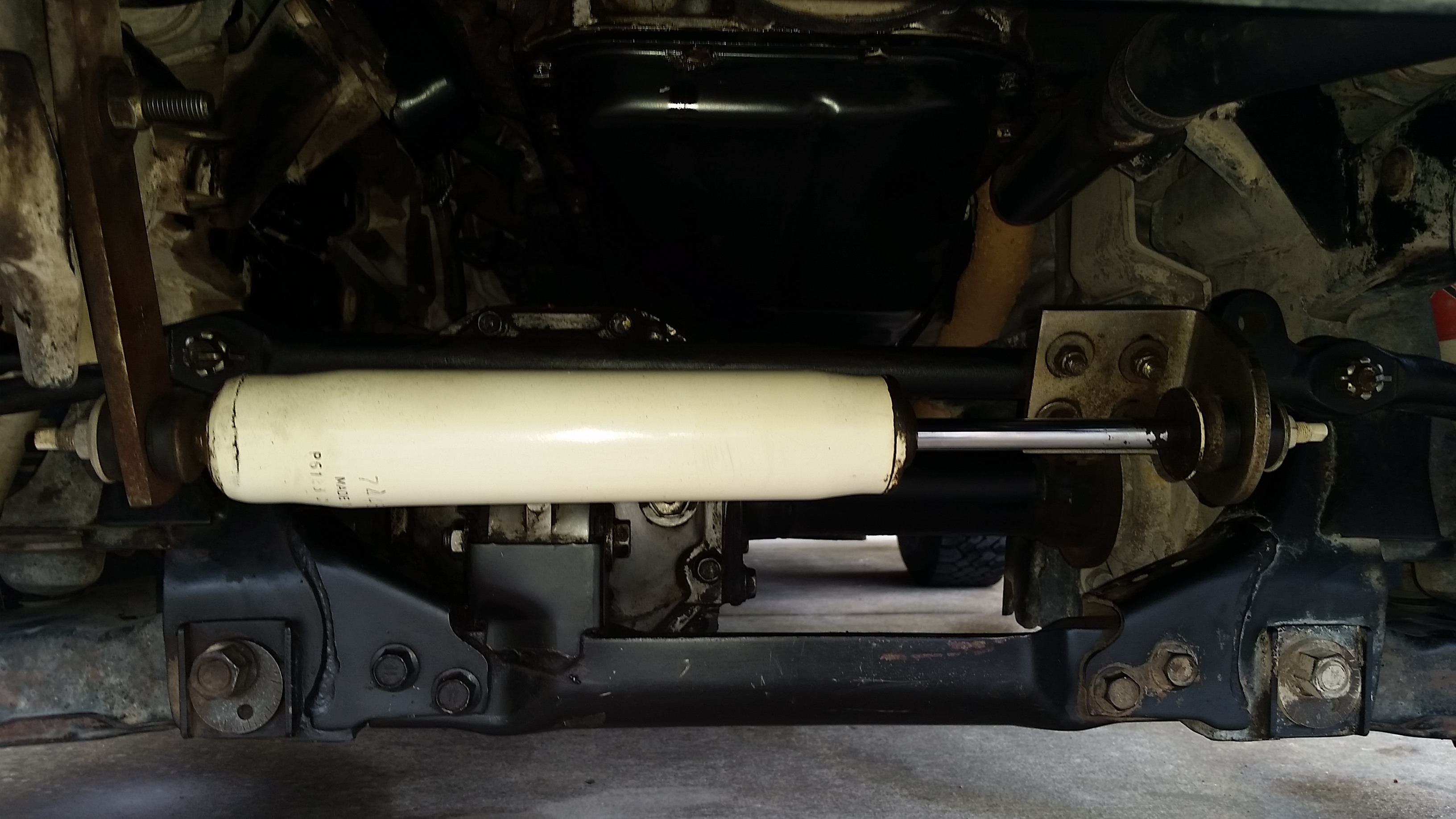

When I bought this truck and I took off the front skid plate, I found that there was a shock absorber mounted horizontally. What is it for? Do I need it if I am not off roading?
The shock was not mounted to existing holes in the frame, which to me means it has been jury rigged. Obviously this is not stock. Can I take it out?

Steering Stabilizer
The purpose of a steering stabilizer is to tame the action of trucks and SUVs with oversized tires. When you equip your ride with larger tires, you may become a victim of the “shimmy” effect or the “death wobble.” But, a steering stabilizer ends the common vibration problem that larger tires can cause, smoothing out your ride. So, you get improved handling and better ride quality.

Its a 'steering damper', supposed to minimise steering wheel kick-back and front end shimmy.
Your truck, had one new from the factory, but someone changed it out for some aftermarket type.
You might do without it, but probably best to leave it, or restore the factory type damper.

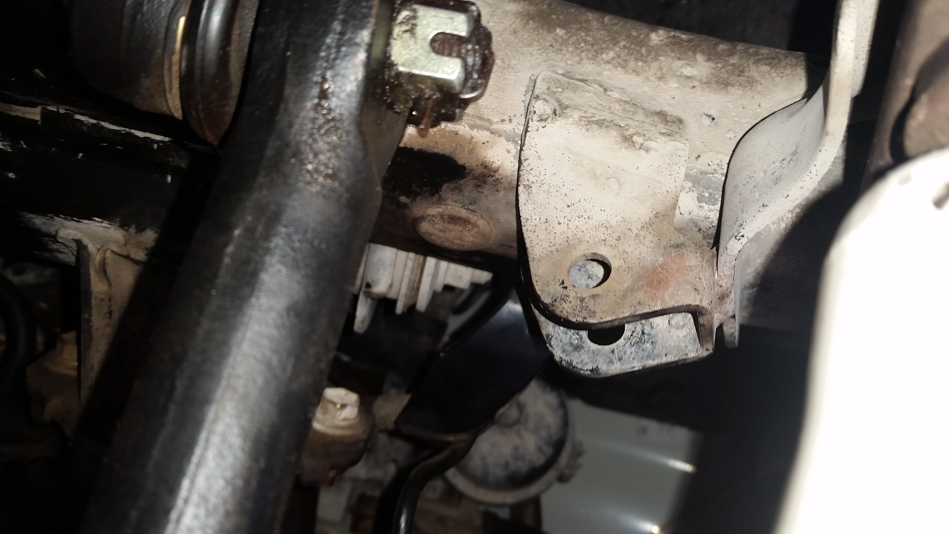

I found where the OME shock connects to the steering. There is a tapered hole in the tie rod just above where the present shock is connected, and a bracket welded (looks original) to the frame for the other end.

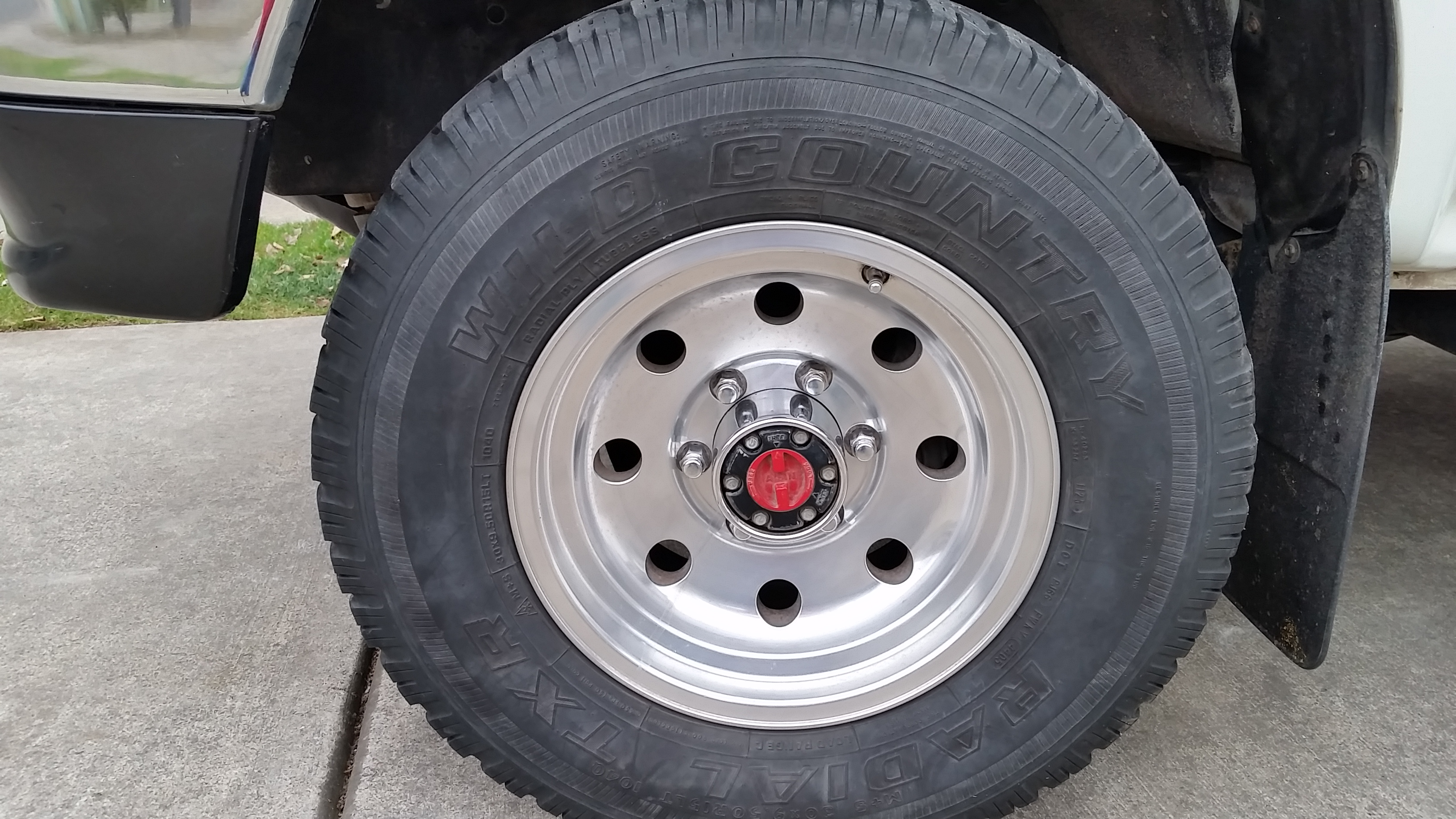

So It must have been that the OME shock did not do the job and the heavier shock would not fit in the original position. At present there are 30 x 9.5 x R15 tires on the truck. Is that why the larger shock?
I do not need the large tires, but I do want to keep my aluminum rims, so I guess I will have to replace them with an equal size tire.
I do have a slight vibration at around 65 mph, so maybe that shock has seen its day.
Do they make a heavier shock that will fit in the original position? Looks like it may be too close to the oil pan.

I have that size on mine and the oem toyota dampener works fine.

It concerns me that you keep using the word "shock;" make no mistake, this is not a shock absorber. A shock absorber will continually apply pressure to extend out and the weight of the vehicle prevents it from fully extending. If you were to put a shock in place of the steering stabilizer the gas pressure inside the shock would still try to extend out, and cause the steering to turn to the left, then you would have to overcome the internal gas pressure and compress the shock in order to go straight, or turn to the right. By contrast, a steering stabilizer is neutral; it resists movement inward or out.
I have had an OME (Old Man Emu) steering stabilizer on my 4Runner with 33x12.5 tires since roughly 2005 and it still seems to be holding up well. I got mine from TRD Parts 4 U, but I'm sure lots of other retailers sell it as well: http://trdparts4u.toyotaofdallas.com...dproduct=-7503
