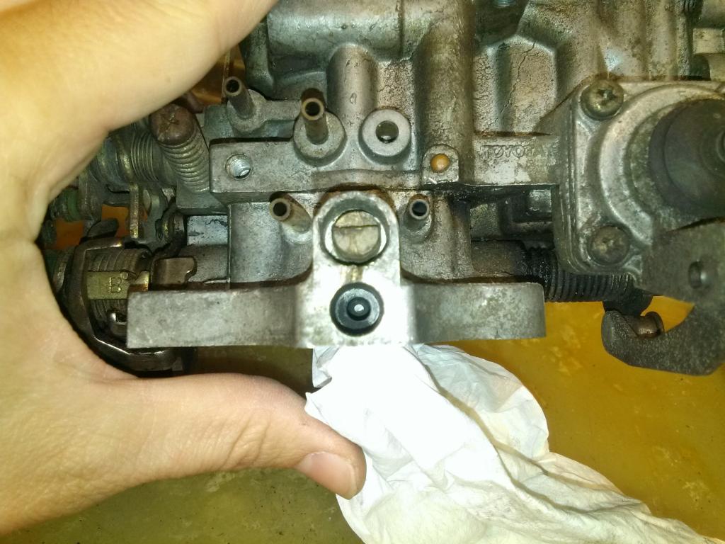

I hate to sound like an idiot, but I've searched and not found my answer.
I'm disassembling my carb to throw it in the ultrasonic cleaner, and realized that there is an open hole at the base of my carburetor. I'm no expert, but I assume that the inside of the carb shouldn't be open to atmosphere...
You can see in my pic, the white towel through the center of the hole.
What goes in this hole? And what is the weird screw/ stud in the hole above it?
The truck was given to me with a broke 22R... I put a different motor in it and was able to limp it 5 miles to my new home, but it ran like crap and there was fuel coming out of the accelerator pump, and condensation dripping from the ice-cold vacuum lines (I assume from fuel evaporating in the vac system), so I decided it was time for a rebuild. I grew up with fuel injection, so this is only my second carb rebuild and I did the last one 12 years ago with mixed results.
Believe me, I've read through a ton of threads already and am following a few walkthroughs as I disassemble.

Just found a pic online saying that's where the idle mixture screw should be. Can someone confirm this for me please?
If so... holy crap, no wonder it ran like garbage.
I don't know what has and hasn't been tinkered with on this truck... apparently someone really dicked around with it in the past.
yes, that is the mixture screw.

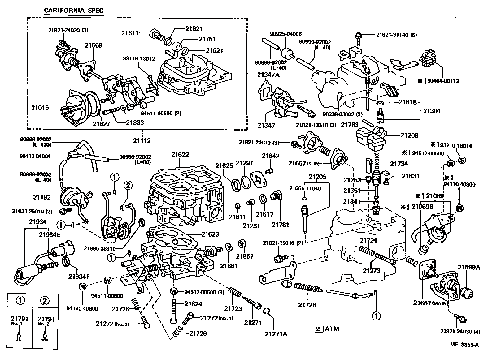

Yes, as was stated, idle mixture screw.
It looks like the parts are sold individually, but you will need to confirm.
In the attached parts fiche:
Spring: 21723-37040
Screw Needle: 21271-35010
