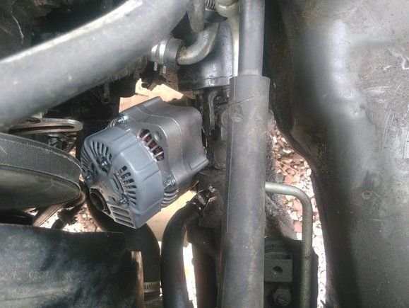

Originally Posted by Blueman
On my '87 with 22RE I did it from the top. Didn't seem to be a problem.
Yeah it goes in from the top but it's a bit of a juggling act and you need to be able to hold it in an awkward angle. Somewhere in my photo album is a reference picture..

Here's a picture, it goes in like this from the top then you can reach up from the bottom and rotate it where it's supposed to be.
darn! I swear I tried that but should have tried a little harder. I didn't go so far as taking the air filter assembly out though. ( 1985) it would have been better. I'll give it a try one day with the old one!
