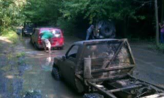

Guy at the autoparts store was saying maybe the ignition, like the ignition is not telling the alternator to turn on.
This was a few hrs before the battery stopped charging.

see my above comment. cannot comment on the ignition being the issue, I'd have to look at a wiring diagram, but I wanna say the ign switch or otherwise is not tied into the alternator. Is your battery/brake light on?

if no lights are on then it's not the stator/field wiring/ignition. If it were those or the CHG fuse in the fuse box under the hood, that light would be on as it indicates the field windings aren't getting power. So your problem lies in the battery cables/grounds themselves or inside the alternator in the way of the voltage regulator or stator brushes. Which matches up with the fact you were in a water/mud pit before it went out. I hate auto parts counter people. They have no working knowledge of anything.
