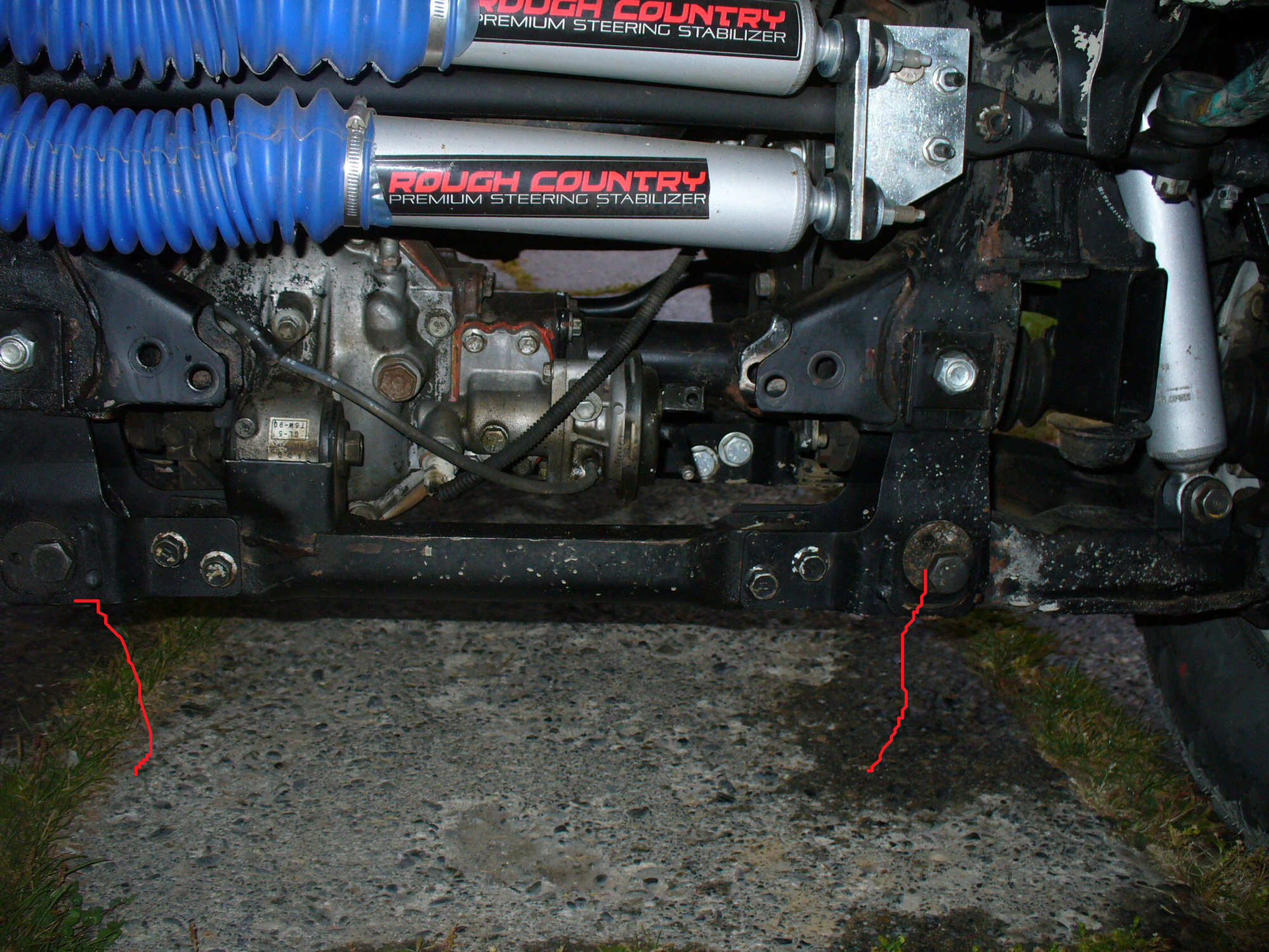

I see from your pictures that the front alignment adjusters are set with one all the way in and one most of the way out. this is likely your issue, did you have a shop do an alignment on it? if not that is your next step, and make sure you get a computerized printout! I can tell a lot from that.

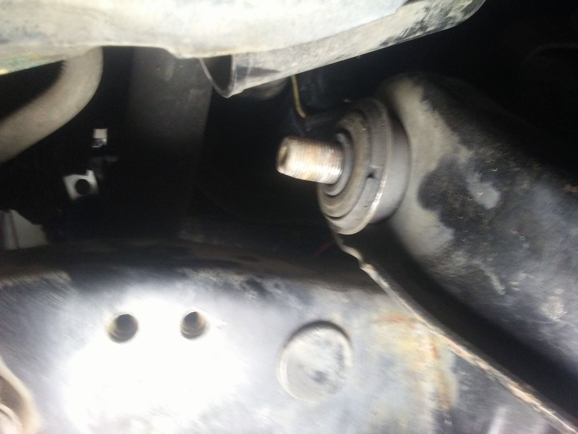

No washer or nut left front of torsion bar and rear nut was loose too!
Jacked front end up as high as I could, pulled tires and stared at it - both sides - wondering what the hell would cause the shock to be hitting after all it still drove and tracked well even over the ruts on Kenai Bridge Access - as akwheeler can attest to - we don't have any freeways around this part of Alaska and the paved main roads are just ok.
I pulled shocks figuring to trim the bump stops …that’s when I saw no nut or washer on the front of the left torsion bar as seen in photo above - the rear nut was loose as well!
used a de-burr bit to grind of excess on bump stops
Scrounged a washer & nut from local junkyar, installed and torqued both nuts to spec. (166 ft. lbs.) - Tracks well
Akwheeler thanks for noticing the alignment adjusters being as they are - didnt notice and will be having a serious conversation with the mechanic who did alignment!
Alignment adjusters - don't look very aligned to me
