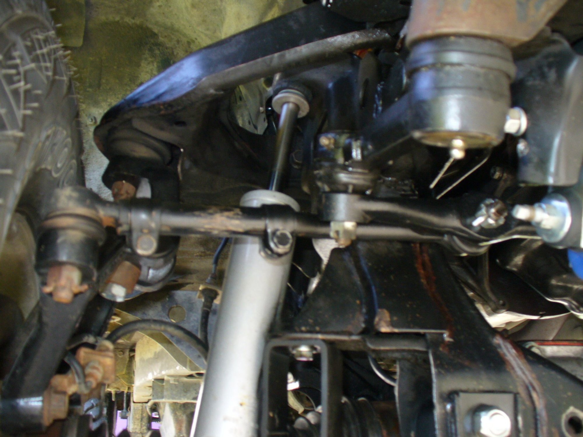

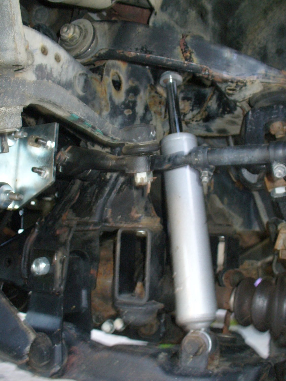

Old Aug 16, 2019 | 09:52 AM
AKZEP69's Avatar
Joined: May 2009
Posts: 58
From: KENAI- ALASKA
left side
right side

Looks like the bump stop drop block may just need to be turned around. Is the mounting hole in the middle or offset to one side? Looks like the pass side may stick out a little farther than drive side?
Its rubbing on the drop block right? Not the factory bumpstop mount?

it's rubbing on bump stop mount

I'm wondering if the drop bracket for the lower control arms isnt centered correctly, which is causing the lower control arms to be pushed more to one side
Circle takes the square!
Assuming the frame is straight it's a simple tweak of the dropbracket install and a proper alignment.
You can have perfect caster, chamber, and toe and not be centered on the frame. A 4x4 friendly alignment shop might have pointed this out for you. A shop that does four wheel alignment has the tools to tell you your track is off.
