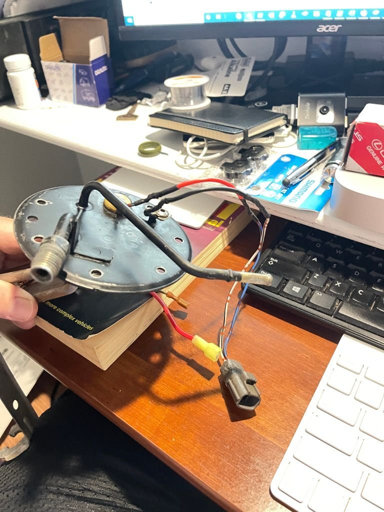

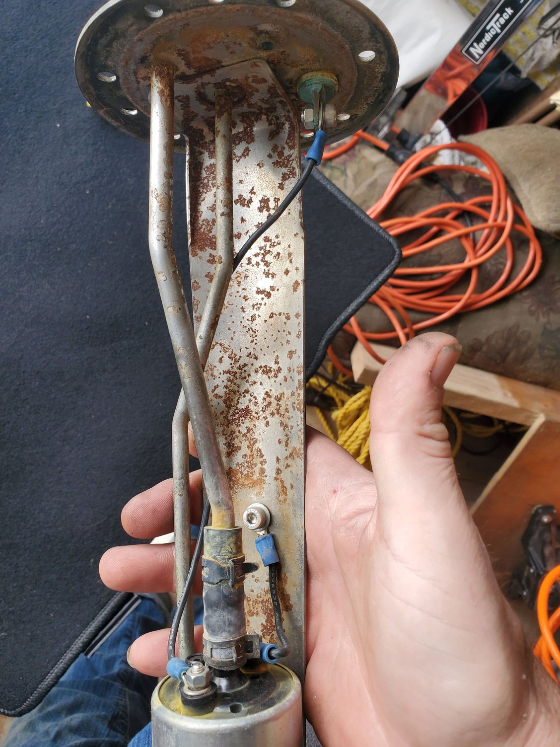

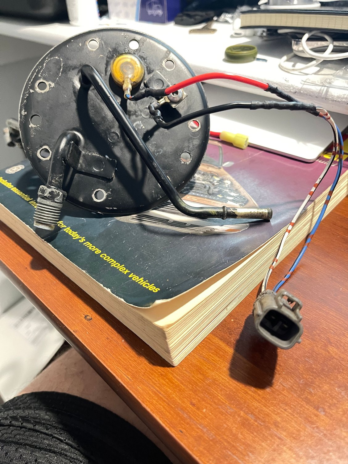

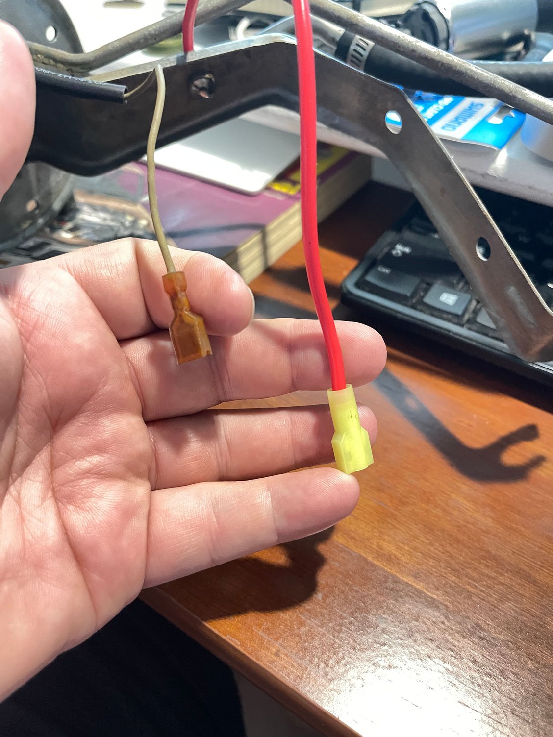

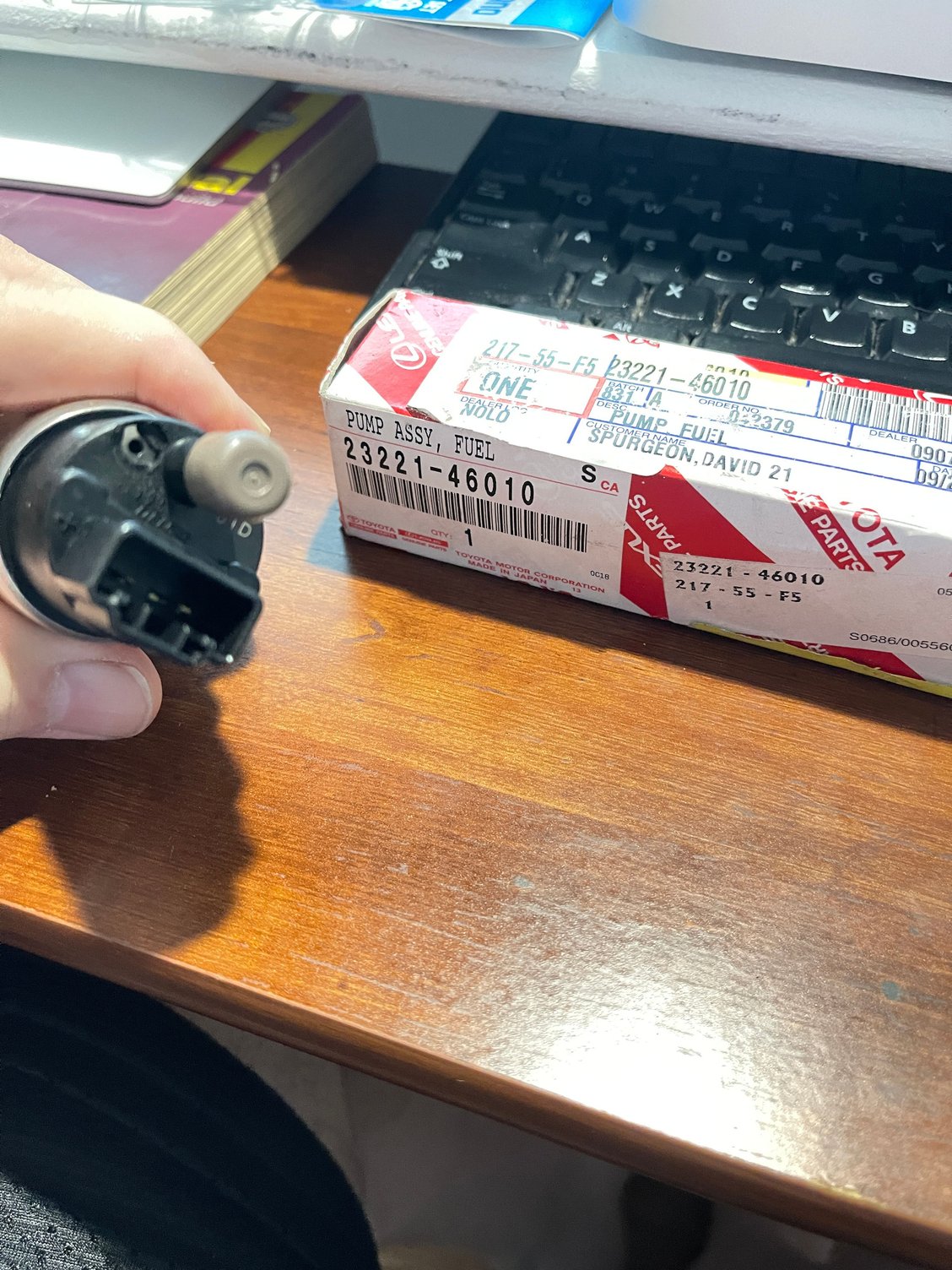

What is the part number for a 2 tube round topped fuel hanger that will have the plug to fit the 23221-46010 pump I bought? Or would I be better off ordering a different pump? The wiring on this old hanger is pretty janky. pics of new fuel pump and old hanger.
I recently bought a 1992 Toyota pickup. Ext cab, 22RE, automatic, RWD, shortbed. When I got it the fuel gauge was not working. I took off the bed and pulled the sending unit and it was all rusted up. Looking at the tank, it was a mess as well, so I decided that while I had it open I would replace everything.
I got my new tank and sending unit, I have replaced all the rubber hoses that I can get my hands on. Where I am struggling is with the fuel pump and hanger. I cleaned up the hanger I had and thought I might be able to reuse it. I ordered the oem fuel pump 23221-46010. Got it in today, but it has a plug in top and the hanger that I have has blade type connectors. I need help figuring out what hanger I need to order or is there a different pump I should order. any help would be appreciated.

I had one of those small connector style pumps and it didn't last long. When I replaced it, I did so with a lug style pump.
I drilled all the rivets out to remove and replace the wires with eyelets. I'm currently fabricating some wires with soldered eyelets.
I plan on soldering the eyelets.
