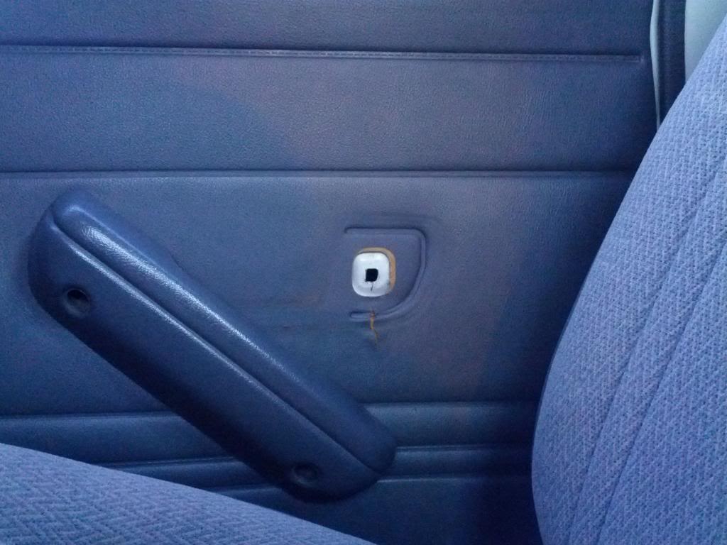

Can't figure out what the clip is called that goes into the door frame that the armrest screws into, any help would be greatly appreciated.
The guy who owned it before me had jimmied it somehow and one day the screws came out and ripped the upholstery so I'd like to secure it this time so it can be used again. Been searching ebay and google up and down but can't find what I need.

Are you just talking about the plastic insert? You would probably be able to find something that would work (or modified to work) at your local hardware store. If not, dealership.

Yes it was a little plastic piece that just clipped in to the square hole to hold the armrest to the door via a screw. Looked around a hardware store couldn't find anything that I could make fit and the dealership keeps sending me the part # for the whole assembly which was around $50 per side and I know that has got to be the wrong part.

Appears you're looking for part no. 90189-06045 (screw grommet qty. 4) which has been replaced by part no. 67771-37020 about $2.34 each.

My local O'Reilly's has a display from Dorman that has a wide variety of "nylon nuts." http://www.dormanproducts.com/catalo...ec20_Part5.pdf Use a caliper to carefully measure the size of the hole you're filling.
Part number is still available here: http://www.toyotapartsoverstock.com/...018906045.html

Awesome thanks a bunch!
