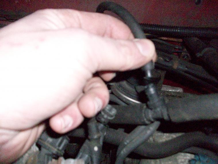

Ok this is a tough one to explain. There is a hose that comes off a bow in front, ya know what? I have a camera Im gonna take a pic. I think this might be it. hold on a sec

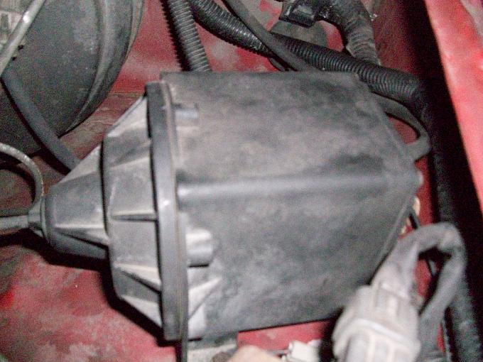

Ok this hose comes from a box in front of the power steering reservoir. And it goes to the EFI system. Could this be the reason my baby aint gettin gas?? I was checking the hoses and this thing fell right apart. Friggin plastic!

it might be. ill look at the manual myself
toyotas need their vacuum lines otherwise they dont run right so there is a good chance that might be ONE problem
did you pull a gas line near the throttle body ? see if your getting gas to it ?
