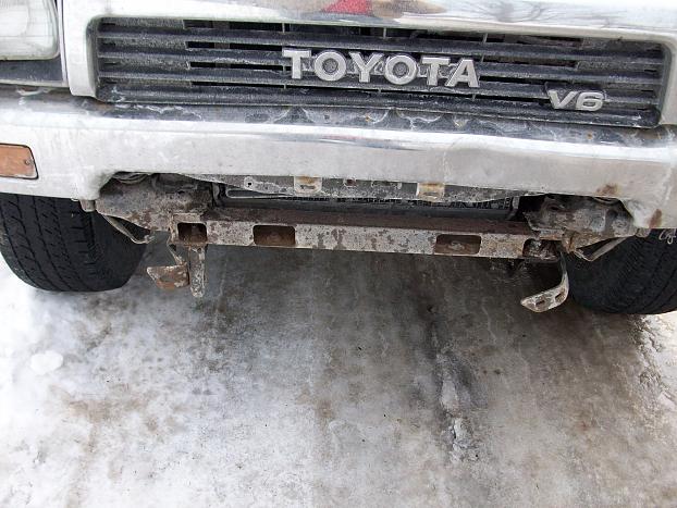

p.s. I'll be posting pics of my stock, rusted to hell, project/ DD 90 runner soon. I need suggestions on what I should do to it. The guy who sold it to me ( for $800 ) got hammered and ran into something and the bumper mounts are screwed. And not to mention the rust all over. Its gonna take some work for sure!

If you sign up with Photobucket they give you nice big pics instead of the thumbnails. If I were you I would just get some brackets of a different vehicle, if you try to heat those and bend them you'll wind up weakening them I would think. Just get an impact, PB blaster, and maybe a tourch and get those off.

also, you have a V6 emblem on your grille and a 22r 4cyl? Previous owener might have replaced that to?

LOL yeah he had to replace the grille too. Yanked one off a v6. come to think of it, thats a great excuse to buy a 6cyl and throw it in there.

No no no, I would just take the V6 emblem off the girlle and keep the 22r. Like Dominos oven baked sandwiches, 22r's are preferred 2-1.
