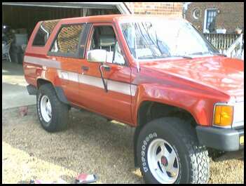

LITLRED, I hear ya....same deal here. Previous owner said the engine was knocking a little when he shut it off and had it towed....so I was thinking turn the crank maybe and throw some rod bearings in just to get me by for now. Don't know how my friend and I missed the hole in the block with the rod sticking out......but we did. In my defense it's on the driverside under the manifold so we didn't see it until I had it home and pulled back the inner fender liner and looked around with a flashlight. The engine did turn over by hand without any weird noises....oh well, only paid $450 for it with new tires/wheels, good interior and NO rust.
It has some dings and needs some TLC but over all a good project truck and will be a great hunting/wheeling vehicle. The driverside door and tailgate are blue and from another vehicle...but in great shape so I will just scuff them up and throw some red paint on them.
