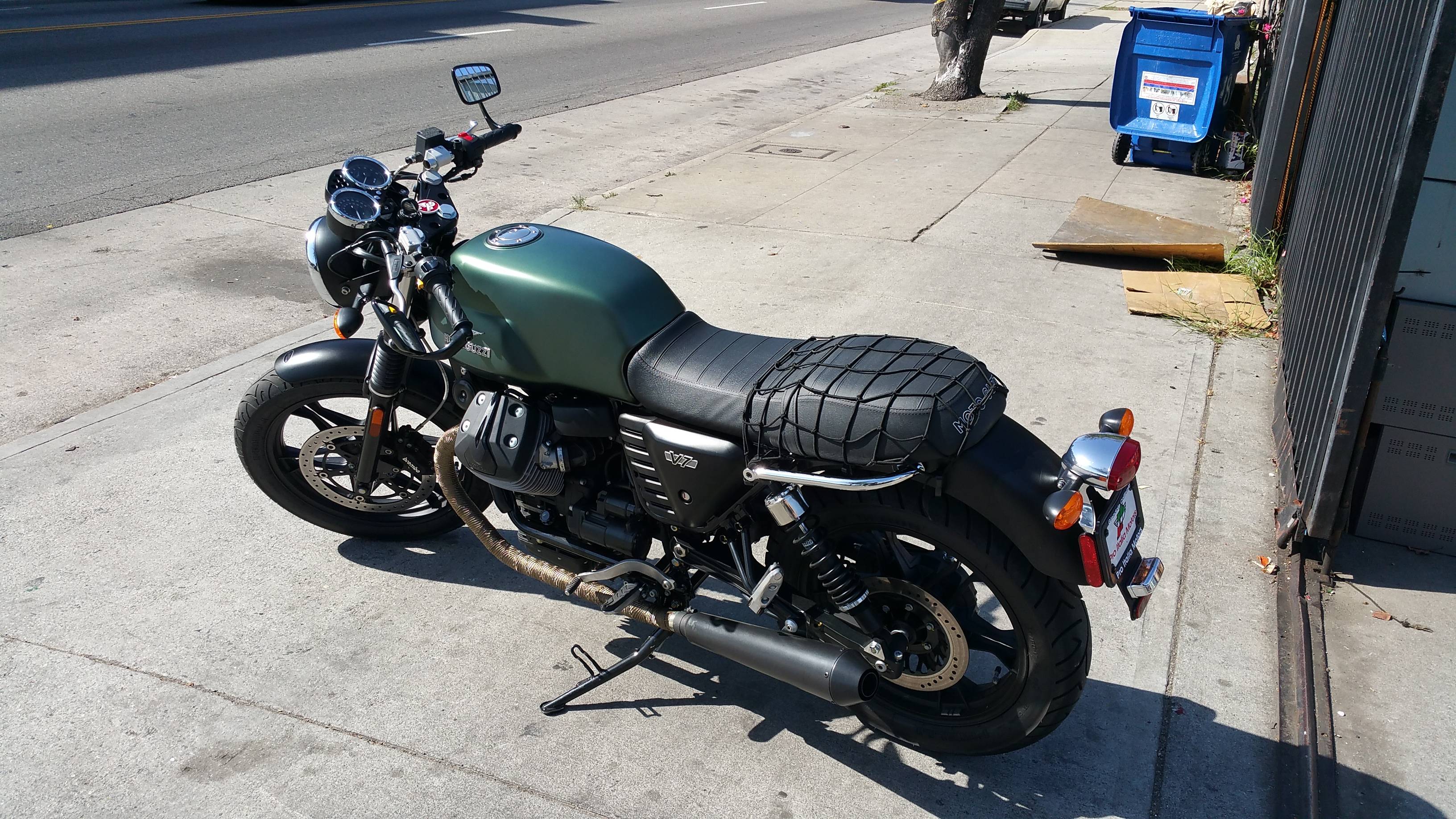

Oh and the pic of my new guzzi, as promised

Welcome back Jgirl.
It does sound like that head is gunna be coming off for a repair or replacement.
Nice bike!
You don't have to explain your disappearance when it comes to feeding the addiction for two wheels!

Odin- sweet pic! And thanks for the welcome back
