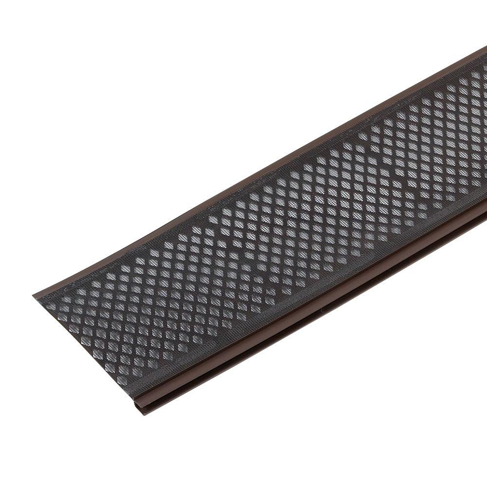

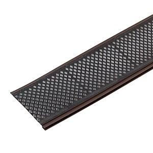

The grille on the cowl is poor design. It let's thin / slender leaves / debris in, then those get trapped at the drain. I plan to install plastic gutter screen (Amerimax brand from Home Depot, attached) right below the grille.
