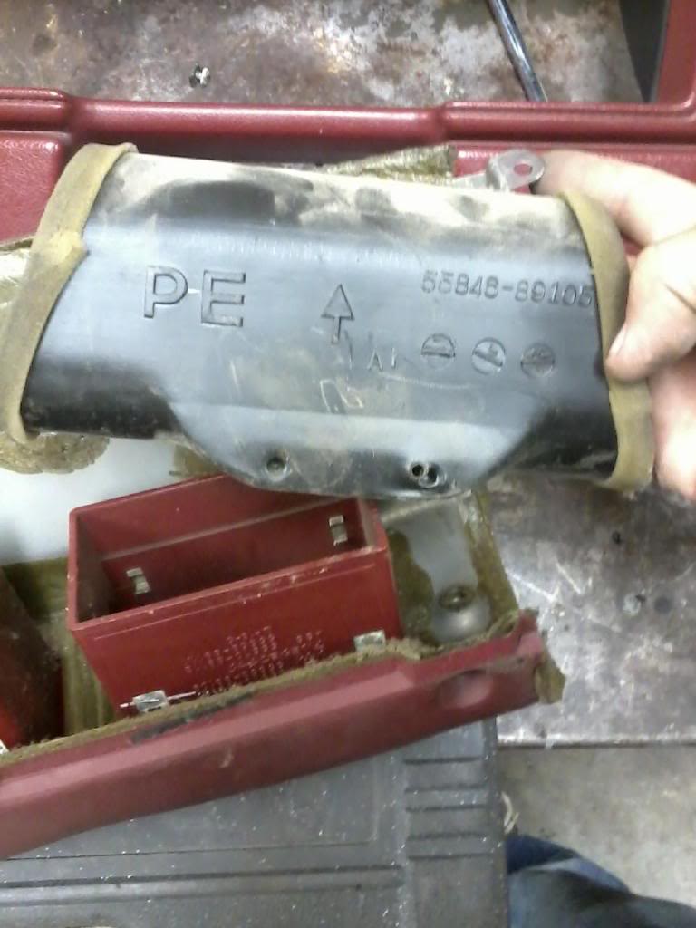

Since you are going to replace the heater core, I remove the entire dash assembly to repair or replace the heater controls. I then take paint or a marker and on the metal part of the dash support and other areas, I mark it so as I know where the cables go back.
While you have the dash out, I suggest removing the blower assembly and getting all of the trash out of the cowl area. Removing the windshield cowl will help get to a lot of the debris that is in there. Wash all of the ventilation pipes out as they will be dusty/muddy. They get dirty and gives a fresher smell in the truck.
With the blower assembly out of the way, is a good time to clean the trash that made its way from the blower into the condenser.
Here is a link with a little more info>>> https://www.yotatech.com/forums/f199...l#post52002149
I am currently replacing my dash pad and will update my post on this as I go. It is fairly easy once you know the steps.
1.Remove Speedometer Bezel and there is a 10 mm nut that holds the left side of the dash pad in.
2. Take out the far right vent on passenger side. Mine cracked bad as it was brittle.There is another 10mm nut that holds the right side of the dash pad in.
3.Take out the glove box. 2 screws at the bottom, holds the glove box in. There is a black strip that has a cover attached to it. Just take a flat blade screwdriver and pop out the little tabs.
4. I will get a picture below but there is a little screw that holds part of the ventilation pipe in. Take the screw out and slide the 4-5inch vent pipe out of the way(first picture). Straight above it, there is another 10mm nut that has to be removed.
5.You have 5 screws at the bottom of the dash pad that you have to take out and it is done.
With the dash pad out of the way, it makes it easier to work on the heater control assembly. Mine is broken and it is still a pain to get to.
Notes for myself.
Black cable goes below heater core.
White/clear cable goes along top of dash to right side.
Blue cable goes to assembly under hood through firewall.
Great link to dash pad removal. https://www.yotatech.com/forums/f115...emoval-189633/
Great Thread by nvdesertrunner. https://www.yotatech.com/forums/f115...emoval-263039/
Duct that needs removed to get the center nut of dash pad. Once you remove it, straight up is the nut.

Youtube video I found that might help some.
Video I made to get the passenger vent out.
Video to get the PE pipe out and the center dash pad nut.
