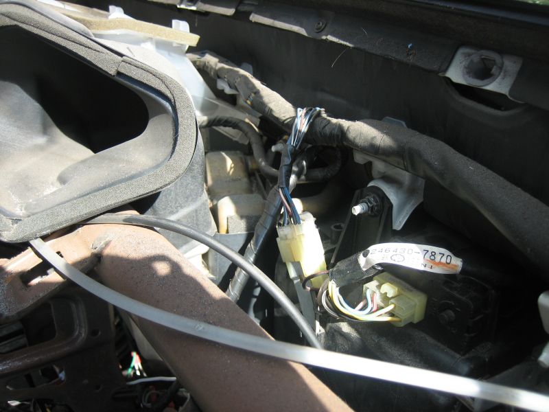

Got that itch today to dig into replacing my heater core
Man I tell ya, them Japanese didn't want these dashes falling apart, lol.
Started at about 1pm, and by about 4:30, I was installing the new core and reassembling
The new core's in, and I've reinstalled the support bar, so tomorrow I just have to put the rest of the dash back in, then go under the hood and hook up the hoses, and I'll have heat again!
So here's the inside of my truck, laying on the garage floor, lmao

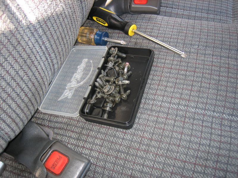

pile-O-screws

get all that crap outta the way, and you can start to get to it
a little wiggling, and removing a few more screws, and you can wiggle the box that the core is in, and get it to pull out far enough to remove the core no need to depressurize the AC system!

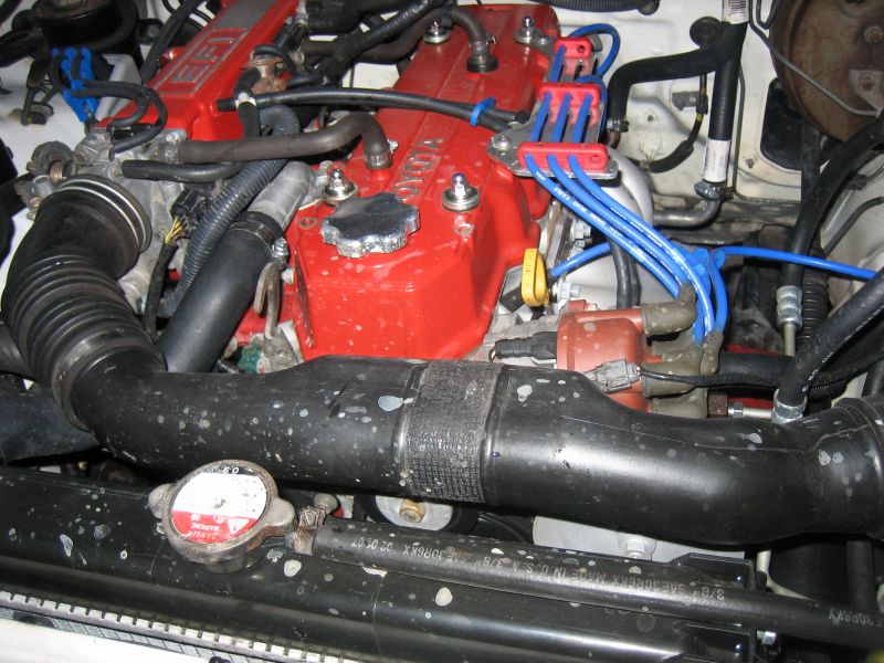

nice and neat, new hoses!
and yes, my motor is dirty... shame on me... went down a washed out dirt road about a week ago, and ended up hitting about 6" or so of merky water at around 35mph, and it threw it everywhere in the engine bay I just have yet to clean it up
All in all, it really wasn't as bad as I was expecting it to be. As long as you TAKE YOUR TIME, AND KEEP TRACK OF ALL THE SCREWS AND BOLTS, it's pretty straight forward. The hardest thing was getting the steering column bolted back up to the support bar, because of the way you have to lift it, slide it onto a hook-like thing, and then push it up to line up the bolts... that's intersting to do by yourself...

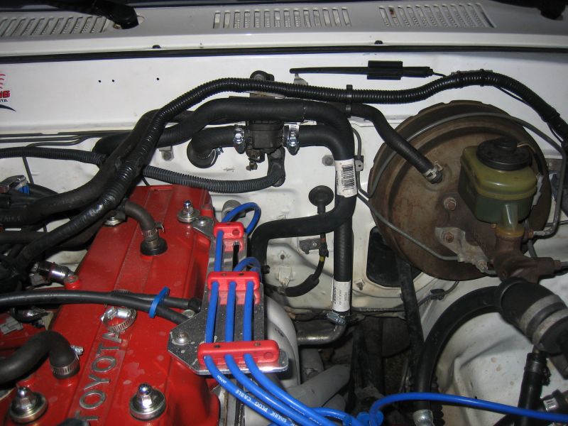

Whats wrong with you brake booster?
