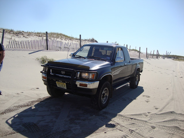

Got the H4 headlight upgrade for Christmas, it was a little bit of a pain to put in. Had to take the pushbar and grille off to get them in, but totally worth it. Looks alot cleaner with the new lights. First of many upgrades to come.

I forgot to take pictures when I was installing it. But it's really straight forward. Just watch when your taking the grille off (the clips are very fragile), you push them down and it will free the grille. Then theres 4 screws holding the headlights in. When you put the grille back on, I found that putting the clips on the grille and just pushing the grille on, is easier than trying to line up the little clips.
