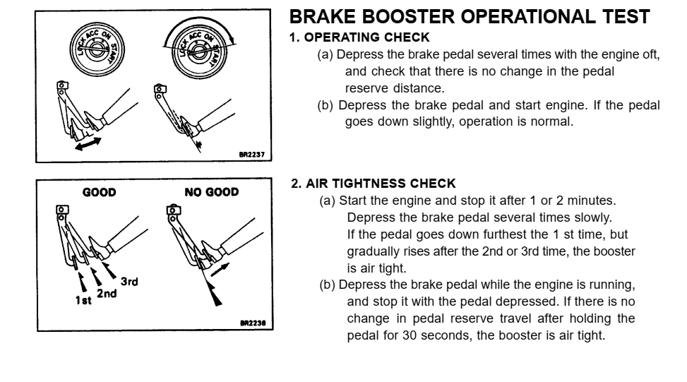

Here is how to check the Brake Booster:

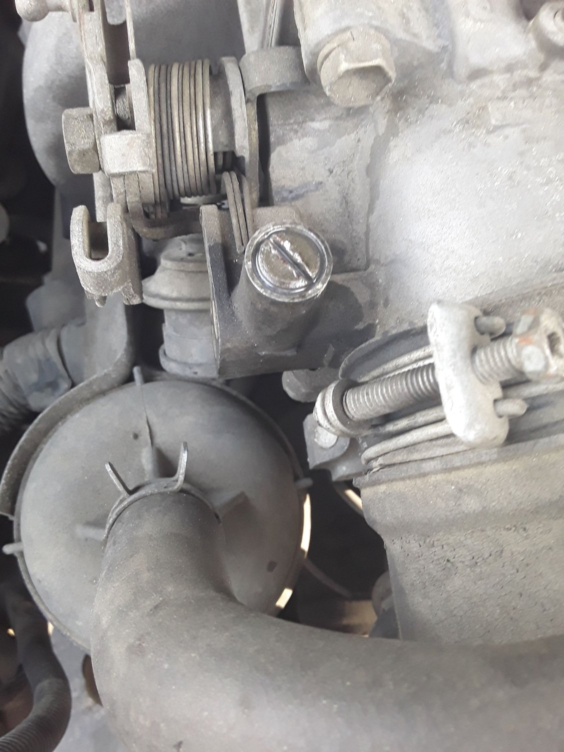

I don't mean to be insulting, and please don't take this wrong, but were you trying to turn the actual idle adjust screw, or were you trying to screw in the cover screw over it? That confused the heck outta me the first time I went to tweak on the idle, after I replaced the head...twice. Long story. I didn't realize the screw that's visible is a cover for the actual idle adjust screw.
Notice removed cover screw
Did I read the book? Of course not. Real men don't read the book until their totally stuck. Everyone knows that
Yeah, I never claimed to be the brightest bulb in the string...

If the cover is slotted and metal than it's a possibility.

Old Apr 21, 2020 | 02:37 PM

So I performed this aforementioned booster test. Everything checks out so I guess I can rule out the booster.
Thanks for the help guys...keep it coming..almost there. I'll feel relieved once I can figure out what needs to be fixed..with your help of course!

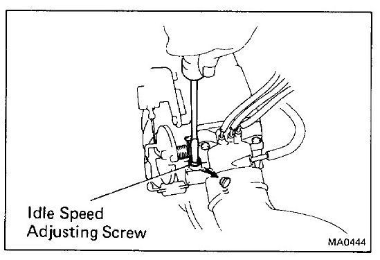

Yes, the picture above is the cover screw. Take that off to adjust the idle adjustment screw.
It's a real good idea, while in there, to pull out the idle adjust screw completely and check it's o-ring. They do deteriorate over time, and start leaking air around them. Changes the idle.
Pull the cover screw, and try to screw the idle adjust screw down until it stops. COUNT the turns you get it to make as you do, and then remove it. It's usually best to just replace the o-ring. They're cheap, and readily available all over the place. Auto parts stores, hardware stores, etc.
Put the screw back in with the new o-ring on it, and screw it down until it stops, then back it out to where it was before. It's just a starting point, and can be adjusted to set the idle correctly. I think you need 800 RPM for your particular truck, but I may well be wrong on that.
A little trick I found that helps the o-ring seal better, last longer, and screw in or out more easily, is to rub a little Vaseline onto it. A very slight layer. Only enough to coat the rubber entirely. Just a thought.
If the idle adjust screw is already down all the way, you may have another problem like IACV, or the o-ring gone bad and leaking air around it.
Good luck to you!
Pat☺

Its not coming out like it's a cover. There's no way to grab it anyway. It's also threaded. Are you sure a cover is threaded?

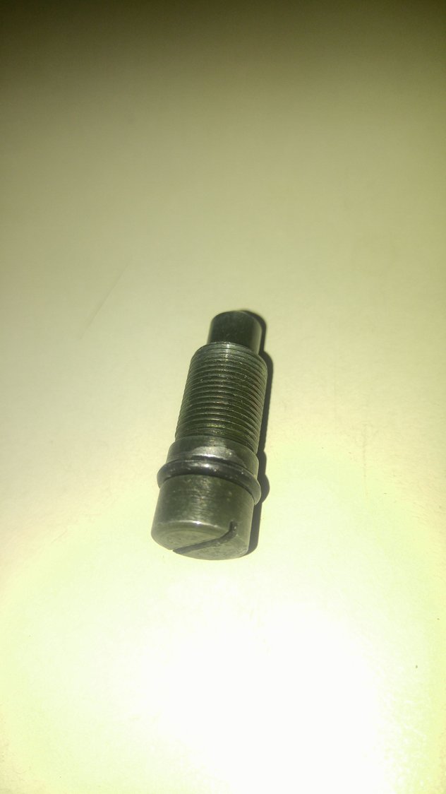

I don't have a cover on mine and there is no way a cover would screw in since the adjustment screw is pretty flush with the opening.
Here is a pic of the screw, looks like the one you are trying to remove...
