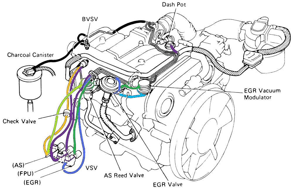

Fuel line isn't holding pressure, you can test that at the regulator(it won't be a lot of fun to get at without pulling the plenum, but it's doable). Maybe a wrong vacuum line hook up, or a loose fuel connection sucking air(remember air fits where fluid doesn't).
Here is a vacuum map I colored thelines to make tracing easier.

Ok so I just went out and started it, and it idled at about 1800 for a bit then it dropped back down to a normal idle. Which leads me to believe that the csi and switch are working properly. I checked over the vacuum lines before I started it, and they are all hooked up properly. I also checked the gas cap, which when opened had no vacuum. That has always had vacuum when opened. Wondering if it just wasnt closed tightly.
