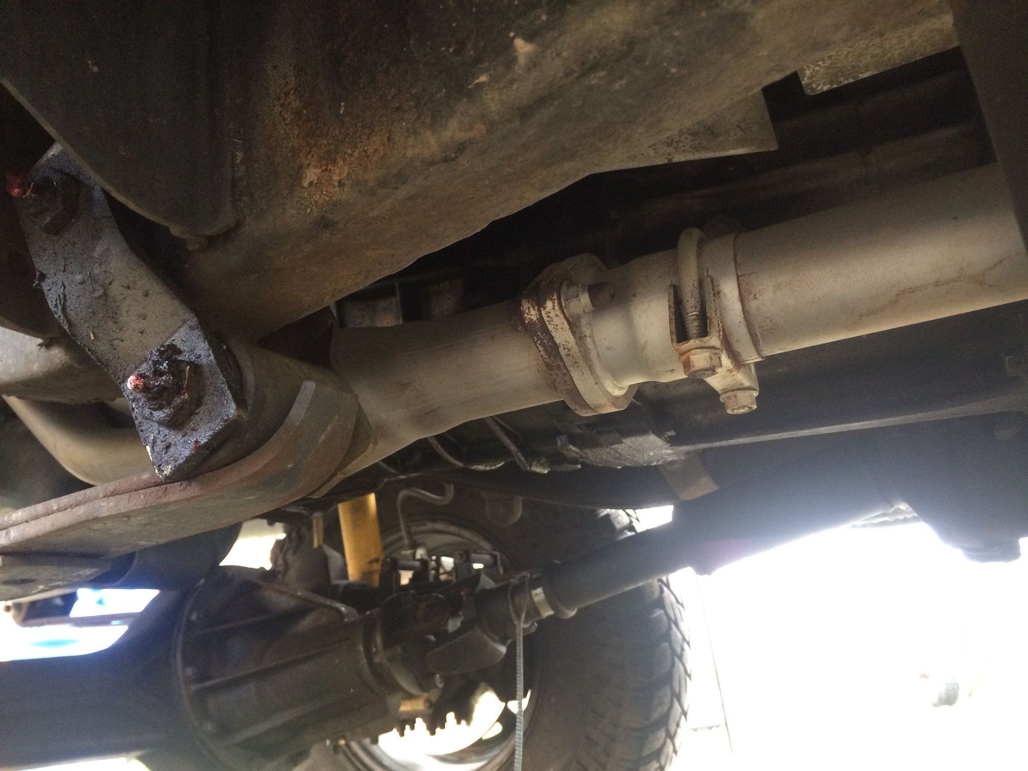

I'm referring to the splines in the slip yoke of driveshaft connecting the transfer case to the front differential--see attached photo, I've placed a wire handle on the slip yoke. I'm with RJR as far as how to eliminate driveshaft as the culprit. Could be the slip yoke, could be balance, could be U-Joints (U-joint problems are probably the most common). If problem persists with driveshaft out and hubs locked, the problem is in the front diff / axle, but it sounds like you've replaced most of what can go wrong up there. Also, if problem only happens in 4H and not at the same speed (25 mph) in 4L, then I don't think it is the axle or driveshaft. That would have to be a problem with the t-case I think.
