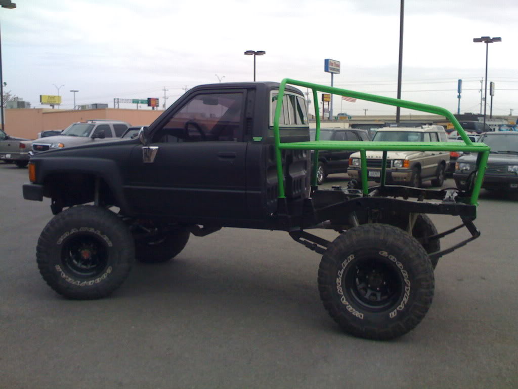

Try the hanger flush...dont burn it but tac it. It took me 3 times to get the angle i wanted for my 4inch leafs. TG says the shackle should be straight up and down with the weight on it and once the leafs brake in then you will get about 15degrees. I started kicked back about 10-15 so i get a little more of an angle. I was always told 30degrees is about perfect so im shooting for 25-30 all said and done.
When i mounted the hanger for the front i had to burn the shackle tube farther forwad because of how far i pushed the axle forward.
Mine will move back and everything will go back once the motor/interior/body parts all go back on but its a pic for motivation
