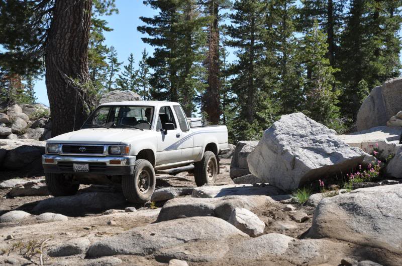

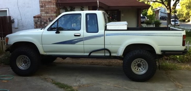

I have a 93 xcab that I put OME leafs on about 5yrs ago. I used the medium duty (19r) and kept my stock shackles because I wasn't sure about the height, since nobody could give me a straight answer regarding the resulting height of an OME lifted truck. Kinda glad I kept stock shackles, at least in the beginning, since the truck was significantly higher than it was with saggy butt - like 4"+!!!
After it all settled the height was perfect, but then I added 33x12.5s and had to raise the front slightly. I also did a ubolt flip, triangulated my rear shocks, and removed the rear bump stop - so now the tire barely kisses the rear fender at full stuff. My ride height is 22.5" on all 4 corners, from center of axle to bottom of the fenders - so I guess that's level or ever so slightly raked forward (since I think the fenders are different heights like the previous gen trucks, but not quite as much difference). In regards to new shackles, I think I'm finally ready to get some - but not very long because I want to only be maybe 0.5-1" higher in rear, just to clear the tires at full stuff and to keep more level bed when I have over 1000lbs loaded up.

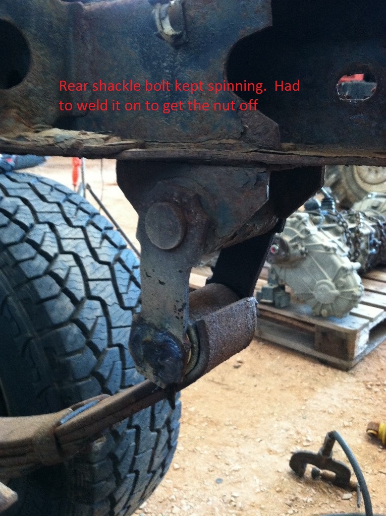

well they're made for a stock truck's mounting points, so I dunno what to say. I'd be more worried about that rust I see in the pic! I can try and snap some pics of my shackle angle if you like. Stock shackle bolts are simply pressed in, with splines.
BTW - wtf is that clamp in the picture? some sort of hydraulic c-clamp?

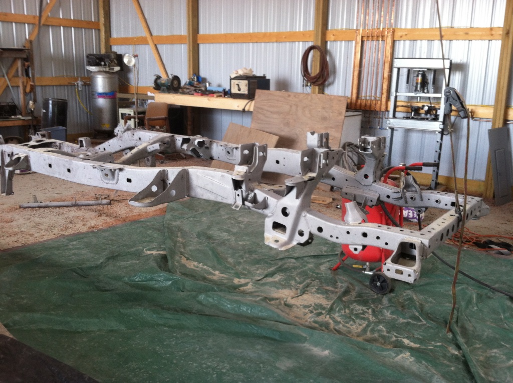

Rust... what rust? Actually I'm in the process of rebuilding. Made a thread for the process but here's my frame blasted... Had a mishap with paint so gonna reblast and reshoot. The clamp in the pic is a ground for the welder. I had to cut the tube cross member out and weld a new one in it's place. Began rusting through in a spot... You can see the old one laying on the ground in the pic from below
