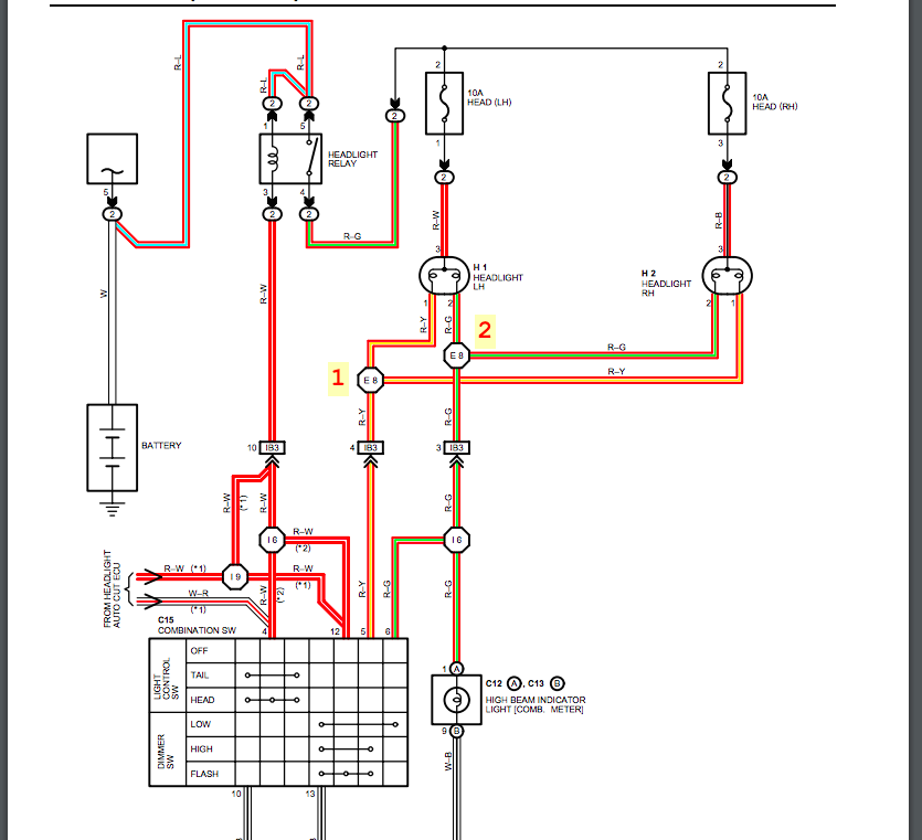

Hey folks, I'm about to replace headlight bulbs after sinking the front end of my truck in a puddle and I'm hoping that y'all can help me find a solution for my dilemma.
9004s SUCK at throwing any good light down the road. Older 4Runners with their sealed beams have some great solutions it seems, but I have a 1993 with interchangeable bulbs and housing.
Is there a good NON-HID solution? I was thinking of a H4 harness kit but won't I have to upgrade my housings?

... I was thinking of a H4 harness kit but won't I have to upgrade my housings?
Yes the harness is an essential retrofit that would surely help minimize power loss on the "convoluted path" the power takes to get to the bulbs. It will also help extend the life of your dimmer-combo stalk switch.
No need to change your housing. You can either:
1) Make your own harness using the proper 9004 connector to mate with your choice of bulbs (
Amazon Amazon
), OR
2) Buy harness online with 9004 connector, OR
3) Buy H4 conversion harness and replace the H4 connector with one for your bulb.

https://www.amazon.com/Headlight-Con.../dp/B002MVETKM
1) Make your own harness using the proper 9004 connector to mate with your choice of bulbs (https://www.amazon.com/Headlight-Con.../dp/B002MVETKM), OR
Wow! Great link. I saw a harness earlier but now I'm wondering how difficult it would be to make my own. Thanks RAD!
