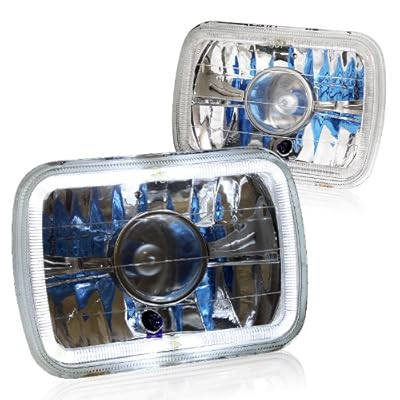

I'm new to the yota scene and I'm waiting to put H.I.D. headlights on my 89 pickup are there places on the internet to find them? Or will they even work with this year? I havent really checked into them very much but if any of yall on here knows anything about where i could find them or if they will work or not let me know please

going to have to custom make them. Sigep4runner did it.
https://www.yotatech.com/forums/f105...ro-kit-186175/
If you want ones already made for you........
http://www.brightheadlights-hid.com/...ire-Trucks.htm
Good luck with that one.

REAL HID housings for $65?? Or the one with the crappy looking glass in the middle that doesn't give you a cut off line?? I hope you don't mean this garbage that would blind people if you put HID's in them??

Either do real HID's with projectors, or upgrade your harness and/or alternator and use good halogens. Blinding people is irresponsible. Not everyone has good night vision. They don't need to deal with that.

I would buy autopals kit off ebay. Its housings with no built in bulb and buy a name brand H4 HID kit. Be prepared to get flashed thou.

ya dont put a hid kit in just run nice h4 conversion headlight

I agree with Tyler. And Elton. If done right, HID's are good light.
But I also bought the autopal kit and got a harness from 4crawler.

would the housings be good like kiyobrown mentioned? What all does the autopal kit come with? what is it?

haha no my housings aren't that crappy but they aren't the best...I got the an adapter and housing for that and they aren't blindingly bright but close.
