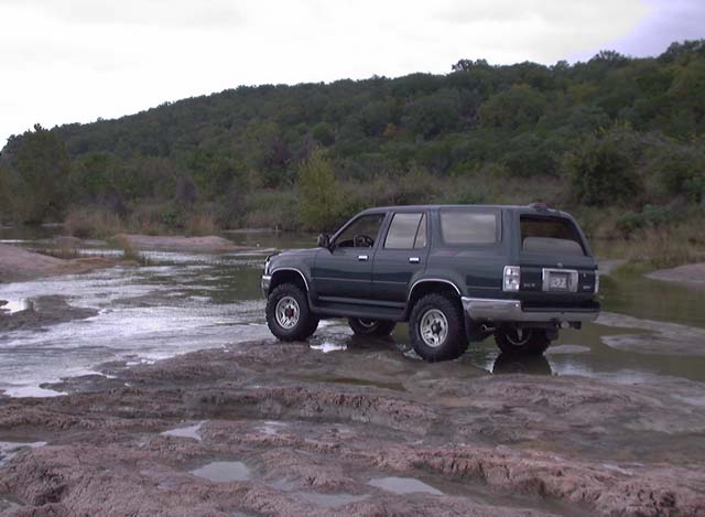

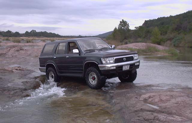

I doubt your t-bars are adjusted up, when you bring the rear up it will level out. Most owners would not adjust the front up when the rear is sagging and with it kept stock I highly doubt the front was ever messed with.
I would recommend that you not waste money on the coil spring blocks. For under $100 you can buy progressive rate coils from NAPA auto parts. I ran them and absolutely loved the improved ride and price! On the note of springs, personally I think the stock t-bars are just a little to soft for the weight of the 4runner + v6. You may look into upgrading to Sway-Away t-bars (about $100) and I hear OME also have great t-bars but for a little more money.
Get some new coils out back, adjust the front to match and then choose if you want stiffer front bars or some ball joint spacers or better....both!
Your 3vze will pull 33's just fine. I ran 32X12.50's Mickey Thompson's which ran a full 32 inches and most 33's run around 32.5-32.8 inches. I could easily cruz at 80+mph and the pedal would need not be anywhere near the floor like my poor 22re pickup. I should add that I had a 5 speed in mine.
