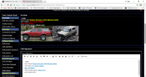

Old Sep 20, 2017 | 12:26 PM
dropzone's Avatar
Fossilized
iTrader: (6)
Joined: Oct 2005
Posts: 19,771
Likes: 456
From: PNW
go to the user CP
edit options, select signature and add your info there.
that way on future issues you already have it and don't have to remember it if you have another thread looking for help
and don't worry about it, old timers forget to give similar info
