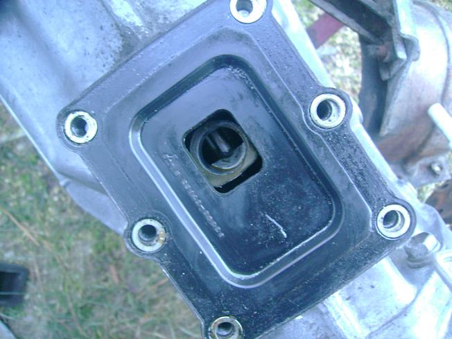

Ok, here are some pics. If you see anything wrong speak up.
Attached Thumbnails G52 to W56-dsc02440.jpg   G52 to W56-dsc02441.jpg   G52 to W56-dsc02445.jpg
Old Jan 6, 2010 | 01:36 PM
streetlancer's Avatar
Joined: Oct 2007
Posts: 800
From: VA
Here are some more. This is what i meant seems to be be missing half of the bottom but at the same time it looks factory because of clean cut. Is this right?

The hole in the bottom of the shifter looks just like mine did when I did the same swap. the shifter on the tcase looks like it might be mounted backwards? Mine looked the same though and I ended up bending the shifter tower a little so it would shift nice.
To modify the floor I cut the tunnel section of the floor out of the donor 4runner from around the shifter hole and planned to used it like a sheet metal skin over the floor pan of my truck. I ended up only using the very tip of the tunnel to cover the opening where it stuck out from under the front of the shifter. I herculined the crap out of it to cover up the patch job, but the cab was an automatic to begin with so the floor already had some 'issues'.

Well thanks for the response, maybe now i can get started on the swap. It just seemed strange to be missing half of the bottom. I was afraid it might have fallen in and on first start grind up all the gears. The one in the g52 is a full circle.
