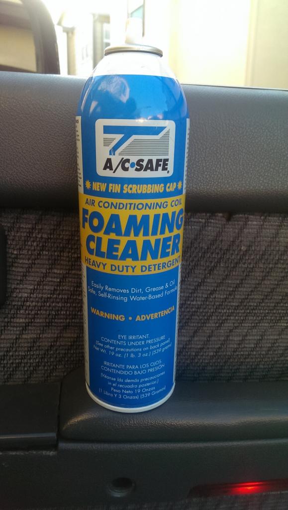

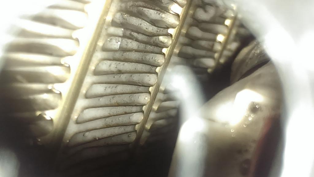

So since its been in the hundreds in sacramento. The AC has been smelling like mildew, dust, dirt, and grim thats bilt up in the evaporator. Over the year. First i thought the drain. Was pluged but it wasn't so i went to the local Auto parts store and they has nothing i was looking for but my work (Home Depot) had this stuff for cleaning house hold AC coils for $5.98 i think works great i drilled a small hole in the corner and sprayed it in there and let it sit couple times and turning the fan on low to push it throw the fins. I have to say its the best $6 i have ever spent. Its also lemon fragrance its also water based and self rinsing. Which makes it super easy to use.

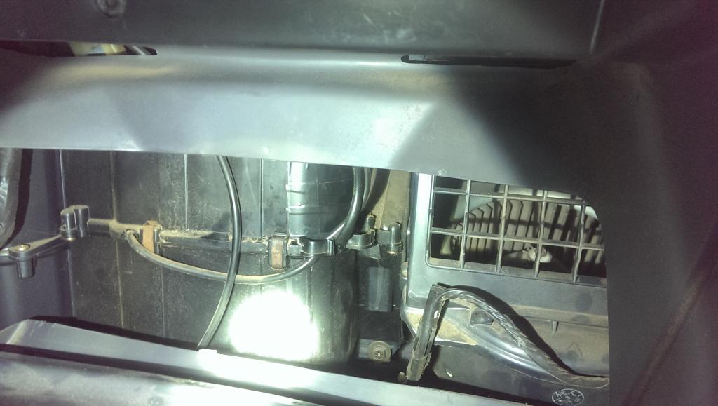

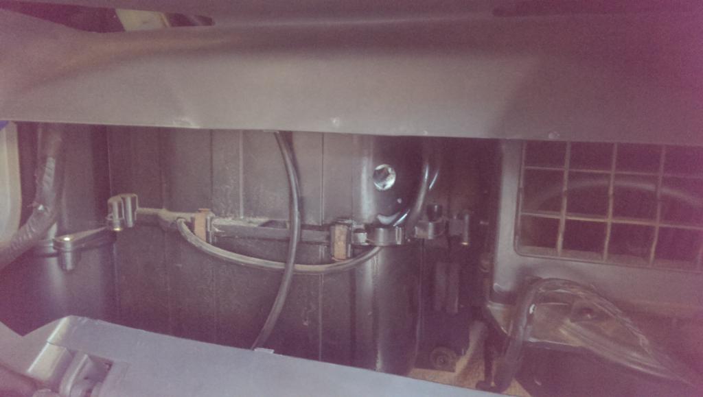

Agree with Terry. See his picture here.
The cowl cover has long openings that would let in even wide but thin leaves / pine needles.
To make matters worse, the driver's side opening enclosed in in yellow here does not have a screen.
