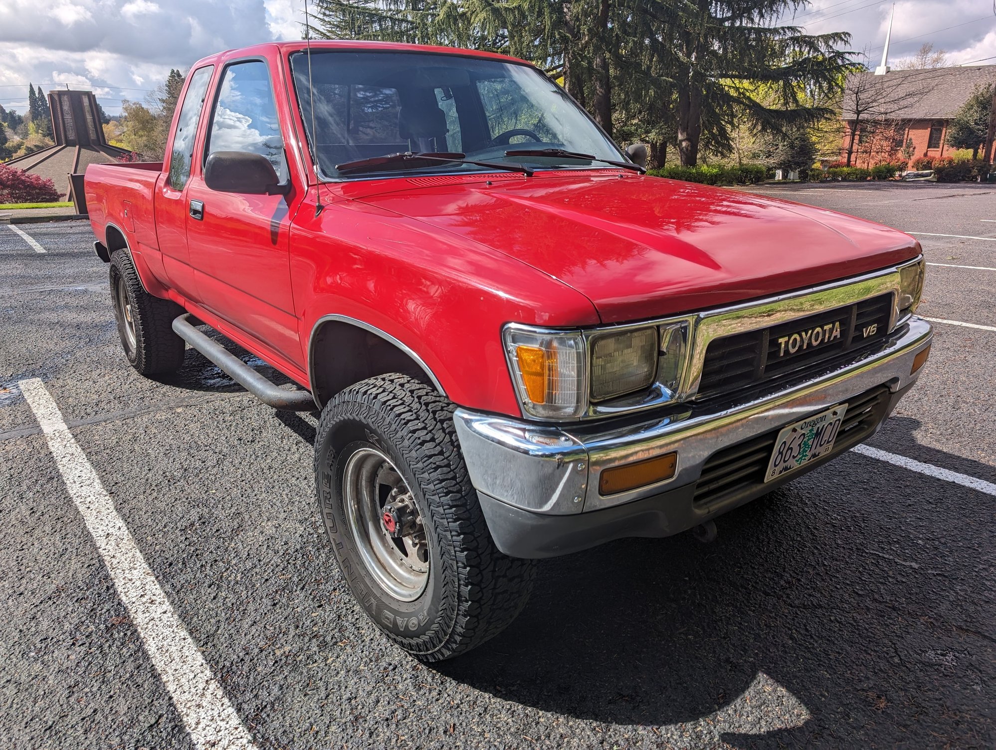

Fuel Smell in Cabin
1989, 3VZE, Auto, 4x4
When I decelerate with the windows down I get a decently strong fuel smell in the cabin. I've owned the truck since 2019 and put 7k miles on it and it has done this since I bought it.
I first thought it might be because of holes in the muffler so I replaced the exhaust. Then after researching here I thought it might be the fuel pulsation damper so I replaced that. I've also checked that the vacuum lines to the charcoal canister were clear and they were. I just dropped the tank to see if I could see any noticeable leaks or cracks in the filler neck. Nothing has worked so far.
An interesting detail. If I fully tighten the fuel cap and drive up a long steep hill the engine will die from fuel starvation. I can get out and crack the cap and hear a strong vacuum release. I just replaced the cap with an OEM one but haven't had time to test if this is still the case but the fuel smell persists.
TIA
