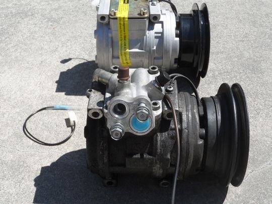

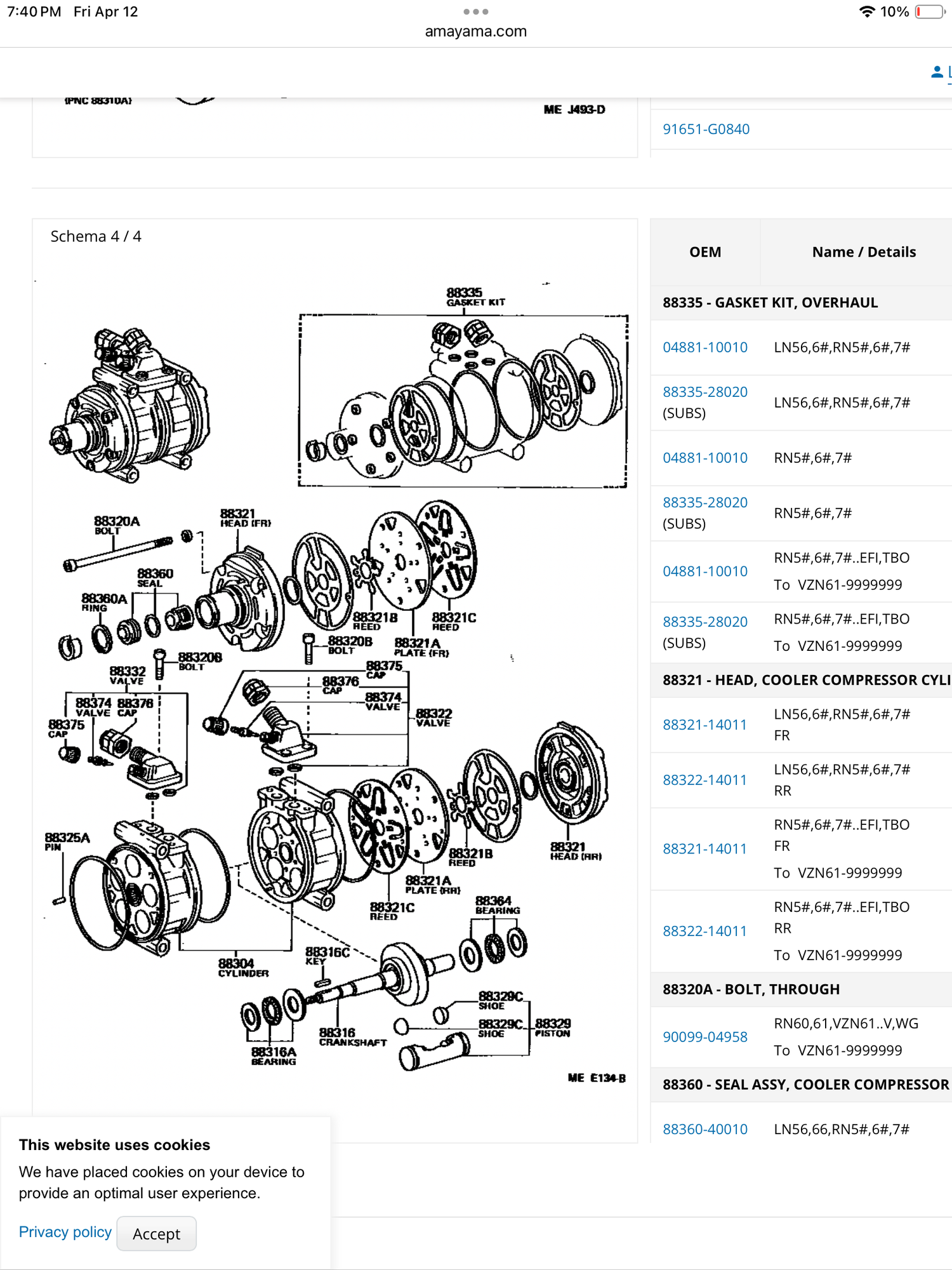

Well, if you do decide to switch out your compressor I'd recommend keeping your old one. At the very least, keep the charge plates(service valves) that the pressure lines connect to. Those are gold these days. And reman units don't include them.

What’s a charge plate? I know what a compressor is.

I believe he's referring to the adapter to which the high and low pressure hoses connect. As Jimkola says, the replacement compressors don't have them.

Yeah, 88322 and 88332
