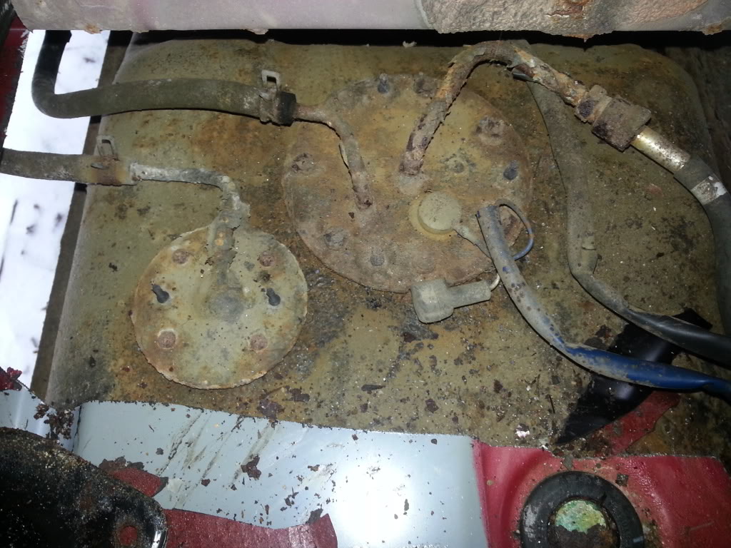

Well this is from my 85 22re 4runner.
this is from my 3.0 95' 4runner

ok well I went to take it out of the 95 and all the screws are completey seized in there. That ends my adventure. I don't really want to cut them out with fuel in the tank in the freezing cold as its snowing out.
I am still curious though if pumps are same. I don't believe part number matches up when I look online but when I go to store tmrw ill get one for each model and see how they compare.

Pretty sure the pumps are the same. The brackets look similar too.
