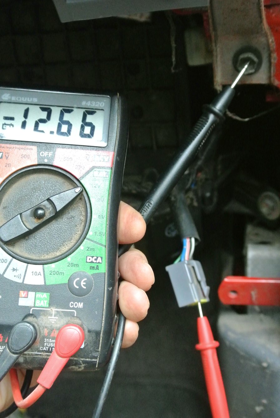

1994 Pickup, parked and will not start, would almost catch then die, now won't catch.
I checked out some threads here, especially one listed at bottom, good info but didn't specify action when there is no continuity between the B+ and FP wiring to the Circuit Open Relay. I'm getting 12.6V when B+ is grounded to chassis, but 0 when it's connected to FP, regardless of key position. Just want to make sure I'm chasing the right thing before proceeding: does this mean there's a break in a wire to the fuel pump, or a break inside the fuel pump, or something else?
I get the same results at the Diagnostics port.
Thank you

B+ is, uh, B+ (~12v) with key-on. (This is through the EFI fuse and relay and doesn't involve the COR.)
FP is direct to the fuel pump. It should be 0v (to ground) with key-on or key-off. Remember, the COR doesn't close until the key is to STArt, or the FC pin in the VAF connects to ground, so there is no B+ connection to FP with just key-on.

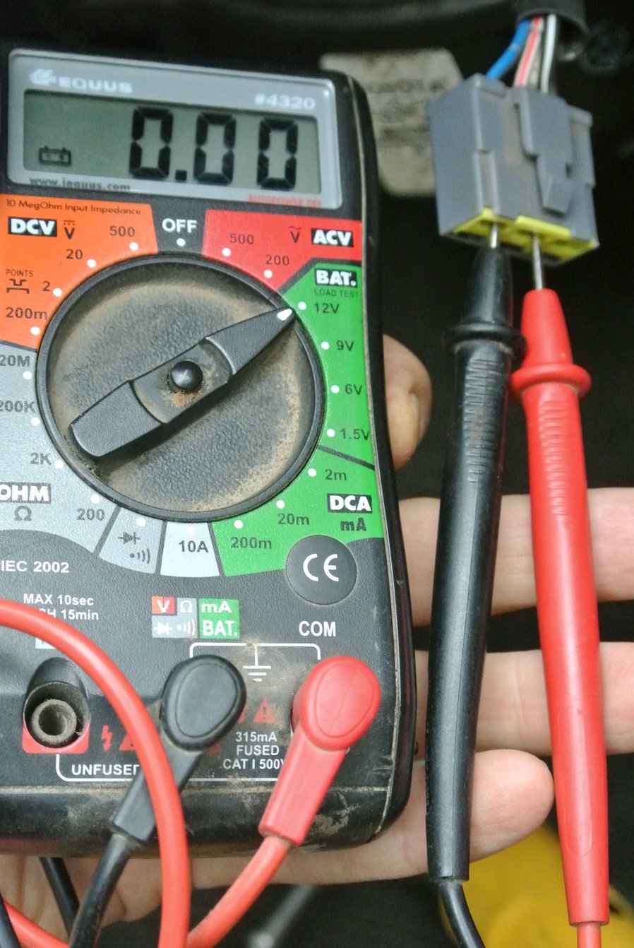

Given that, checking your situation is trivial: jumper B+ to FP. Can you hear the fuel pump running? (In my garage, I have no trouble hearing it standing at the diagnostic connector. Outdoors by the road you might need an assistant.) If not, did the EFI fuse blow? A blown fuse means FP is shorted to ground somewhere between the diagnostic connector and the pump. "Nothing" means an open in the pump (bad pump) or in the wiring.
If your last photo is with key-on, you're getting no continuity to ground through FP so the pump is bad or a wire is broken.
(Why are you using the BAT range, instead of the DCV range? I don't know your meter, but I expect that BAT puts a certain load on the circuit to look for voltage drop. Doesn't make much difference with a big-ass car battery, but why?)
Good luck!

Jumping B+ to FP doesn't start the fuel pump, that's why I:
-tested B+ to ground to make sure there was current coming to fuel pump
-tested B+ to FP to see if there was continuity to the fuel pump
Just to be clear: when jumping B+ to FP the pump will activate when the key is at 'ON' (as I doubt I would hear it over the engine starting). I read somewhere that these engine don't 'pre-pressurize' the fuel system before starting like some others, and unclear if jumping these connections changes that.
It seems we are on the same page with something wrong with the fuel pump or wiring to it.
Using BAT as I don't have much experience using these and was familiar with that.

All you need to do is check for continuity between Fp and the fuel pump hot lead. The FP pin in the diagnostic port goes straight to it.
You do not, NOT, want to check for continuity between B+ and FP. Chances are the meter will blow it's fuse instantly. If you do with the negative lead off the battery, it's safe, but will read open.
Remember, avoid using the meter in OHM reading ranges, with voltage in the system being tested. It will blow the meter. Good idea to pull the negative lead off the battery. Better idea is to pull both battery leads off before ohming any system out. Always verify the meter is fully functional before using to measure OHMs by touching the leads together. The meter should go to 0 (zero). Many meters have a fuse in the OHM circuitry to protect against such events. You may need to open the case to find it. Check the paperwork that came with the meter for more information.
B+ is directly connected to the battery, through the keyswitch's ON contacts. All you should see on it is the battery voltage reading to ground. You can check it by reading across the battery terminals, then moving the meter's + lead to the B+ pin in the diagnostic port.
If you jump B+ to Fp, and turn the key to ON, you should hear the fuel pump running. Don't turn the key to start, just to on.
A way to check 1/2 of the COR is to turn the key to STArt, but do NOT press the clutch, or clutch start cancel switch. Again, you should hear the fuel pump running while the key is held to start, but not cranking the engine. The tone of the pump will change as the fuel system pressurizes.
