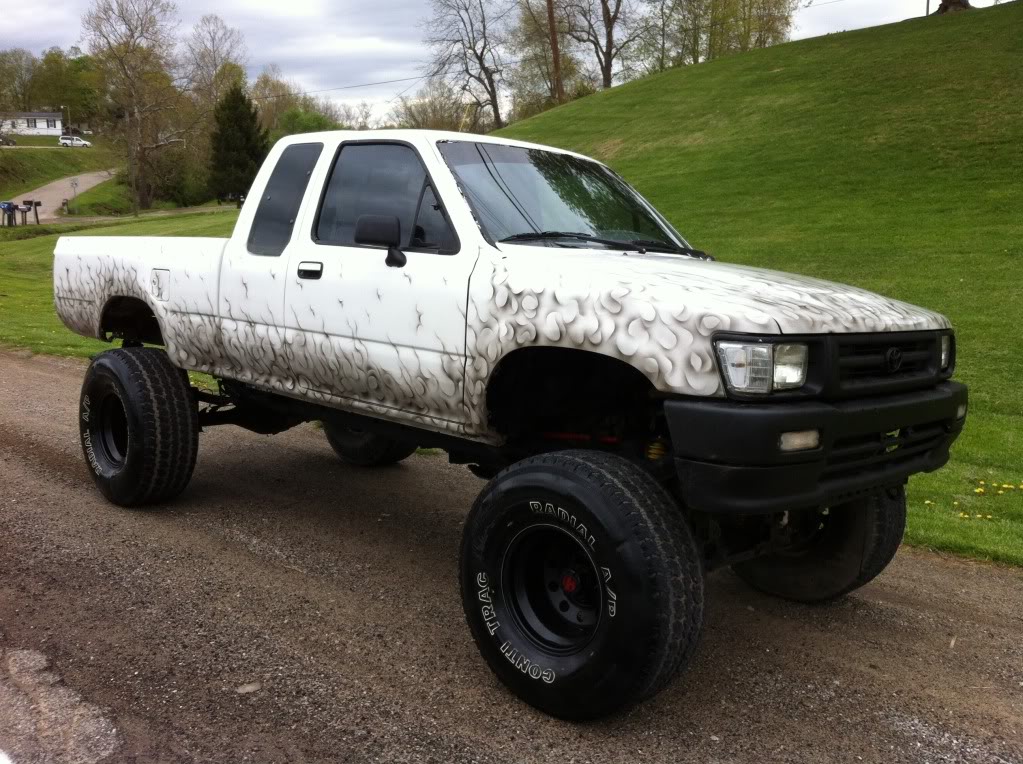

If I were to buy and resale I always add everything up. Take for instance my most recent.
1994 Toyota 4x4 extended cab 3.0
Bought for $700.00
I replaced tranny and clutch $350.00 and $149.99
Torsion bars $300.00
Alignment $39.99
And several other things $500.00
Labor at $50.00/hr. $700.00
That's roughly $2800.00
I sold the truck for $5000.00 to a boy in VA
That's a net profit of $2200.00
I'd say I was closer to making $1500.00 after I'd include all my fuel and travel time sourcing parts. However I do all work myself so technically I do not have a labor rate but I try to figure $50.00 per hour when I try to add up my profit.
Here's the truck

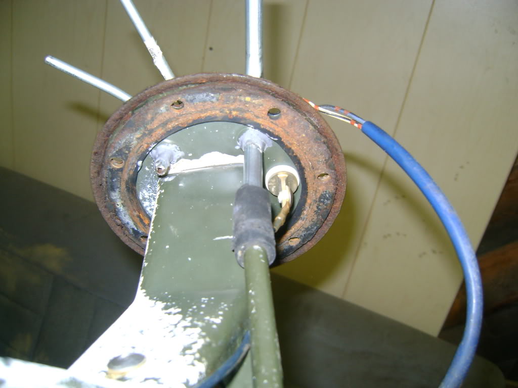

Why not just rebuild the pump bracket? I did it with 1 piece of 3/8 brake line, and 2 5/16 pieces of brake line. Plenty of threads on here about it.
ETA: I've done this on 2 runners, and 2 p/u's now.... the bracket from a p/u can be swapped for one from a runner, and visa versa.... The tanks on other hand hand dont match.
pix or it didnt happen
The jb weld was only used to help seal up any holes from the welds... I never once had a leak in 4 years of driving after this repair to my 91 p/u...
