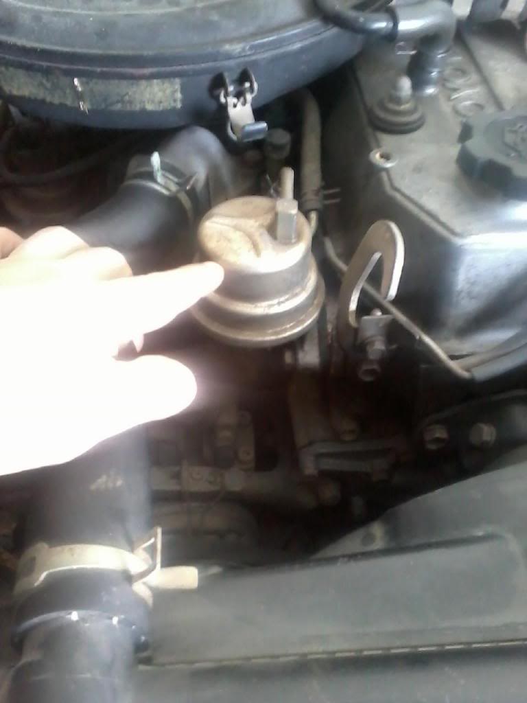

In your signature, you have 22r which is carbed, it is on the front of the motor. Fuel injection, 22re, is in tank. I wouldnt suspect the pump but carburator myself from your last comments. I dont know carbs as well so could be wrong.
Carbed pump.
