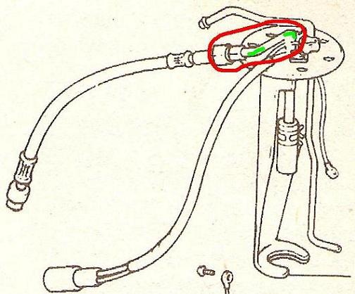

so i finally had to re-drop my tank again to properly fix what i 1/2 a$$ed fixed this past summer. i got a major fuel leak. i assumed that i knew right where it was coming from, cuz, like i said, i only 1/2 a$$ed fixed it when it was a problem this summer, and when i dropped the tank a couple inches (so i could see) and turned the engine over, i was right. i have 2 pin-hole leaks in the metal line coming off of the sending unit that turns into the flex hose that mates to the metal line that heads up front to the engine. i tried patching it with JB weld (i said i 1/2 a$$ed it!) this past summer. it held for awhile, but finally REALLY gave way about 2 weeks ago and now i can barely get enough fuel pressure to start the truck (although oddly once i get it started it runs flawlessly, despite the constant leaking of gas underneath the truck).
anyways though, i can't find my camera, so i had to scan the page out of the repair manual. what is circled in red is the portion of metal line that is leaking, the green lines are where the pinholes are located. (if i find my camera (my wife might know where it is) then i'll attach a real picture). is it possible to replace just this line? everything is pretty rusty back there. i'd prefer to just replace the entire sending unit while i'm at it. the problem is, i'm one of the millions that are unemployed right now, so money is tight. which is why if that one line can be replaced i might just do that. any thoughts?

This is a real easy fix, just get a piece of I think 3/8 brake or fuel line whatever is the same size. Also get a Ford PCV valve kit. I am not sure what it is but you can find it in the HELP section part at the parts store. It is the one with the metal line. You will need the fitting it is the same as the fuel line fitting. Just drill out your old one, bend the new tube the correct way and install it. Put some JB around the top and your good to go. I have done this many times no problem. I would recommend doing all of them as once you move them all usally something else breaks.
