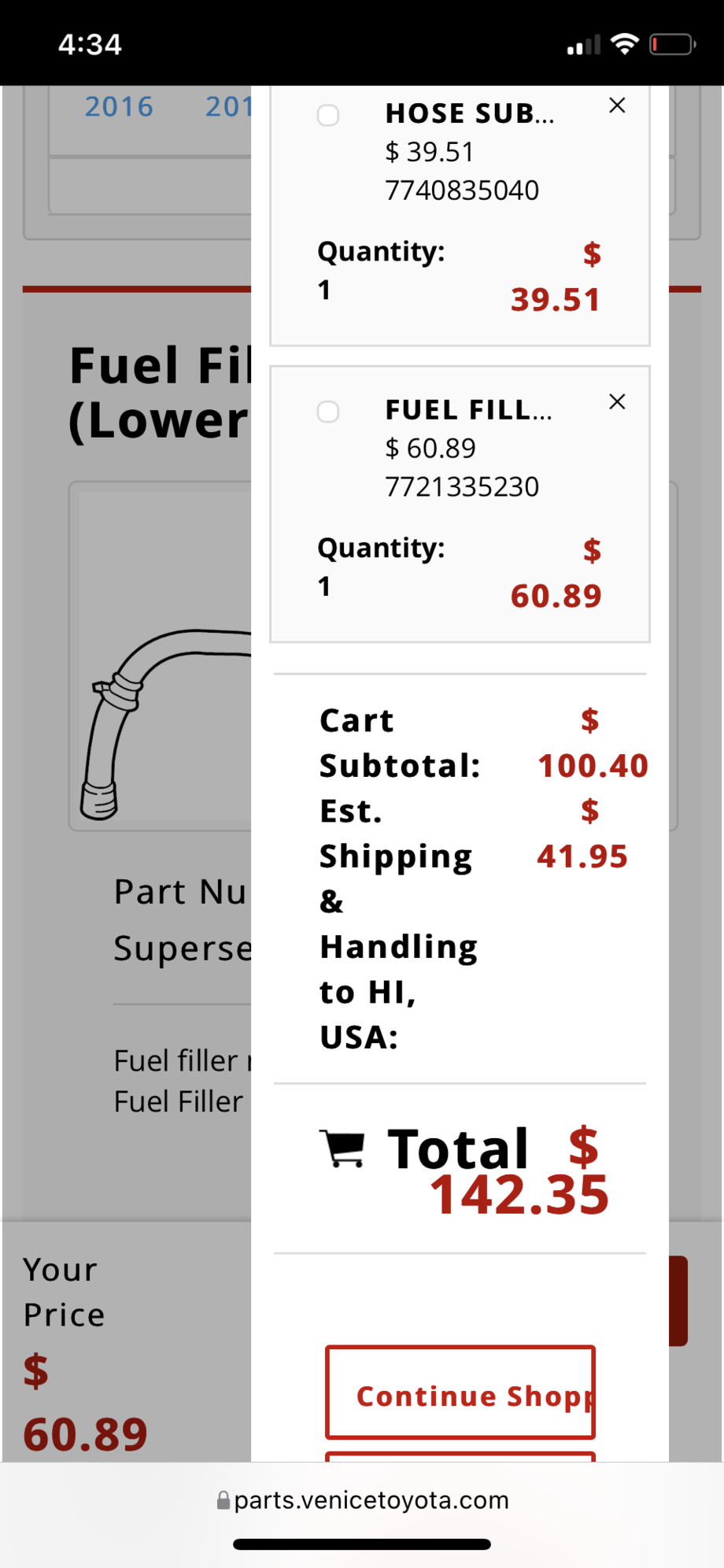

I think I found the parts but its way pricier than I was hoping. $142 shipped to hawaii. Ouch!
Yikes $48 shipping!

Maybe not so pricey for another 20-30 years of service, which we all know these trucks can do. That's $7 a year or less.

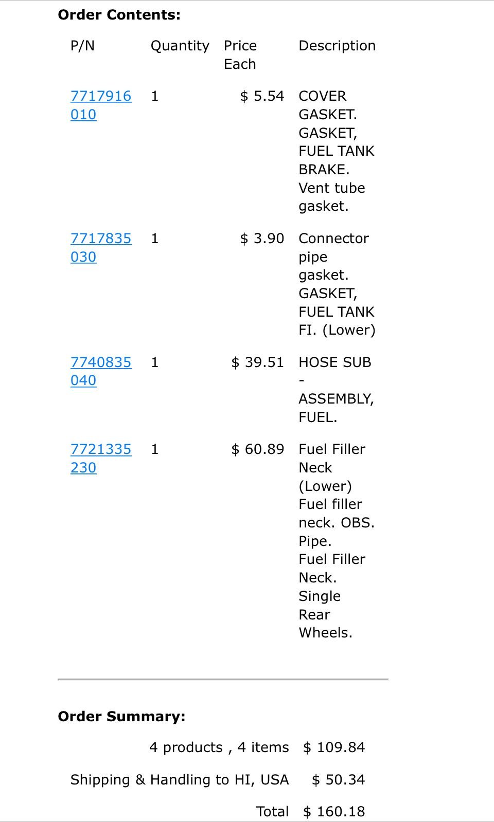

Well parts are on order. I popped the cover under wheel well yesterday when I filled up. Found the filler hose has a small pinhole just above the bendy section. Small enough to miss by eye, but big enough that quite a bit of gas comes bubbling out and down the frame. This explains the fumes I'm getting when it's sitting or more specifically when it's hot/been running, and the fumes in tank expand and come out of this pinhole instead of getting drawn up to the charcoal canister.
Not totally stoked on having to drop the tank, but hey, she needs some love and am happy to get it fixed
I went ahead and got the filler tube, vent hose, and two rubber gaskets that go between the tank and the fitting the hoses press over. I figure while down there better to put fresh rubber wherever needed. There's a shot of the parts and pricing at the bottom of this message for anyone interested
If anyone in the USA is looking for these parts for their 2nd gen 4x4 4cyl. there's two Toyota dealer's in Florida that I found them on both links below.
Lakeland FL
https://parts.lakelandtoyota.com
Venice FL
https://parts.venicetoyota.com
1994 T4R 4cyl 4x4 Gas Tank filler and vent tubes and tank gaskets.

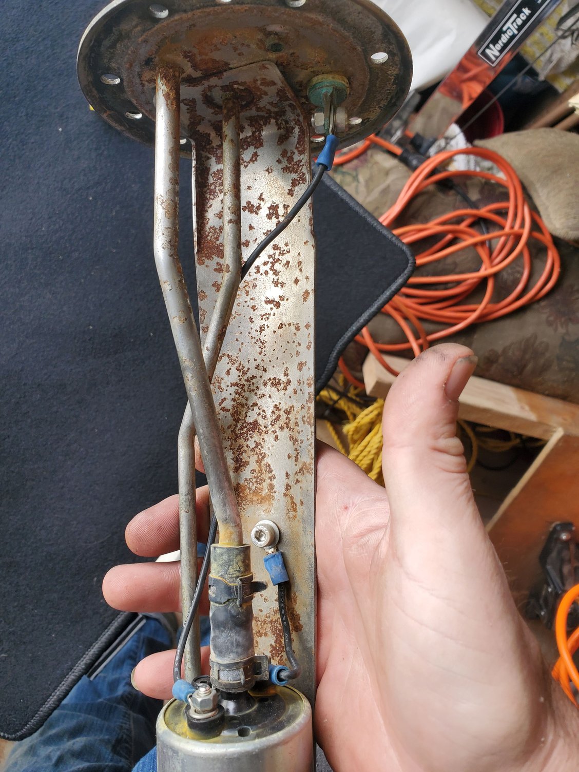

My only advice is to just drop the tank
Unless you've done so in the last 5 yrs or so, JUST DROP THE TANK. This is general advice for anyone not sure about dropping the tank.
You'd have a nice access panel in a 4runner, and you could look in there and decide if it looks bad enough to justify dropping the tank.
No such luck on the trucks. Just imagine what your sending unit, pump,, and tank look like...
I'd pull it and address any issues, then pull that hose out and bring it with in your search.
Worst case scenario is it's immaculate and all you get is piece of mind and an answer for the nest guy that sez just drop it.
This was the connector style pump after sitting in my tank for 5 yrs. O'Reilly's included the connector. The tank had to be pulled and the rust removed from sitting g so long I used Evaporust.
Drilled out the rivets and rewired. I'm currently replacing the wires with soldered ones.
