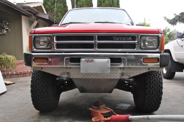

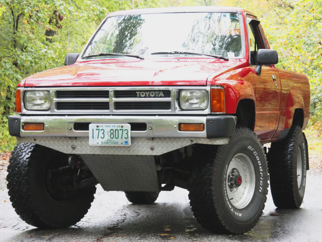

Cardboard, matte knife, aluminum diamond plate........ oh and a machine shop made the bends. I other words DIY......
That is definitely something I will be able to do. I have a good family friend that owns a shop that might be able to do the bends for me, thanks for the tip!
