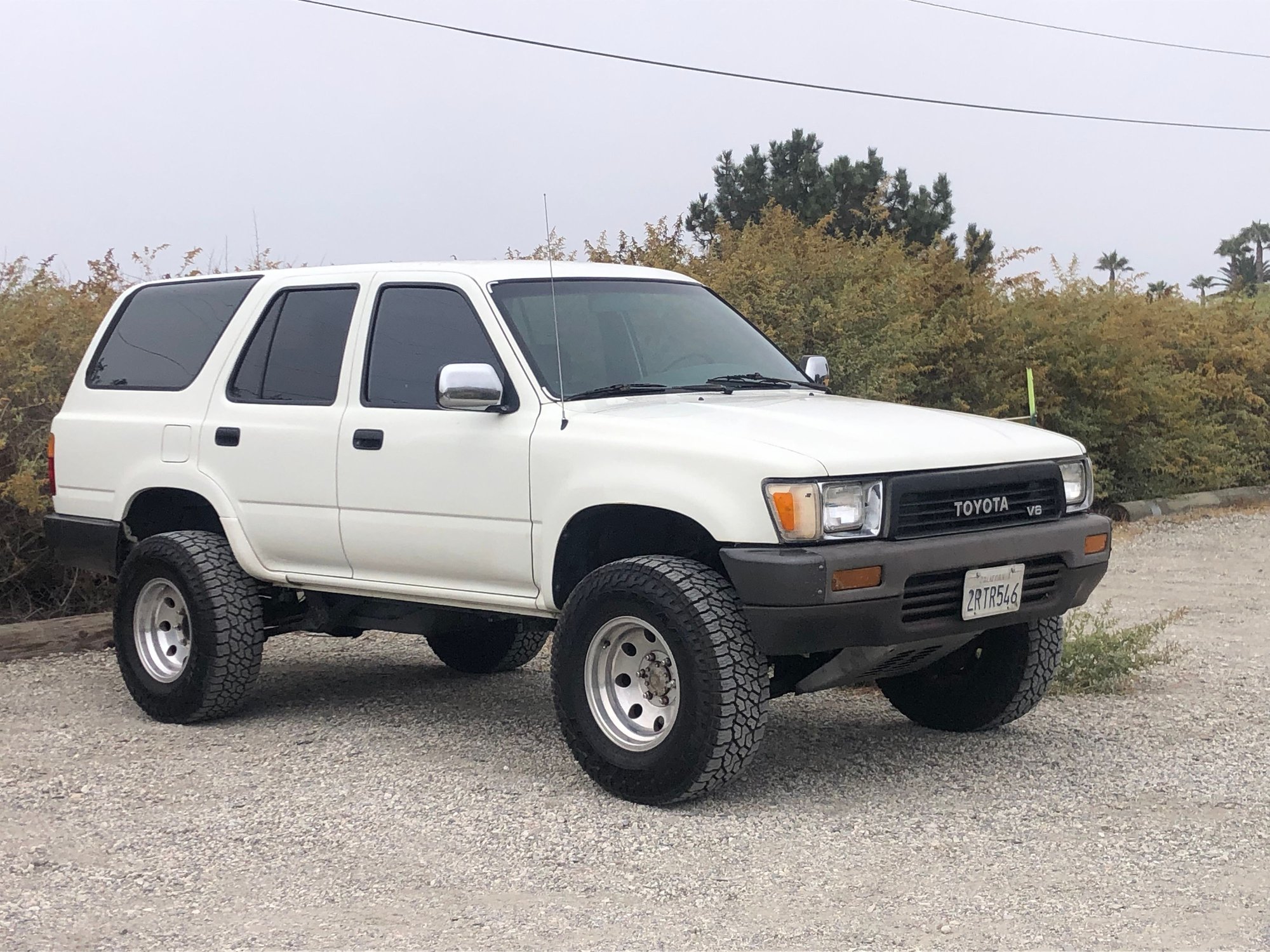

recently purchased a 90 2wd with a 2.5 inch lift
the lift uses ball joint spacers in the front and coil spacers out back … front end bounces excessively
i replaced the shocks recently with some skyjacker blackmax shocks thinking it would fix the problem
unfortunately it did not. Will the spacers cause the ride to bounce like that? I also replaced ball joints and control arm bushings
any help would be much appreciated

Thanks for responding.. anytime I hit a significant dip or bump the front end feels like it slams hard then proceeds to bob up and down for a few seconds after
so you would suggest to check the torsion bars and tighten if necessary?
