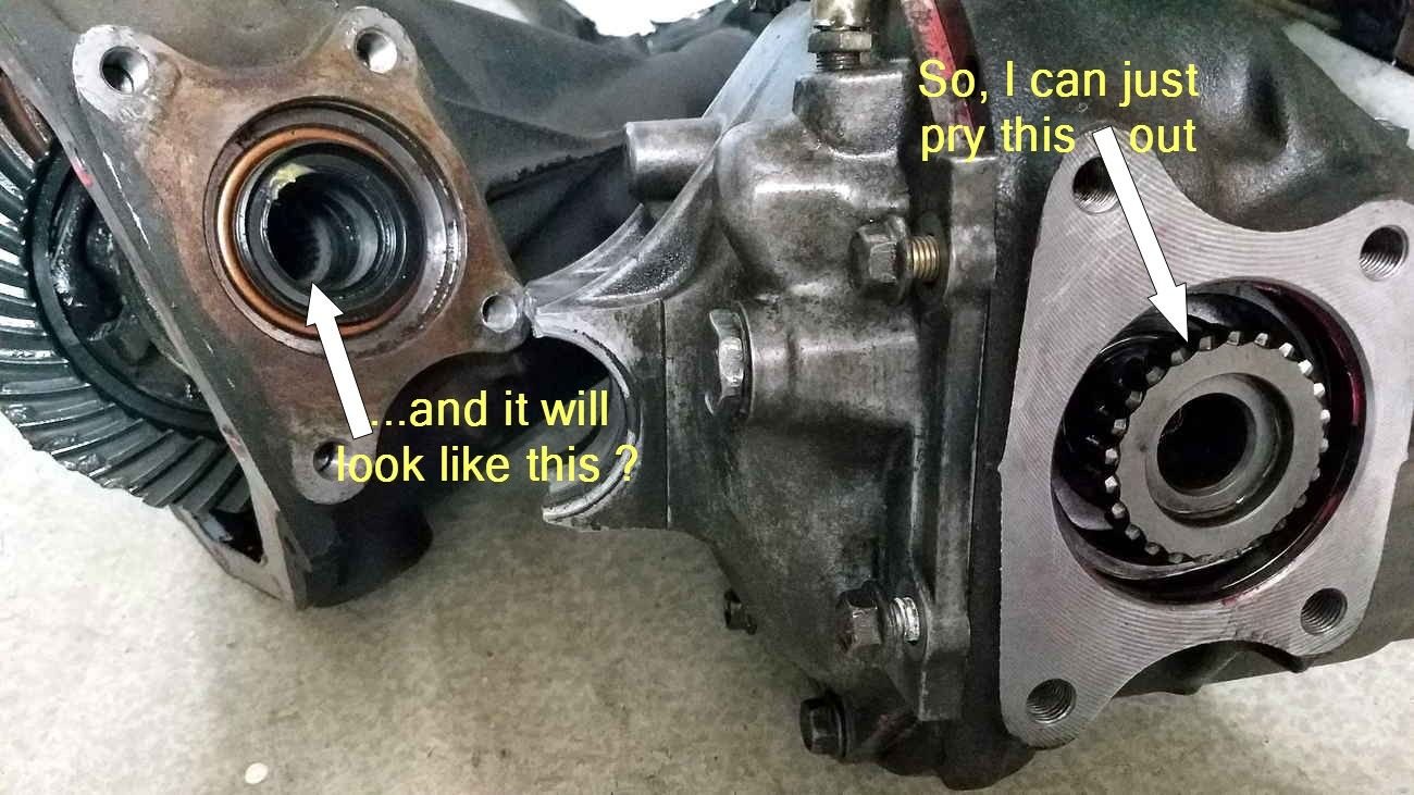

you need to pop that splined section out and get an oil seal, then it will work.
or lock the ADD diff in place and run it and you gain an extra 1/2 quart or something fluid capacity.

Mud Taco

Yes, but there will be no seal in place behind it. You must install one.
Couple large screwdrivers will pop that stub out. Don't mar the mating flange face.

Bitchin!!!
Thanks for the help fellas.
I couldn't have done this without you.
