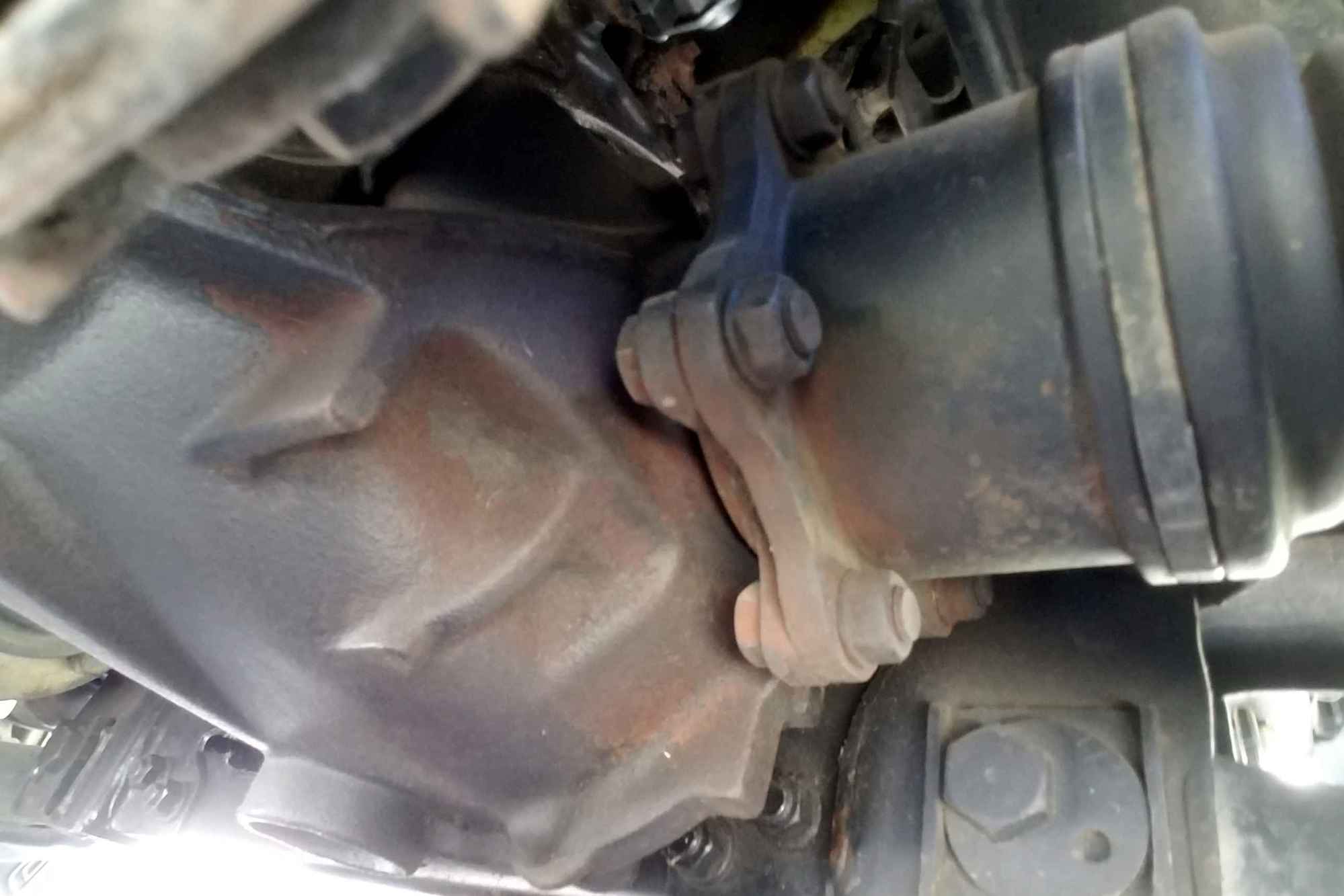

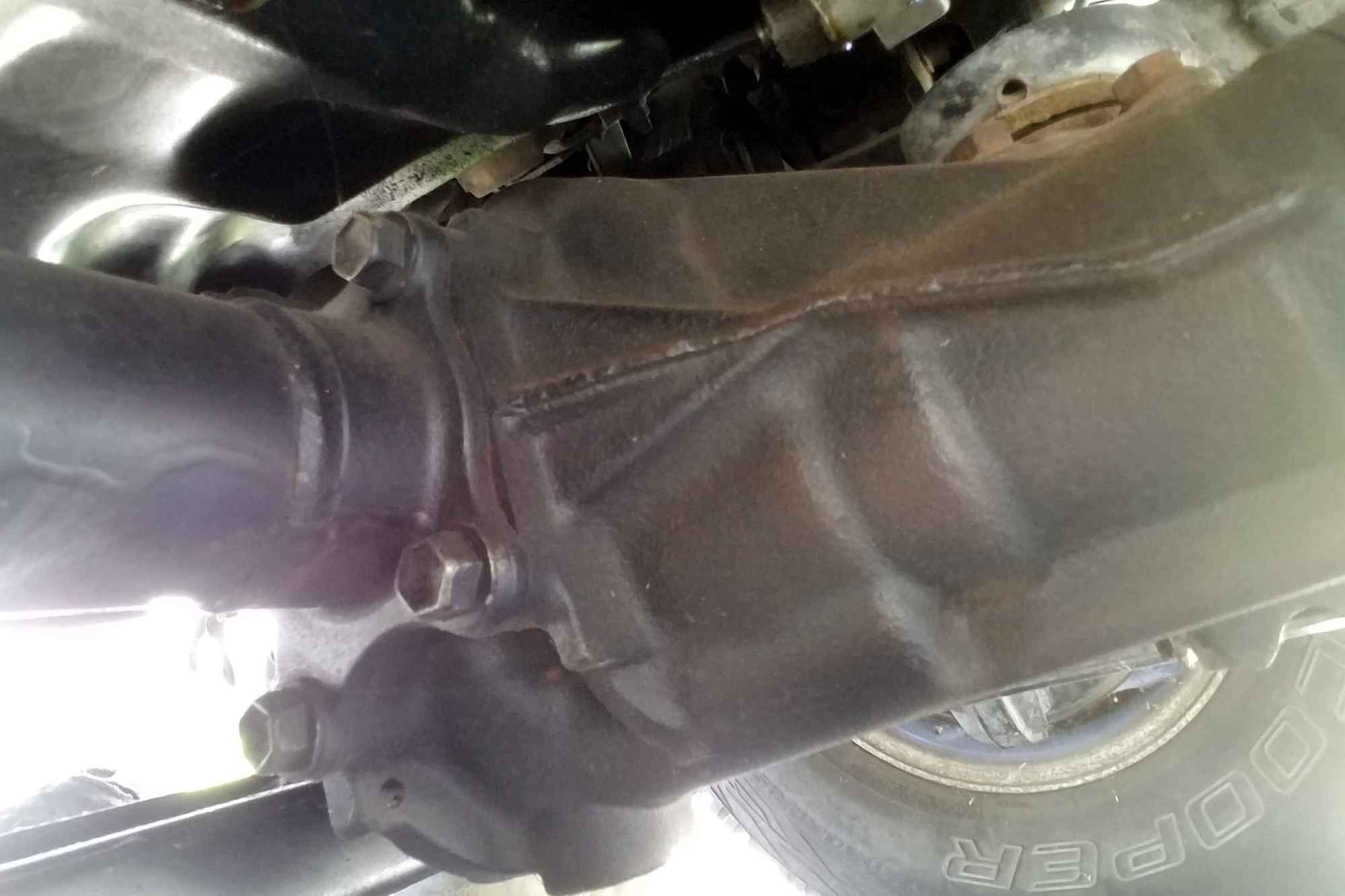

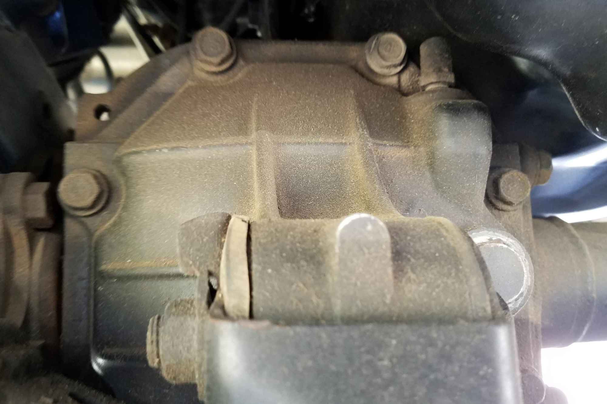

I do have a follow up question though. Since I switched to manual hubs, should I remove or cap off any of the vacuum associated with it?
I will attach the pics I took while under there today.

There should be no vacuum lines associated with the operation of your front drive. . None.
So, therefore; no lines to remove.

I can see from the images he posted that the oil pan is 3vz
As to whether or not it's 4.10 Who knows?? The ID plate would at least tell how it came from the factory.

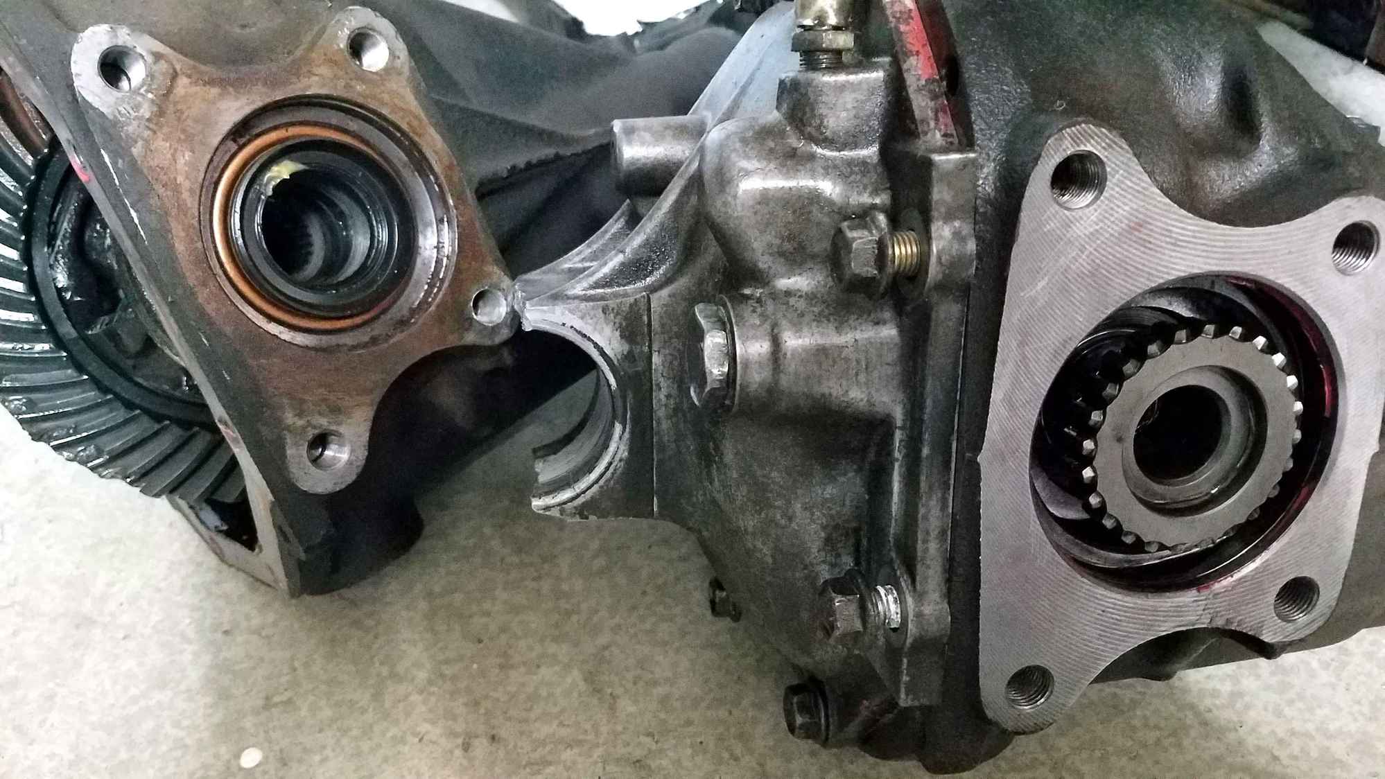

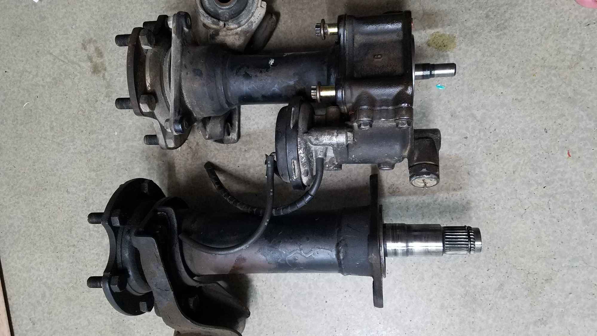

Well, I got the replacement 3rd and it's a 4.10 this time thankfully. But I have another problem. The legs are not interchangeable as I was told they would be. You can see in the pics that both the input shaft on the diff and the legs are very different.
So, my question is this. Can I just pull off the vacuum unit and bolt on a cover and use that leg instead? Or would it not engage the 4wd not having the vacuum or cause some other problem? I would very much like to find a way to get this done and use what I have if possible.
I know I could take my original 3rd with some broken teeth on the ring gear and have them use the good ring gear from the used one I just bought... But that would totally defeat the purpose of buying a used one. I don't want to pay an arm and a leg to have it rebuilt.
As a reminder, I have a 1st gen '89 that came with crappy auto hubs (that don't use vacuum) that I swapped out for Warn manual hubs.
