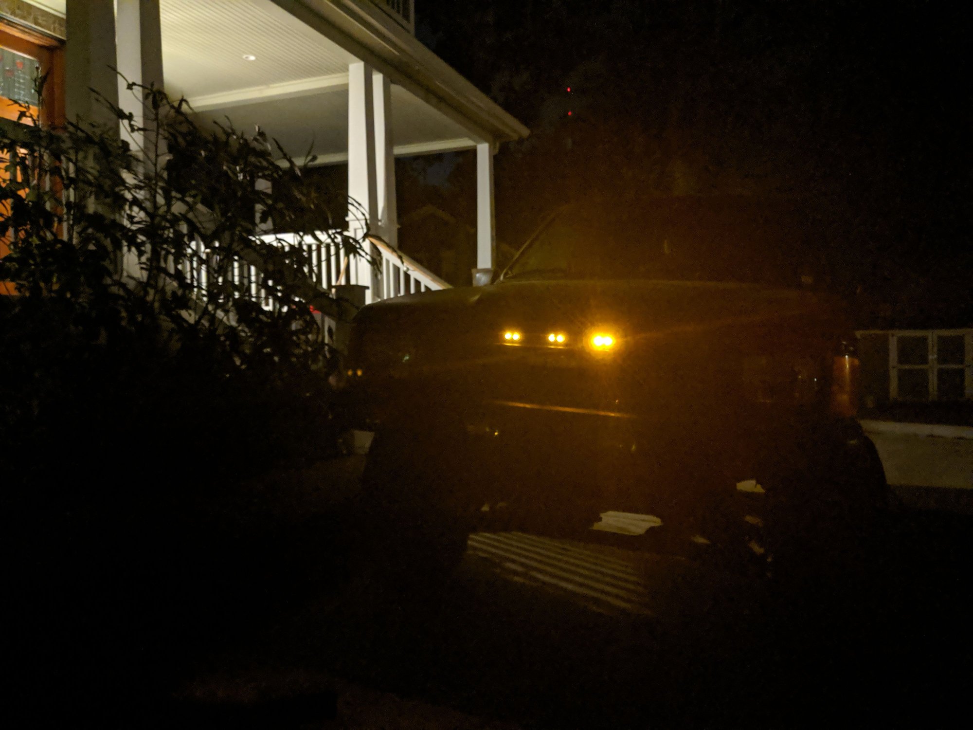

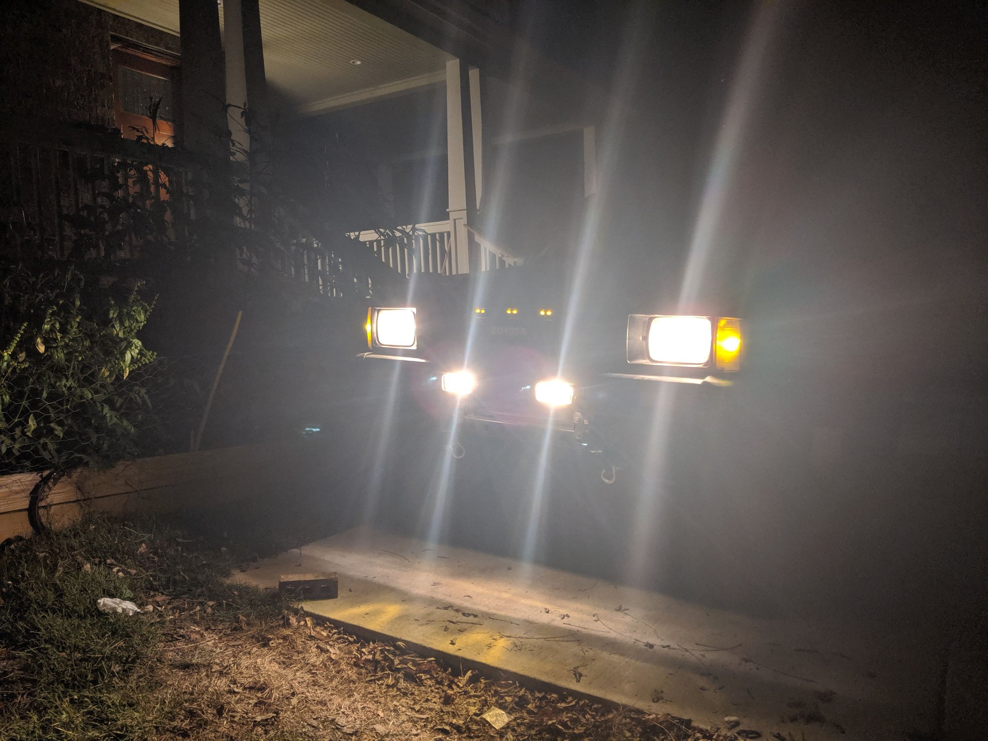

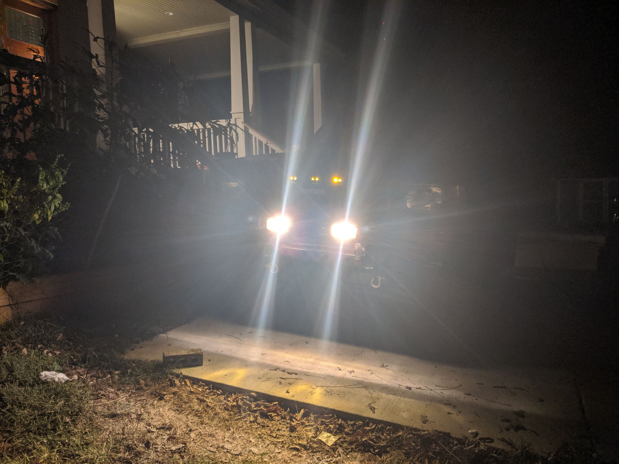

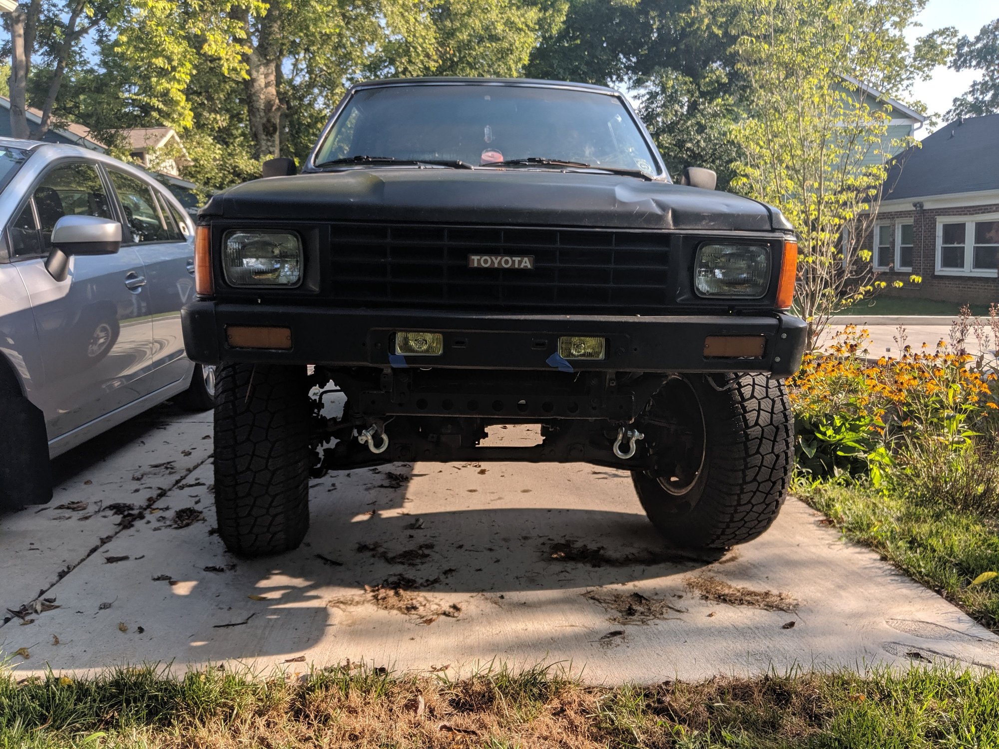

CO, this is what I did today instead of troubleshooting my oxygen sensor.
Fifteen dollar fog lights and $1.50 Amber LEDs from the asinine Wish App. I'm planning on cutting off the extra long bolts when I get ahold of an angle grinder.
Ambers only
Ambers and fogs

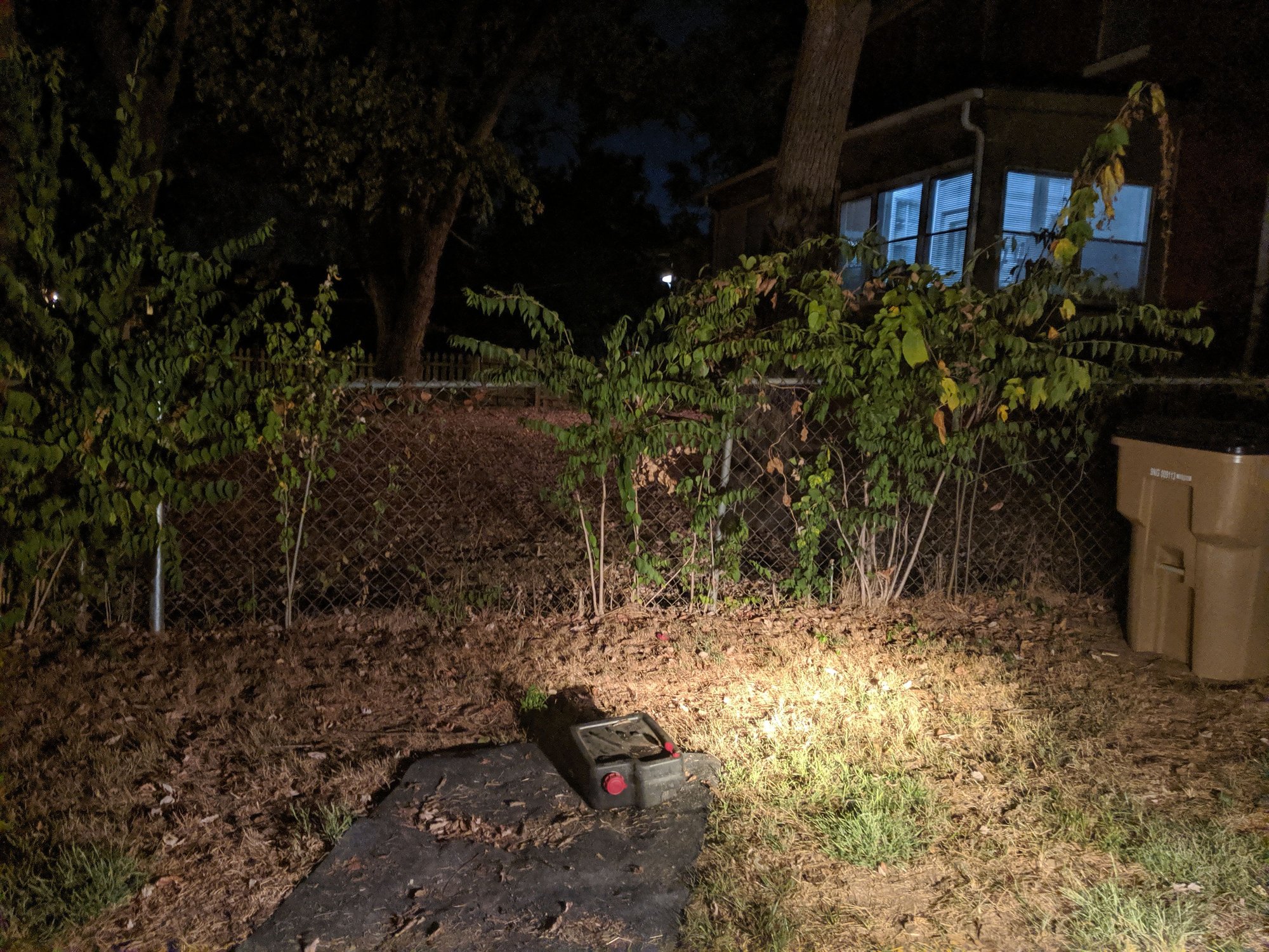

Fog light pattern
MOAR LIGHTS!!!

Would like to see the cut-off on the fog light beam, though Try shining it on aa blank, flat wall.

I'll try and remember to do that for you. I'm sure my cutoff will be awful, the lights are pointed down a bit cause I didn't measure exactly right when I drilled the hole for the carriage bolt.
At least they're not pointed up.
