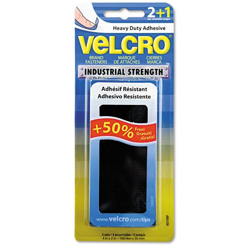

The vinyl wheel well covers on my '89 are held in place with industrial strength Velcro, original from the factory and still holding strong. Why not pick up some industrial Velcro at Home Depot? They have it in black 3" strips. I used some to mount my inclinometer since I didn't want to drill the dash pad. It's about $5 a pack.

Originally Posted by Nervo19
The vinyl wheel well covers on my '89 are held in place with industrial strength Velcro...
Velcro is very strong. The downside with the self-stick ones is that the Velcro is stronger than the adhesive when used where it gets hot. LoL!
I strongly recommend getting plain Velcro (no adhesive backing) and using good contact cement (i.e., DAP brand from Home Depot). That is less senstive to heat.
Most PSAs (Pressure sensitive adhesives) are thermo-plastic; warm them up, and the glue softens and releases. You can take the mailing labels off boxes (that you want to reuse) with a hair dryer.
But, wait! What about your toll transponder stuck to the windshield? It's always in the sun, and yet doesn't immediately fall off. 3M makes a group of "All-Weather" "fasteners" (no, Velcro is a trademarked brand name), which have a heat-resistant adhesive. So commonly used, the "ordinary" All-Weather tape is often called "toll-tape." https://www.amazon.com/8-Strips-Repl...f=pd_sbs_263_6 (that's what I use to attach various experimental readouts in my cab) 3M even makes a product that is even MORE tenacious, called (duh!) Extreme. http://www.scotchbrand.com/3M/en_US/...4603615&rt=rud I haven't used it yet, but my guess is that it will hang on long after any user-applied adhesive has given up the ghost.
