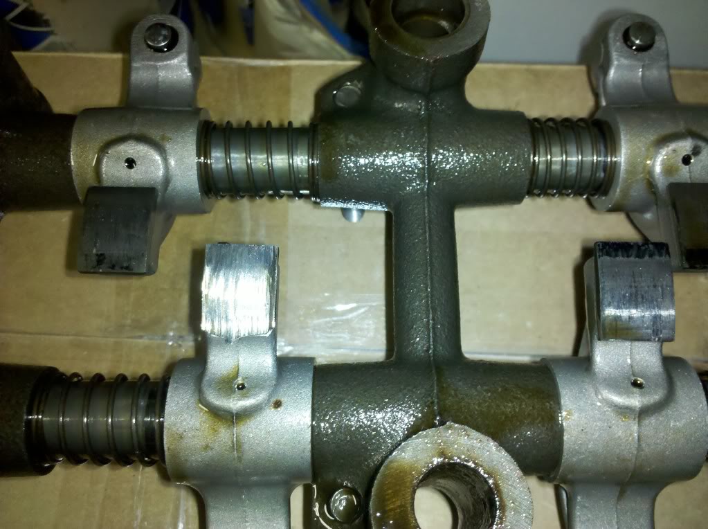

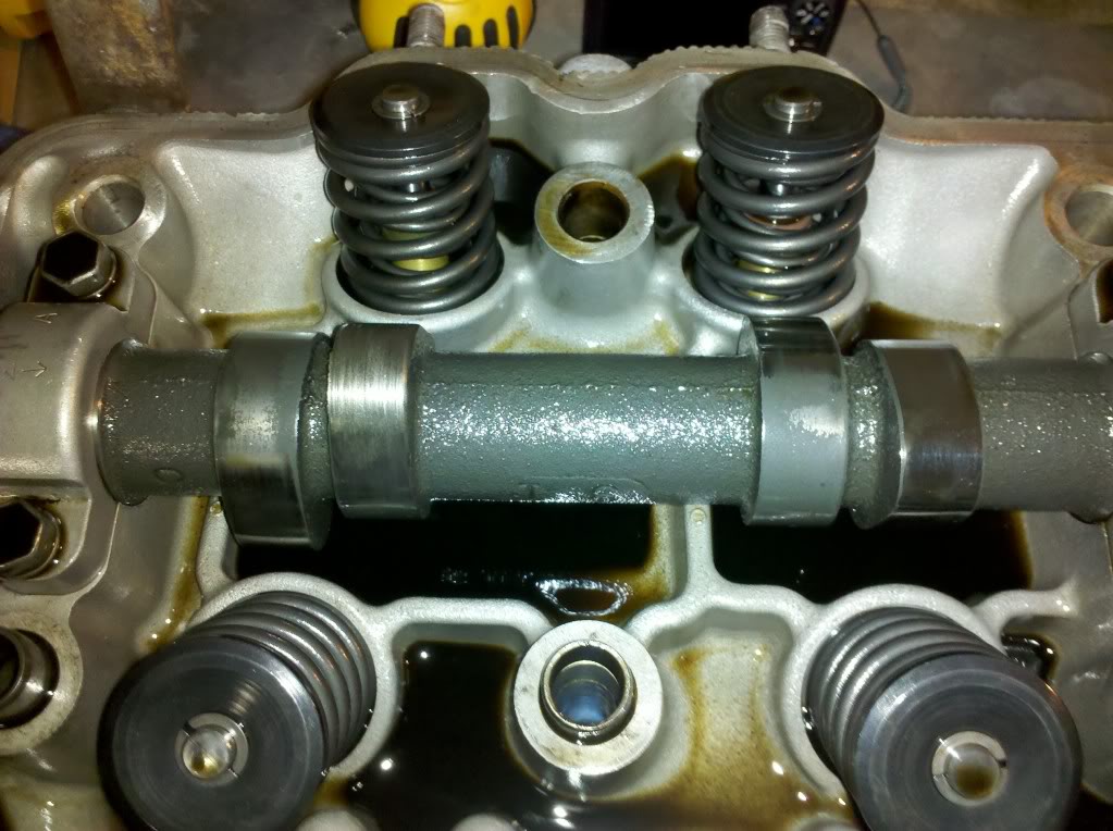

Turns out I was wrong, it was not the cam that failed, it was the after market rockers.
I did damage the cam. But not really flattened it. Shame really it was a good cam.
New head will go in with OEM rockers.

Thanks for posting the pictures.
Unfortunatly there is almost no way to know which started the failure, the cam or the rockers.
I hope whatever you choose to put back into your engine works well and lasts for many many miles.

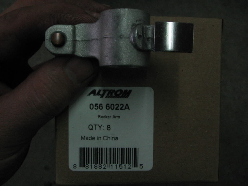

Just a little note, Many engine rebuild shops order parts from Altrom. It is a very large wholesale only distributor that imports a lot of parts directly from Japan. Also many online companies like 22RE.COM carry the full line of Altrom parts. IF you look on their website you will see "Altrom" on many boxes in the pictures.
I took some time this week to order some parts. I also will have some Factory "Toyota" rockers, shafts, and adjuster screws for comparison on Monday.
Just some comparison tech photos here. I will take pictures of the "Toyota" parts to see if they are the same.

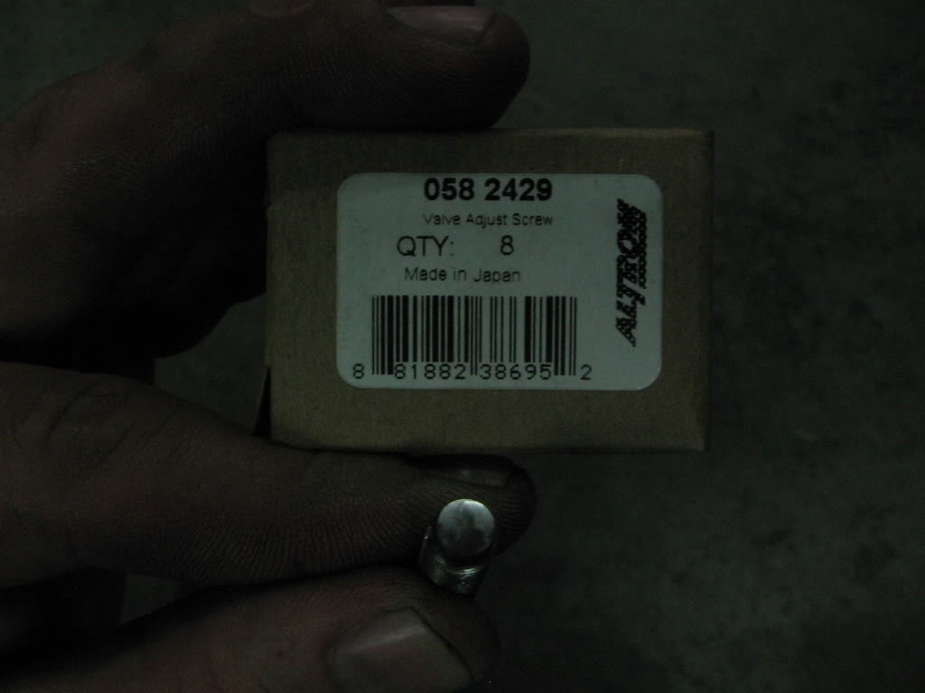

Ok first picture is of Altroms Adjuster screws. These LOOK exactly like oem, same length, same color, same polished bright tip. The box says made in Japan. They are 1.07 Each my cost

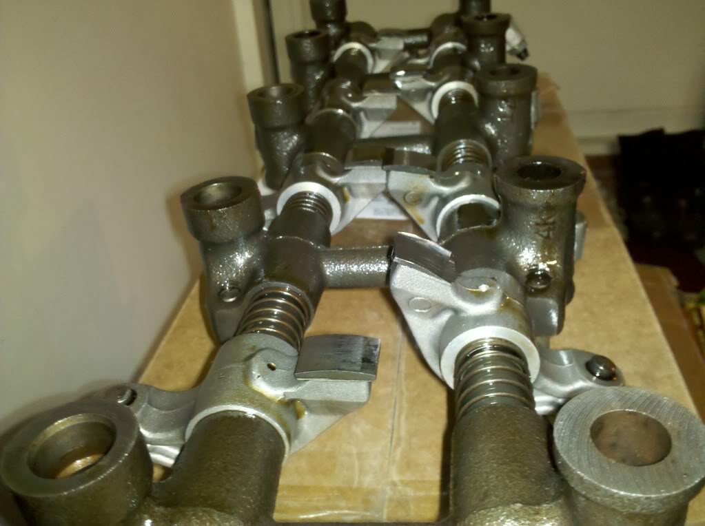

Second picture is of the Altrom Rocker Arms. These look nothing like OEM. I would love if anyone recognizes them of the type that fail? The Rocker Pad looks a lot like the ones that were mangled in TinMans post. Large rectangle face with sharp corners. These are 3.49 Each my cost.
*** note the "bronze" color of the adjuster screw, even the shaft has that bronze color. They are slightly shorter than the "oem" ones and have a smaller neck where you adjust them with a flat head screwdriver. They also have "black" colored nuts. I also noticed that they had a small "BB" sized round casting on the side of the rocker in the middle.

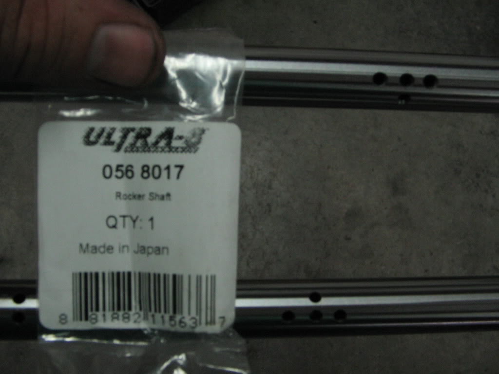

Third picture is of Altroms Shaft. This Says made in Japan, but doesn't look like the old oem ones. It will be interesting on monday to actually look at a new "Toyota" shaft. Maybe they made some changes? These are 23.91 Each my cost.
***** instead of a oil line, these have three seperate holes drilled

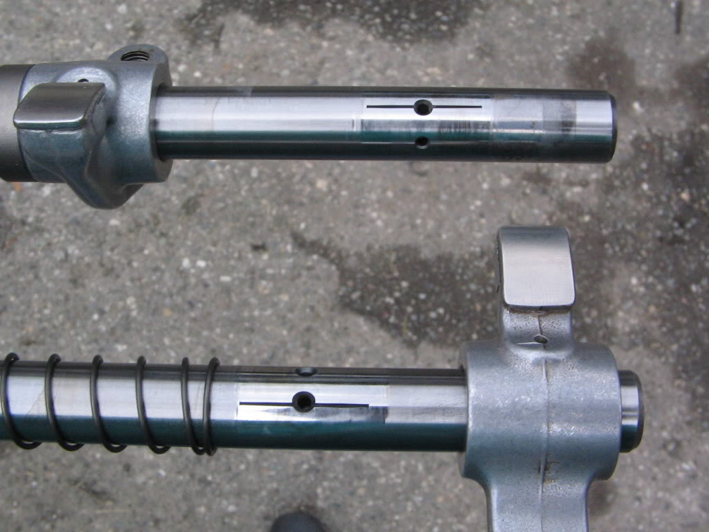

And finally a picture of an original Factory Toyota rocker shaft. Notice the single oil hole, and a groove cut. This is how the rockers get oiled.
