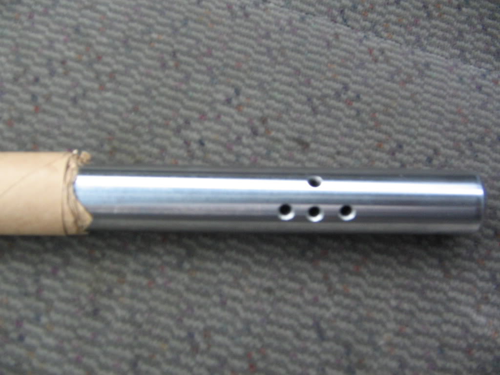

It took me a while to get to Toyota and pick up my Rocker Arm Shaft.
To my suprise they are "updated" A new shaft from TOYOTA doesn't have the oil groove, instead it has 3 holes drilled into it.
SO
ALTROM Shaft = Toyota Shaft. Both say Made in Japan and as far as I can tell are exactly the same. So Altrom must buy from the original manufacturer.
ALTROM Adjusting Screws = Toyota adjusting screws. Both say made in Japan, and look identical. With a swirl polish to the tip. Again Altrom must buy these direct from the original manufacturer.
I can't find ANY new Rocker Arms through anyone but Toyota that are oem.

what in the..... if I knew that I woulda gotten a set during my rebuild grrrr..... how much those things cost you?

the different shafts are consistent with looking at toyotapartszone:
SHAFT SUB-ASSY, VALVE ROCKER, NO.1
13911-38011 Replaced by: 13911-35010
SHAFT SUB-ASSY, VALVE ROCKER, NO.2
13912-38011 Replaced by: 13912-35010
also looks as if they updated these too:
SUPPORT, VALVE ROCKER, NO.1
13951-38012 Replaced by: 13951-35010
SCREW OR BOLT(FOR VALVE ROCKER SHAFT LOCK)
93210-16008 Replaced by: 93210-56008
but no change in SUPPORT, VALVE ROCKER, NO.2, NO.3 or NO.4 though. hmmmm wonder why that is ???? related to the change in rocker shaft oiling maybe? Which almost leads me to believe to you have to use the updated SUPPORT, VALVE ROCKER, NO.1 and SCREW OR BOLT(FOR VALVE ROCKER SHAFT LOCK) in order to use the newer shafts? That question I am sure would stump the parts counter. lol.
no changes in the rocker arms, adjusters/nuts, camshaft, rockers arm compression springs or valve springs themselves.
Rocker Arm Shafts
Altrom through Napa .... 23.91 (on my account)
Toyota ........... 67.52 (on my account)
HUGE difference in price.
