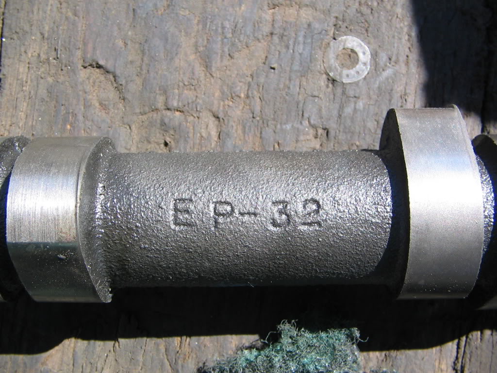

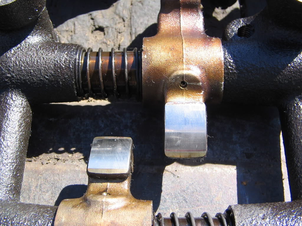

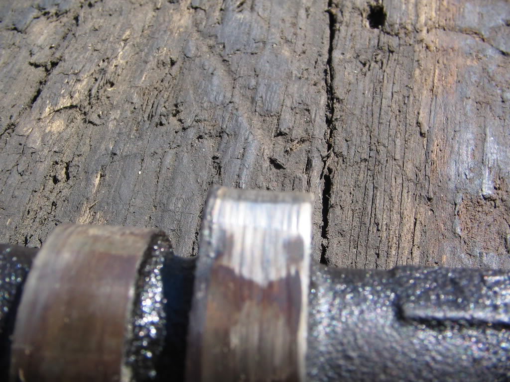

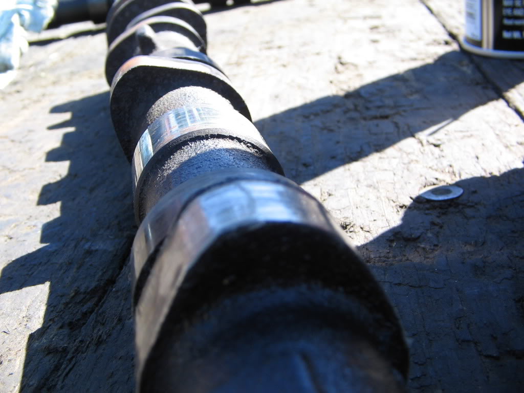

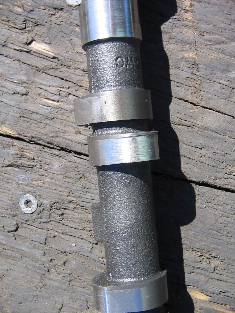

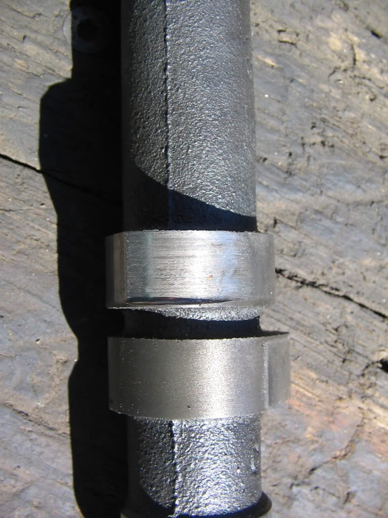

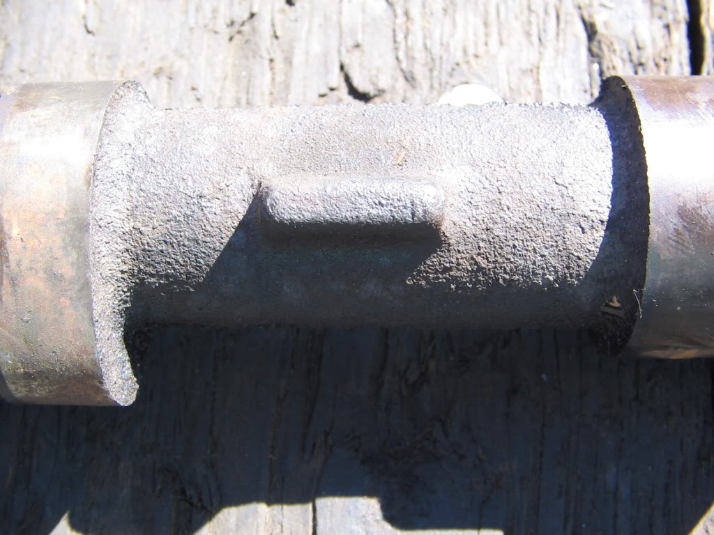

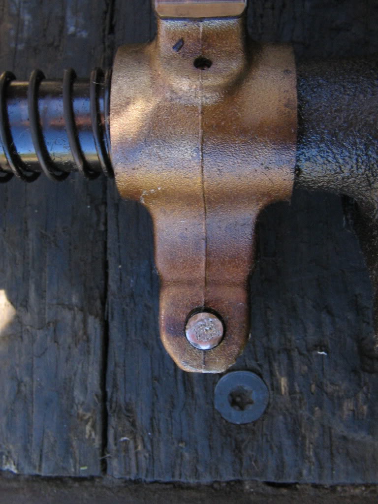

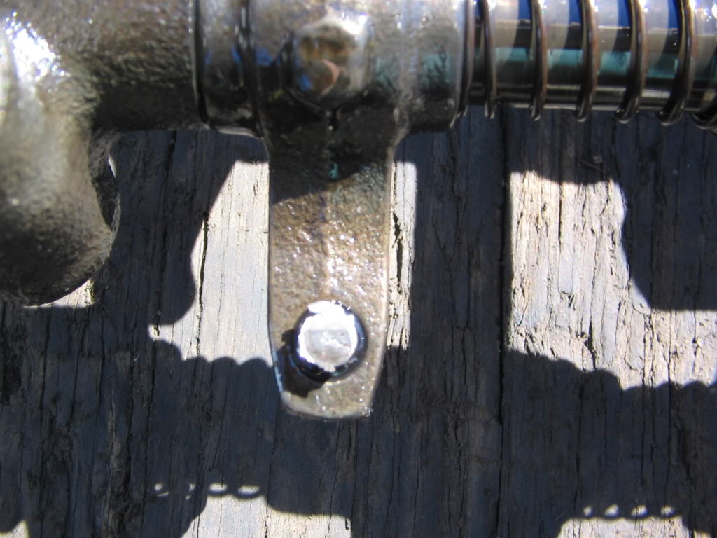

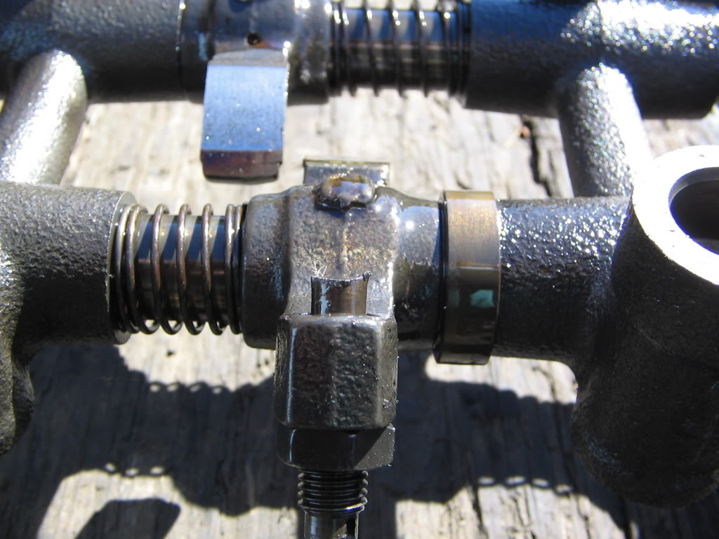

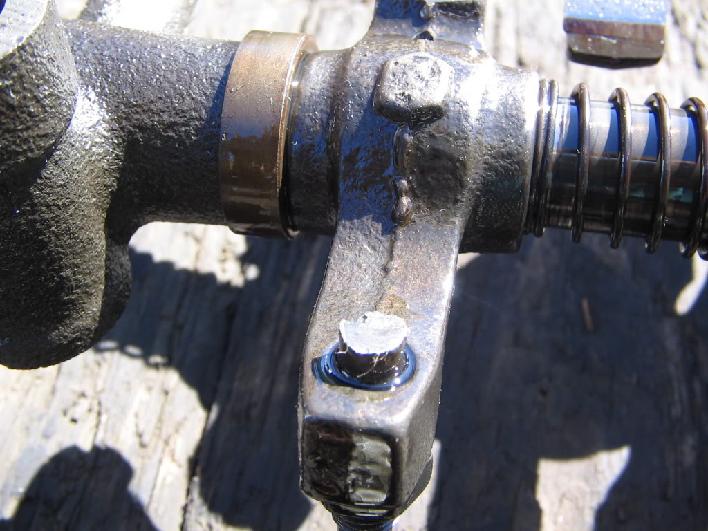

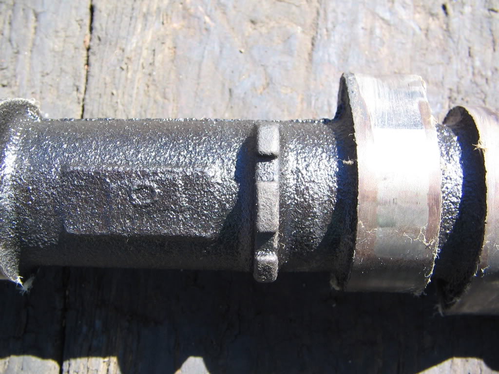

Bad cams and rockers

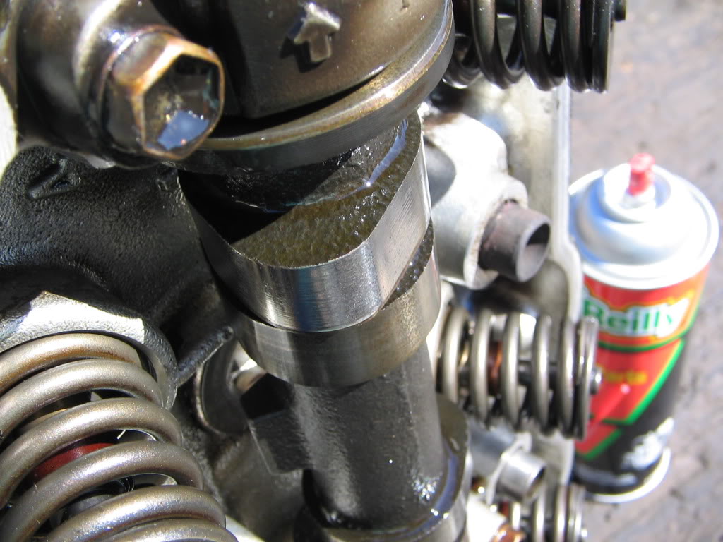

I tore down another core back from a customer and yup here's another one. So It was a nice day and I had a couple extra minutes. Here is some serious glory. I also dug around in the shop and found some other stuff to take pictures of.
The cam in the head is a Factory cam. A small lip can be seen. The rocker doesn't cover all of the cam on a 22R/22RE engine, so it's very easy to guage wear do to that little lip.
The first cam is a Aftermarket with serious damage on two lobes and much less damage on a few others.
The second cam is Factory, cam with moderate wear. Two lobes had damage.
Note the 2 notches and also how the little bar is smaller and more round on a factory cam. The aftermarket one also is stamped. EP-32 I have seen that number on a lot of them. Not all aftermarket cams will have that exact mark.
Also there are a few styles of Factory cams. Some are kinda hard to tell that they are factory. 2 notches on a little cast ridge towards the rear of the cam is a good indicator or newer 85+ cams. Early 81+ cams are slightly different looking.
Rocker arms: Note the nice polished shiny faces. Those are GOOD, look at how pitted the tips are, BAD !!

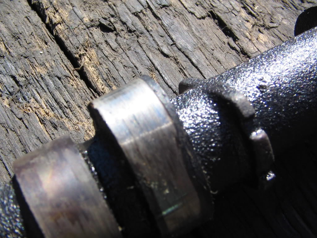

Next ones are Factory
Now Rocker arms and Tips

imo if you want a real good chance of an aftermarket cam holding up u need new rockers. I dont know alot about over head cam motors but with a pushrod motor you must put all the lifters back where they came from or replace them if installing new cam because they develop wear patterns i dont see how this would be a whole lot different. I dont think theres any practical way of checking this and you deffinatly cannot tell just from looking at them. also i dont know y you wouldnt coat all the lobes heavily with assembly lube before firing it up and running a half hour break in before puting a load on it. I really doubt the cams are causing the problems.
So why do factory Cams hold up to being mixed and unmatched in hundreds of engines with used good condtion rocker arm assemblies?
A person would think if there was a problem, it would happen all the time not almost exclusivly with aftermarket cams. Am I missing something?
I now have a used messed up aftermarket cam. It will be headed out for some testing very soon.

holy cow, I got a chance to look at those photos, after tearing apart my motor at 170,000 miles my factory cam and adjusters looked nothing like either of those. no groove wore into the cam at all and the tips only showed an hourglass shape as far as wear went.
How many miles were on those cams and adjusters?

Chuckle, you're dreamin if you think ANYTHING let alone a 40 dollar aftermarket cam is made in America.
They come from China
Pretty much all of them had around 10,000 miles on them.
Thank God they weren't my motors. These are just cores coming back to me. With the bad economy instead of buying a new car a lot of people fixed their motor, or purchased crappy rebuilt motors about a year ago. It's all starting to come home to roost. I feel sorry for a lot of these people they simply had no idea. That's part of the reason I'm here and other places trying to educate people. I feel horrible for them.

but your saying the aftermarket ones are the ones that are failiang over the oem ones. so let me rephrase that.
could it be due to Japanese steel versus say Chinese steel?

I would guess, if they cant care enough to make sure baby formula is up to snuff, I doubt their metal is always consistantly high quality.
There are two things that make a cam what it is.
1: base metal
2: How it's hardened.
There are multiple ways to harden steel. Some are better than others, some cost more than others. From what I "hear" the better way to harden steel also costs more. So ask yourself is the 50 dollar cam or the 400 dollar factory cam going to have the more expensive process?
Im not making judgement, just asking some questions that seem to make sence to me.

By the look of those adjusters someone doesn't know what .010 is.
THEY TICK, JUST DRIVE IT.....................

Actually when a cam goes flat, there is a massive gap between the rocker pad and the lobe. That small surface area then takes some serious shock load as what's left of the cam lobe bangs the valve open.

Quite a discussion, but here is my view. So far we have not found an aftermarket rocker arm we will supply, and we have tried nearly all of them. Even the Topline brand let us down badly, the only Topline part we won't supply with confidence..
Different metalurgy in both the arms and the follower pad than Toyota specs, we tried and had problems, like the entire pad coming loose when the aluminum rocker arm expanded the first time the engine got a bit too hot.
Now we reface them and put them back in service, reports of concerns are close to none at all. Often we find them in good shape and bolt them right back on without a single worry.
On the adjuster screws, Durabond was supplying us, those were far too hard and were breaking. We dumped that brand also and tried another, same problem. Now we buy Toyota only when we need some. We actually tried to buy from their supplier but they wouldn't sell to us. One of Toyota's 400% markup items I think.
Now on Camshafts. It isn't the heat treatment, CMC used to do that, and some Federal blanks we recieved. There is a pic up above of an EP32 camshaft, that CMC logo is a mirror image of the factory's logo. USA made stuff.
Normally a very good part, too. It is the quality of the iron alloy itself, if too hard it begins to break up, that cuts them quickly. Rarely is it from being too soft but it can happen. (Think here how soft bearing material is, that will explain it) Normally there is almost no metal to metal contact at all between the rocker pad and the cam lobe, but get some material in there and it's just like sandpaper. Loading and unloading can break off microscopic chips that chop a lobe up very fast.
Cast iron is the same rockwell at the core as it is on the outside. Properly prepped, they have a Parkerized process covering them, that actually becomes part of the underlying metal. That is what makes them black.
Camshafts with the shiny looking lobes are not Parkerized, we see a much higher ratio of lobe failures with those. There are a few suppliers of new blanks that we won't buy, also.
Then oil companies dropping Zinc didn't help. Not as tough on the slide follower type of cams as lifter designs that must rotate, but still more critical to avoid early damage. Good grease works fine on the 22RE cams, though. I used it for yers, I actually don't remember ever losing one I did myself. I wish I could say the same for Chevies and the small base circle Mopar engines, though. They gave us fits until we figured out that we needed to use breakin springs. Now that worked.
Toyota doesn't need them, they only have 60# seat tension....*EB
