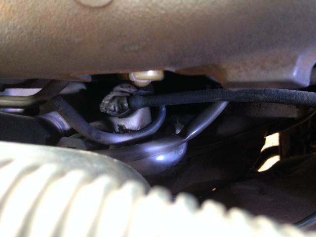

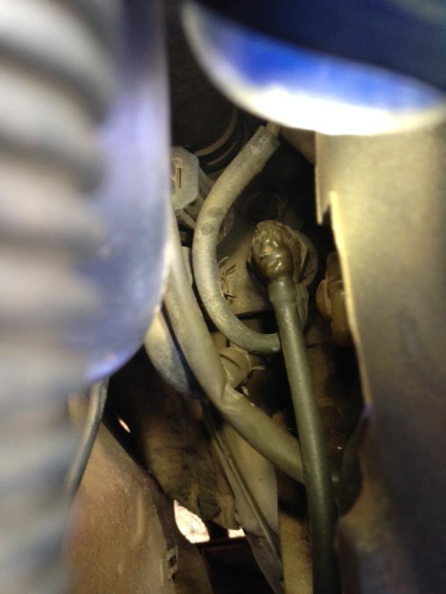

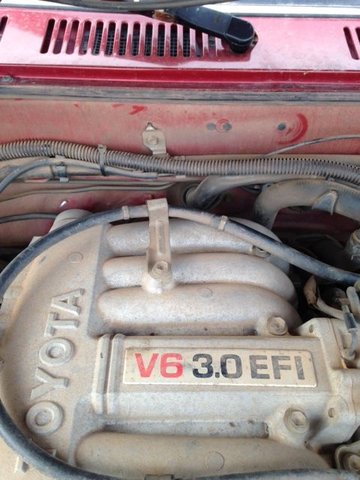

Okay, but... my recent understanding is that the sometime venting heard from unscrewing the gas cap is actually air being sucked in, with the tank under normal conditions being in a vacuum state (negative pressure) or neutral state. This episode was serious out-venting, like totally unscrewing a tire valve from a truck tire under pressure and add in heat and fumes pouring out. As I unscrewed all the way and pulled the cap away, I could see gas actually flitting up from the hole underneath. NEVER had that before. It was about 80 degrees, and the tank was 2/3 full of 85 octane with 10% ethanol which is why I stopped to gas up with 91 octane since the vehicle seemed to be worse with the lower octane. (I know, I should have spent the extra 40 cents per gal and put in 87- this in Colorado! I'm used to $1.80 for 87 octane in New Mexico not $2.49 for 85 octane). At first I thought maybe the high ethanol was causing more pressure. I read that there are three check valves in the canister, activated by engine vacuum. I have two lines in the top and the third going down somewhere under the engine- this is the overflow? Would a saturated canister at some point return to vapor and purge? I haven't blown low pressure air in yet to see if all three are clear (but doesn't a check valve go only one way? seems to contradict what the book says...) Now that I took pics, I can see that there are two fittings for hoses and a screw-in below. so this must be the purge. The top looks melted.
Really hard to see down there with both eyes as there is little room.
middle of engine, looking straight down between firewall and engine
