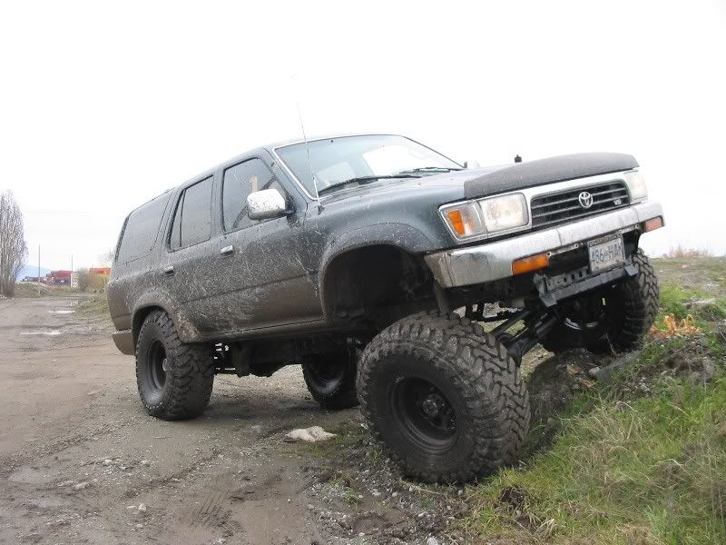

here's a couple pics of my truck if you'd like to see it....
