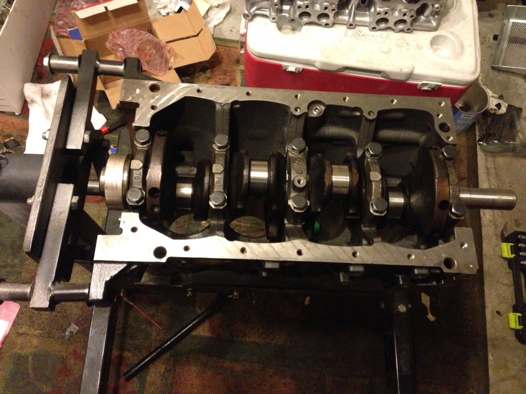

On the bottom of the block underneath the oil pan there is a plug that needs to be in the block. It is an allen/hex head plug. Without that there, it WILL not build pressure. My buddy (kornhuskerwizard) told me he had troubles with not building oil pressure and tore the block back down only to find the plug was not there. There is also another one behind the timing cover.
Sometimes these things can get removed during machining and forgot about. I hope this helps.

^ x2 on the plug. It is located on the passenger side of the block near the #3 crank journal. Just drop the oil pan and you should see it (or not see it)

Here's a picture of it for you. You can see it just northeast of the middle bearing cap.

yes i have checked for them.i checked the lower one when i had the pan off when i replaced the oil pickup tube. and checked for the one under the timing chain cover when i replaced it after noticing score marks where the oil pump was rideing. and yes it is a new oil pump as well.. they were installed.... at least im pretty damn sure.
