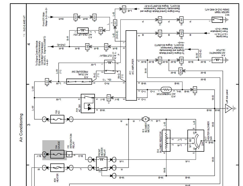

Check out this diagram from 95...yours maybe a little different.
It seems the fuse comes before anything else that has to do with AC...even the switch.
I'd check the switch to see if there's a short first. You might be able to just pop it out.
