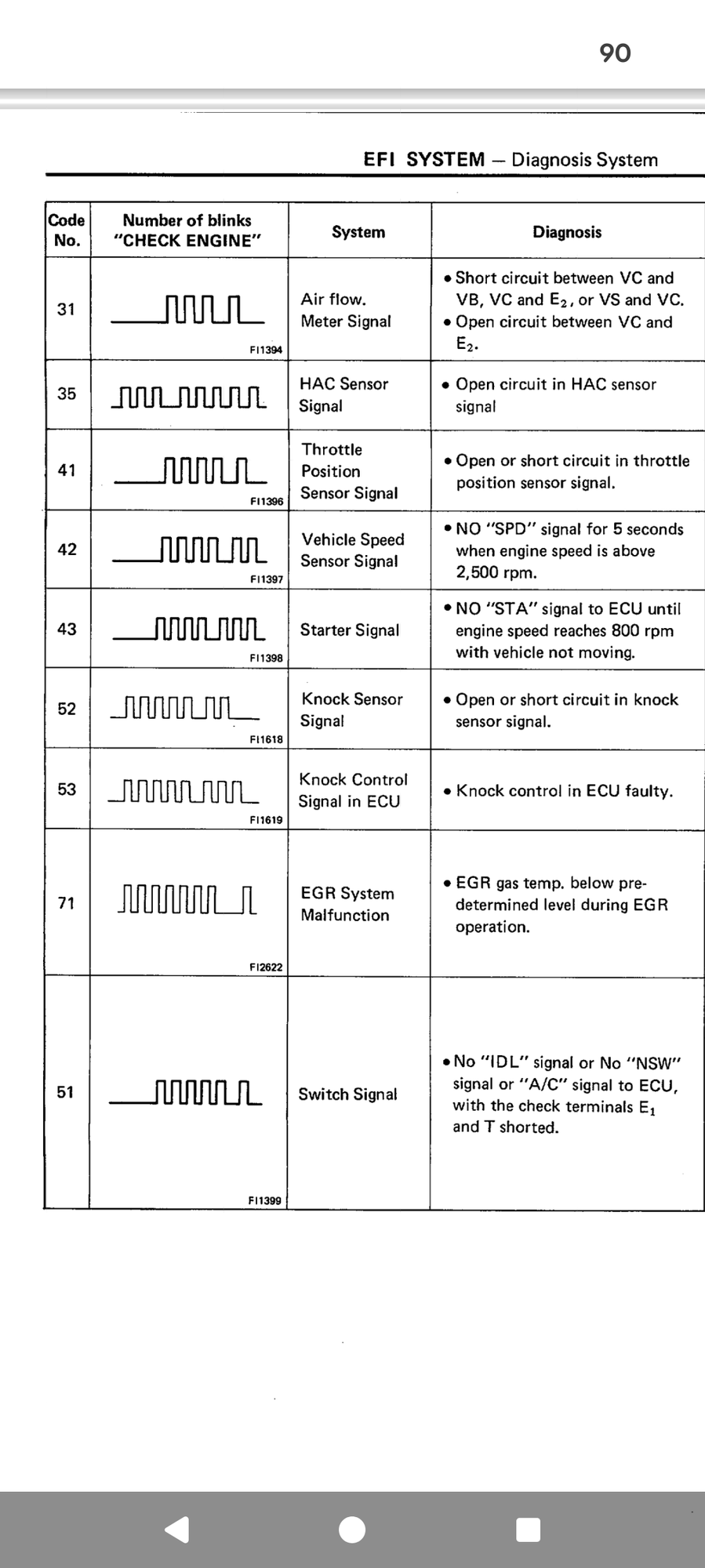

This is what my service manual shows: (no code for 3 flashes or 12 flashes)

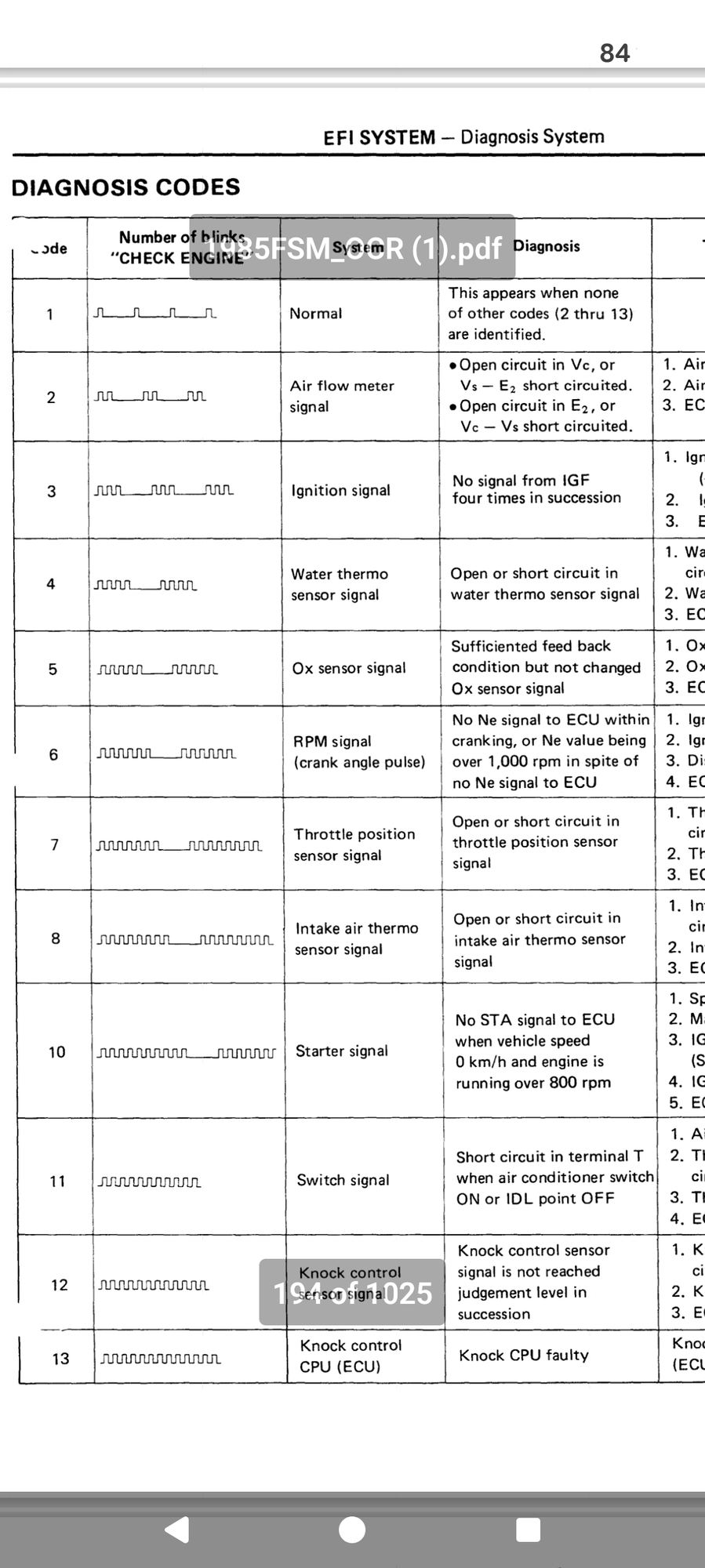

After doing some more research I came up with this, it's from an 85 service manual. This points to the 3 flashes being ignition related and the 12 flashes pointing towards the knock sensor. I'll have to inspect further. I do have another used distributor laying around. Think I'll swap it out and see if anything changes.

Interesting, thats a good find. The one I had downloaded was an 88 3vze manual. It did have the graph for 22re codes too but you never know if things were different year to year.
Knock sensor going out isn't super common but if its the original high mileage 40+ year old one it can totally age out and die. I had knock problems on my 3.0 once and it would absolutely cut ignition so you could be on the right track.

Great news! Got it fixed. Turns out the wire had come off the knock sensor, easy fix. Then the ignition signal ended up being a bad connection at the plug right before the distributor. Fixed that and no codes now. Drove it a mile or so and all is well.
More research revealed that 87 and prior use a single digit code presentation ( total number of flashes). Post 87 uses the two digit presentation (flashes for each digit place). Never knew that, learn something every day!
